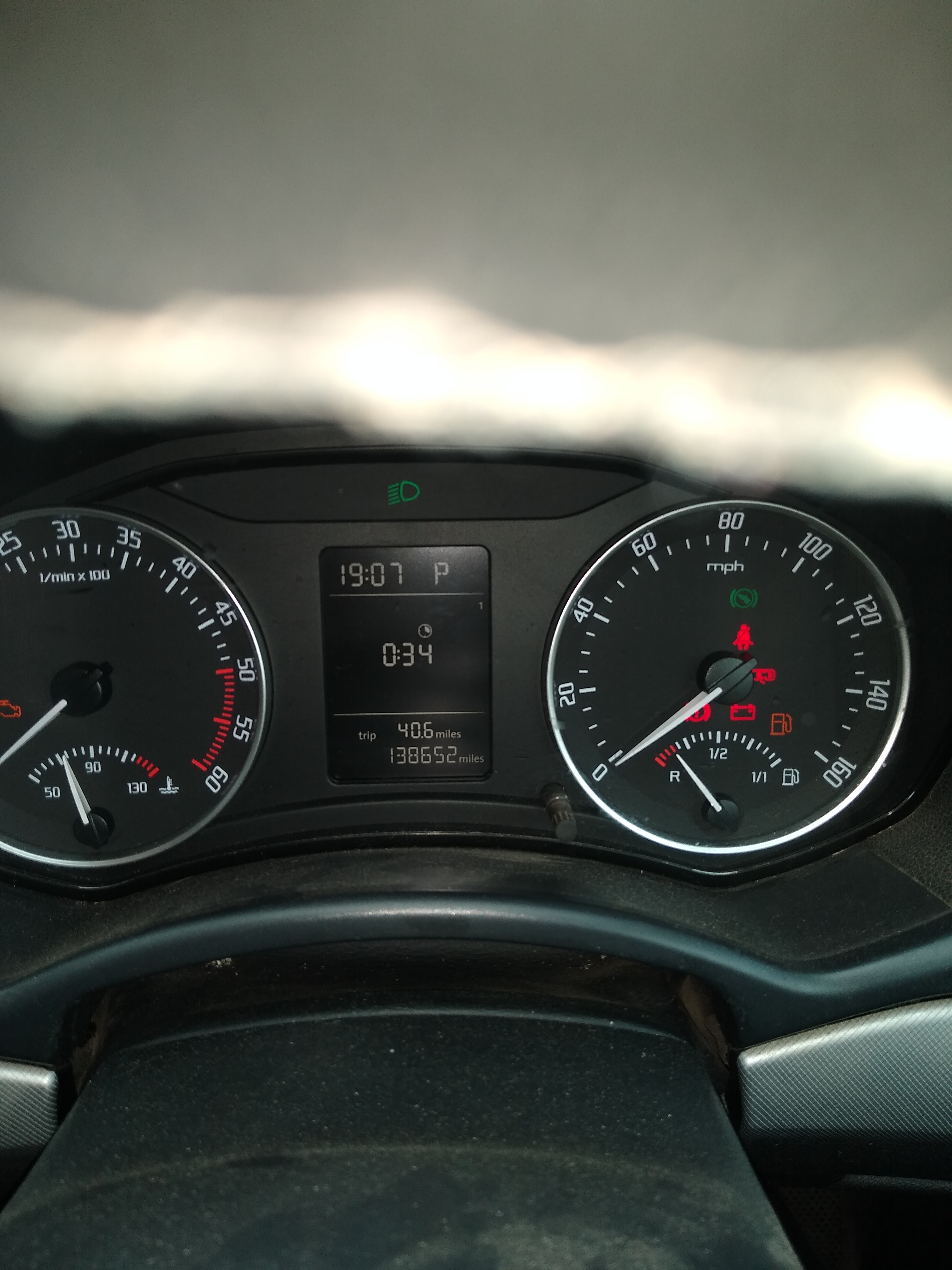

  8. So, as I suspected my local indy does not touch DSG transmission work, but gave the contact details for a local bloke who does. And added, "allow about £2,500.00 for a repair"(I have not managed to speak to the bloke yet) Which means the car is beyond economic repair, being only worth £1,500.00 per "we buy any car", never mind the doubts re the longivity of the 1.6TDI engine. signed, Disgusted of Dervock

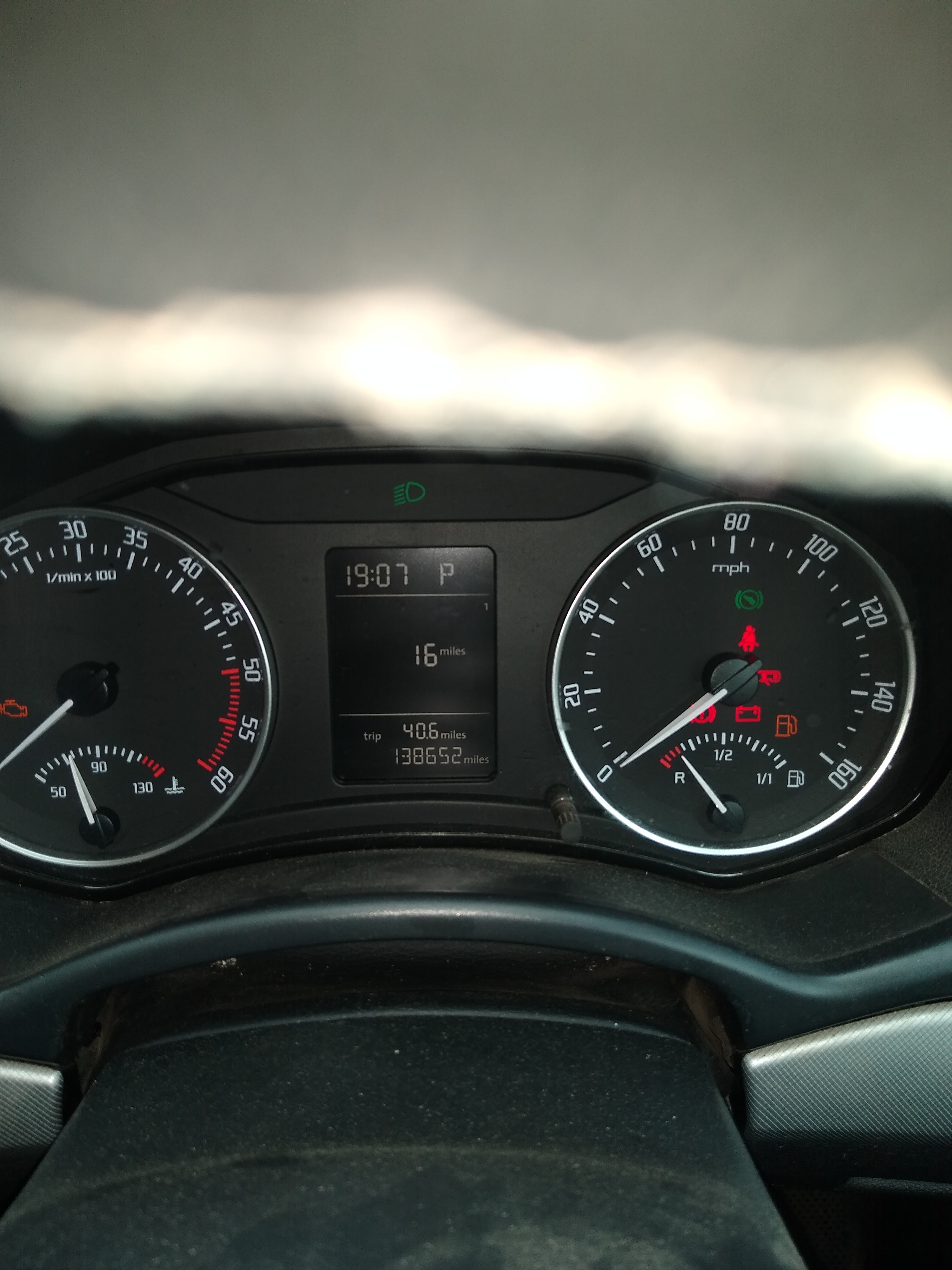

  10. Happened tonight, when I left to ret home, after being sitting parked in Portrush. Guessing the clutch pack(s) are goosed? I had to get the mechatronic done about 3 year ago. I will be contacting my local VAG indy am tomorrow, but whether he touches DSG's other than routine oil changes, I dont know. Marcus
