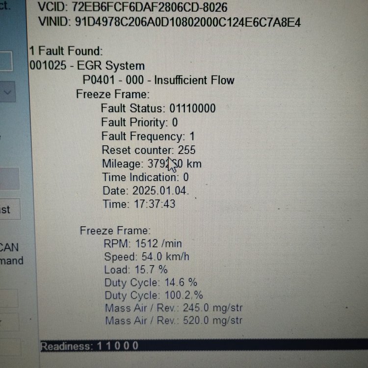

001025 EGR code, insufficient flow
Cheers mate appreciate your help, so the lower EGR cooler pipe ( U shape) kept breaking, so I just blanked it using an egr blanking plate and gaskets, Ok will need to look at that, I thought I may be able to change the measurements for the EGR on the vcds but I'm using the 24.7.1v so that option is no longer possible
Hey guys Any idea how to cure this code below 👇 car drives perfect, but when I try to over take on the motorway the car dies, I need to power off ignition and back on and boost comes back to overtake. Done a scan on vcds as attached, what I've tried is 1,Changed EGR valve, 2,EGR cooler delete (cooler still there just blocked the exhaust pipe with a blanket) 3,Mr muscle on turbo and freed up the actuator. 4, changed vacuum block 5, checked all vac hoses and blew them out with compressor. I'm fresh out of ideas, code keeps coming back, and after 1 or 2 days the MIL comes back on . I know of the other posts of the same code but can't seem to see anything to fix it.
