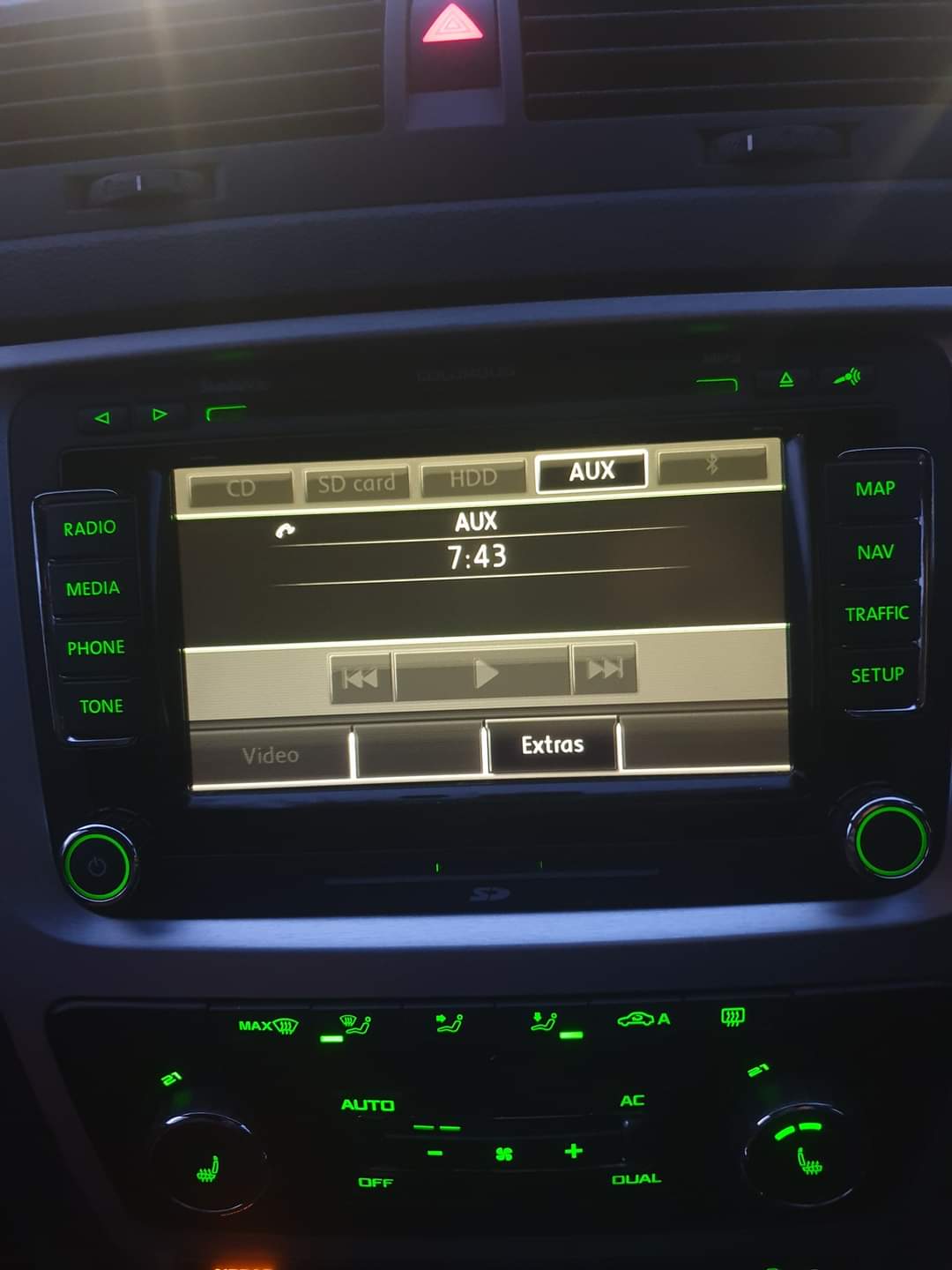

  4. Hi all, I have the Columbus with Kufatec bluetooth. I can use for hands free calls fine. I can stream bluetooth audio from spotify - kind of. Can anyone help with the questions below: Every time i want to stream audio i have to use the maxi dot and enable A2DP then i can start streaming. The quality is really poor, sounds very tinny and no depth to it. I have tried the setup on the maxi dot but can only turn volume up / down. - Is there a way to just enable A2DP without having to do it manually every time i start the car? - Does everyone else's audio sound shocking? On my 'Media' button i only have AUX lit up. The bluetooth symbol is greyed out (even though i am streaming audio). I should be able to see song titles / info and use the skip track on the steering wheel. Anyone else have this problem? Any help>
