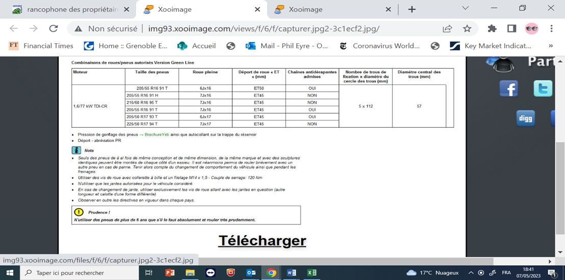

Hi Blackbird, the car is a 2014 1.6tdi DSG (so auto) 'Green Tec, Elegance'. I bought it second-hand near new from the local dealer. It came with the wider hubs, 7" and the 215s fitted by same dealer. Today I found earlier references to the series 1 Greenline for this exact engine with 215s as an option, according to this table from a French forum. Yet all the official statements received in the last week have confirmed that they are not legal size for this model

Further info from a Skoda site https://www.auto-selection.com/fiche-technique/skoda/yeti/2013/1-6-tdi-105-elegance-dsg-green-tec-4x2-1203965.php. Refers to 205s only. Otherwise various sites want to sell an EU Cert of Conformity for over 100 euros, for free one 'please contact constructor'... FICHE TECHNIQUE SKODA YETI 1.6 TDI 105 ELEGANCE DSG GREEN TEC 4X2 DIESEL ANNÉE 2013, 2014 ET 2015 Marque :SKODA Modèle :Yeti Version :1.6 TDI 105 Elegance DSG Green Tec 4x2 Catégorie :Break 5 portes Energie :Diesel Commercialisation :du 08/2013 au 05/2015 Pneumatiques Matériau des jantes :Aluminium Taille des roues avant :205/55 R16 Taille des roues arrière :205/55 R16
