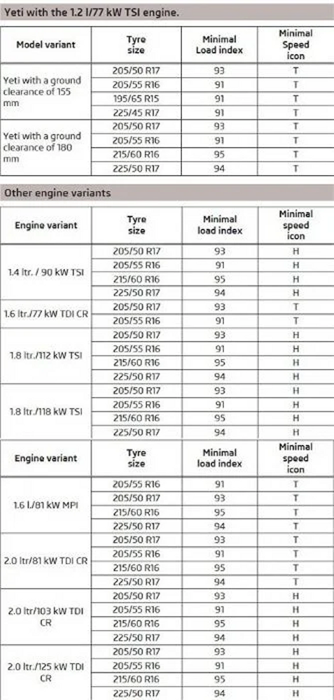

Yeti UK approved tyre sizes in the manual.
So the 1.2TSi 77kW/105HP engine with 155mm of ground clearance can be fitted with 195/65R15 tyres.
There's no mention of the 1.2TSi 81kW/110HP engine which replaced the 77kW/105HP engine in 2015. Presumably, that can also be fitted with 195/65R15 tyres.
195/65R15 would give similar ride comfort to 215/60R16, but is a much cheaper size.
Edited by Carlston
My manual that it came from is November 2014, I don't believe the tyre information was published in later manuals, I would like to be proved wrong on that though.
CBA
Edited by Llanigraham
Not in my 2017 brochure, only info on snow chains.
