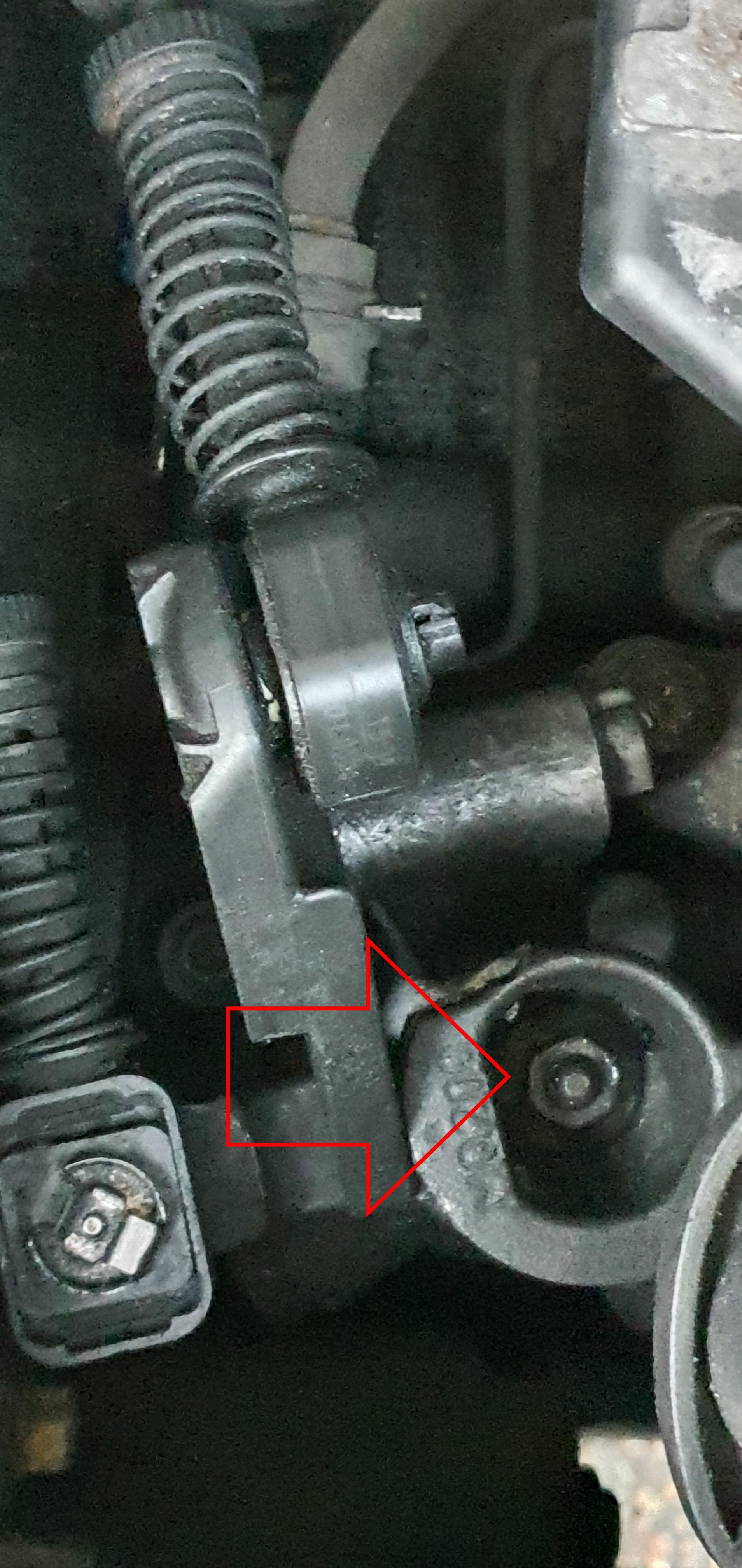

  2. Thank you all for your replies. @RickT What rotational movement are you referring to? From what I can see the collar part moves correctly with the gear linkage but does not seem to move any other way. @Carlodiesel & @Austin 7 The double-nut or replacement nut idea seems like a good one, but I am paranoid about removing that nut now just in case the collar slips and I lose the gear alignment again. Also, silly question I know, but how do these Nyloc nuts work? I have never fitted one before so what causes them to lock in place, and how easily can they be removed once locked?
  3. It looks like that but the technical drawings seem to indicate it is a push-clip which doesn't need one. The issue I have is the grey collar bit keeps loosing its alignment due to the nut coming loose. RAC Guy couldn't find anything else wrong.

  5. Tempting but I would prefer to find out what kept it from coming loose originally. Would I be able to tell if the nut was originally self-locking and now needs to be replaced?
  6. Hi All, I'm having problems with the Gear Selector on my manual-transmission 2010 Yeti. The nut in the centre of the Gear Selector collar (the bit that rotates a bit when you change gear, nut arrowed in attached photo) keeps coming loose, and when it gets too loose the Gear Selector collar slips off the teeth of the gearbox cog underneath, looses its alignment and only allows me to select 2nd, 4th & 6th gears. This has happened twice so far in the last 6 weeks or so. Mr RAC Guy says that he would expect there to be some kind of locking nut stopping this nut from coming loose but there doesn't seem to be one. I don't think anything has fallen off, and what technical diagrams I can find online do not give any explanation if this single nut is supposed to be a locking nut of some kind. Can someone please tell me what is supposed to stop this nut from coming loose and causing this problem? Kind Regards, Alan G
