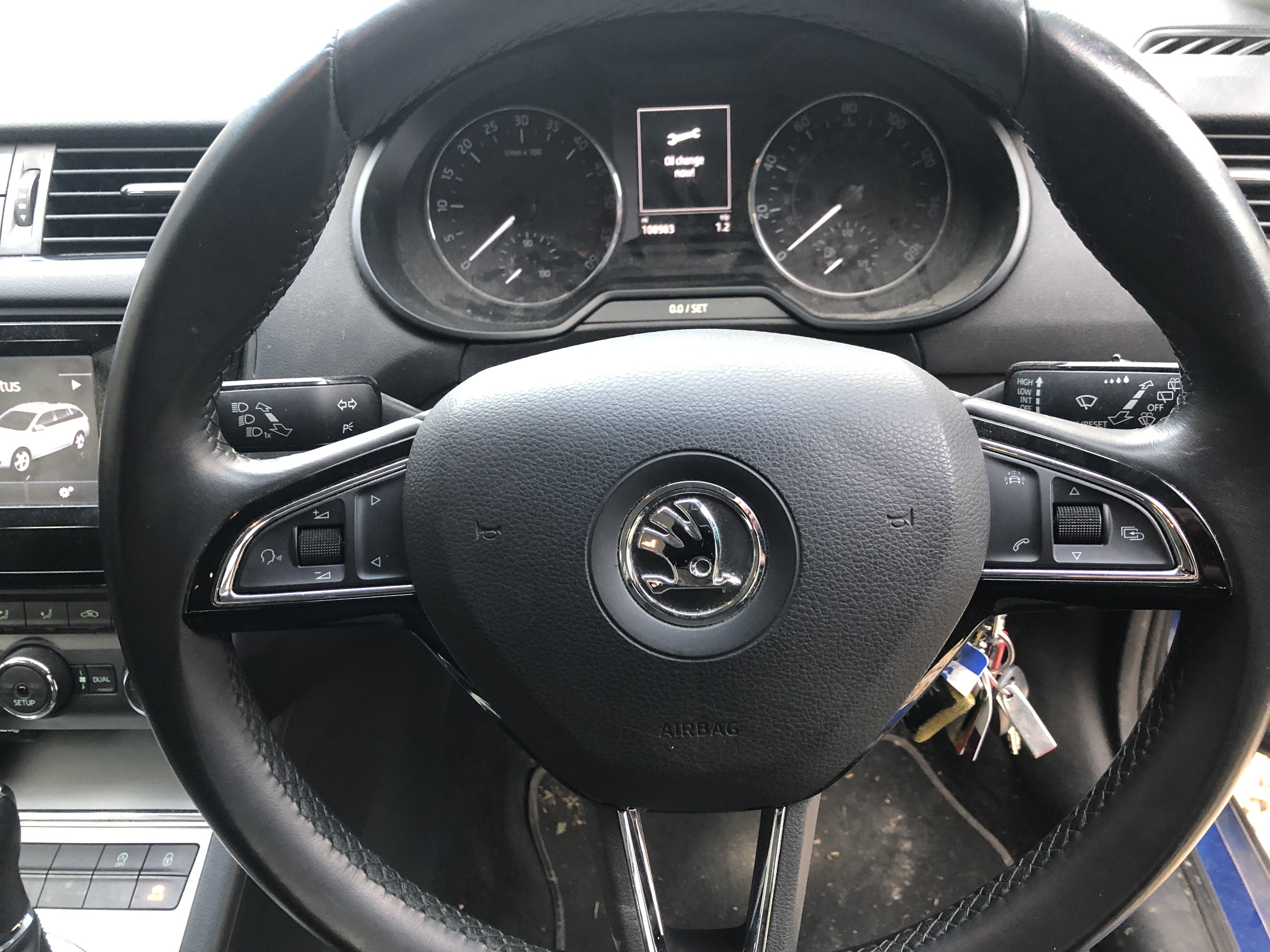

  11. Good afternoon all, I have a 2013 Octy 3 DSG, I have replaced the 4 spoke non MF steering wheel with a 3 spoke MFSW (photo attached), at the moment the lights on the steering wheel do not light up and non of the buttons work, the dash displays the buttons not the wheel when a phone call comes in so I am hoping that the highline gateway is there, can anyone help with codes etc, I'm hoping that this all that is missing here to get this working..... so much hassle just to be able to control the stereo from the wheel!!!
