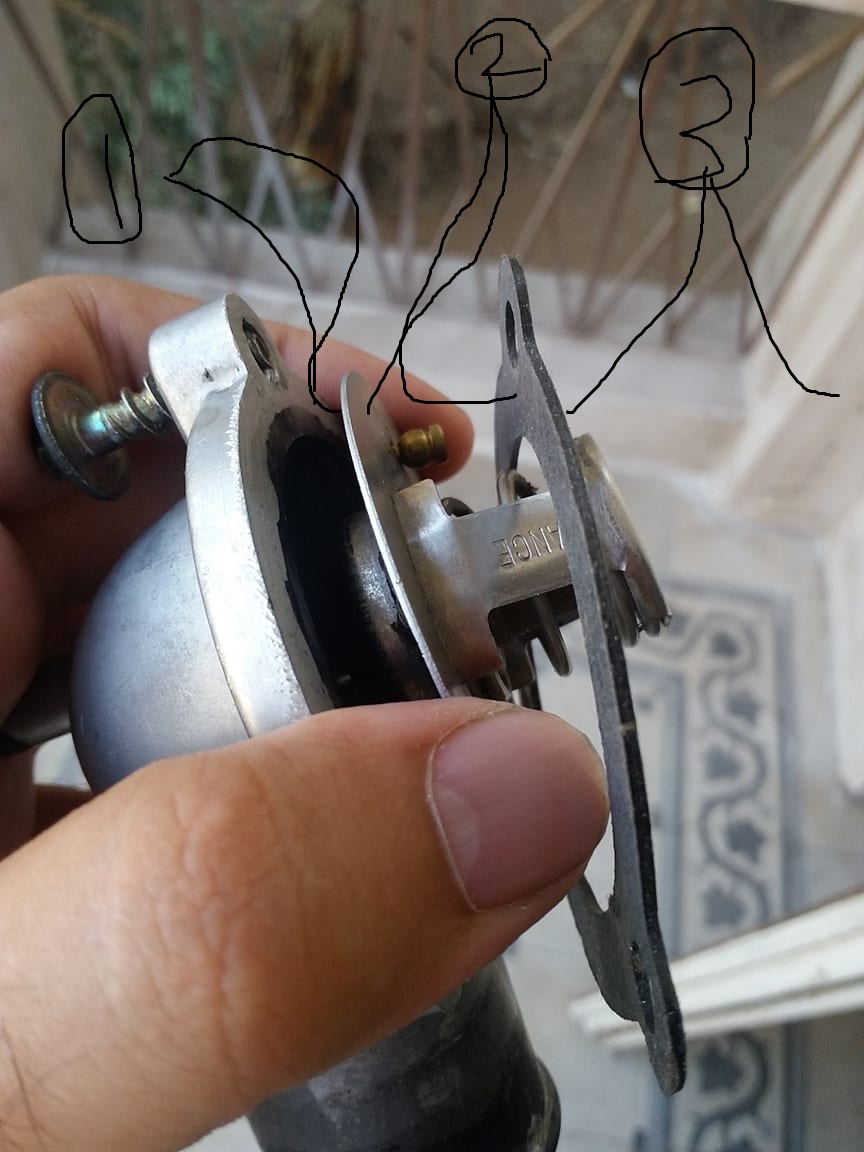

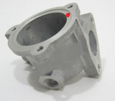

captain_crunch replied to captain_crunch's topic in Skoda Favorit, Skoda Felicia, Skoda Fun and Skoda Formanthe second part in thermostat housing in felicia plastic part is flat not like favorit have thermostat place that i make with red dot yes the thermostat is installed as i bring the outer part from favorit with the second plastic part but always there is a leak between two parts so i asked what is the sequence ? second i want opinion of recommended thermal silicon ?

captain_crunch replied to captain_crunch's topic in Skoda Favorit, Skoda Felicia, Skoda Fun and Skoda Formani made modfication to be able to put 60m thermostat on felicia half of the hermostat housing from favorit and other from felicia as its recommended by @RicardoM but i wonder if this sequence below is right the black lines i will but thermal silicon number 3 will be silicone with the gasket and second part
