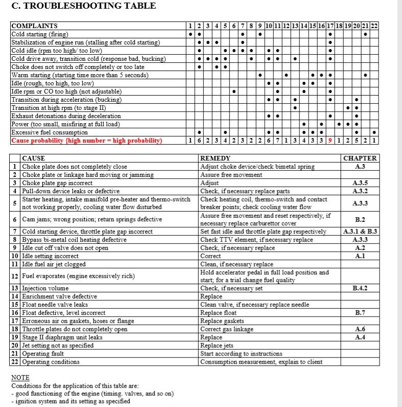

captain_crunch replied to captain_crunch's topic in Skoda Favorit, Skoda Felicia, Skoda Fun and Skoda Forman14 - yes enrichment valve consider be defictve its not working 16- i think float is working well no fuel flood in carbruter or hard starting the engine 18 -throttle gas open completely 19 - i tested stage 2 diaphram by sucking it worked well 20 - what jets meant not as specified is it mixture screw or (1st stage get and 2nd stage)

captain_crunch replied to captain_crunch's topic in Skoda Favorit, Skoda Felicia, Skoda Fun and Skoda Formanoh i well tell yes as the car have low maintince for a while as my parents only was driving it from 1997 to 2014 after that i begin to drive the car since 2015 of course didnt know much about car mechanics i face many problems and have not much experince as now 1- lack of power ((1-faulty stage 2 + carbruter was very dirty) 2-wrong valve clerance 3- engine oil need replaced 4- gearbox 10s was broken i dont until now how this happen causing very huge leak in gearbox oil 5- spark plugs need replaced 6- fuel filter need replaced also air filter need replaced 2- have problems with barke system (1-brake master cylinder 2- all brake pads need replaced 3- brake discs need replaced 4- brake fluid need replaced ) 3- have problems with coolant as it was using tap water not coolant fluid this cause a rusty nightmare in coolant system (1- faulty water pump 2- rusty hoses and pipes 3- rusty radiator ) at all i solved this problems 1- 1- replaced 2nd stage diphram + clean carbruter 2- make new calibration valve clerance 3- make engine flush and replaced new engine oil 4- replaced gearbox 10s with 14sk 5- replaced spark plugs 6- replaced fuel filter and air filter 2- 1- replaced brake master cylinder 2- replaced all brake pads 3- replaced front brake discs 4- replaced brake fluid) 3- 1- replaced water pump 2- replaced rusty hoses and pipes 3- replaced rusty radiator also flushed the coolant system and put coolant fluid but still there rust i think it will be always forever at all i am i lucky and thx god the orginal headgasket still working well Was it a slow decay of power? not much the most problem in top speed also i have belief the only part that need to be calibrated is carbruter as i say before enrichment valve not working also carbruter need a good clean sorry for long description but this felicia have a lots of memories with me since 1997 i was 5 years old and i consider it one of my family not just a car

captain_crunch replied to captain_crunch's topic in Skoda Favorit, Skoda Felicia, Skoda Fun and Skoda Formanyes i have haynes and master manuals if you have another one with better explantion please share with us there is someting i tested today i bring small tiny peace of paper put on the second stage then i drive felicia with full throttle and take look again the tiny pice of paper disappear i think the 2nd stage vaccum is ok but i cant find way to check fuel starvation on 2nd stage i have 2 queestions 1- what is the 1st and 2nd stage screw jets number is it 0.92 mm and 1.2mm ? 2-can i tested the second stage by raise one side of car and start engine and give it 1st 2nd 3rd 4th 5th gears with full throttle while (the wheel raised will turn around itself ) and another pesrson look at 2nd stage

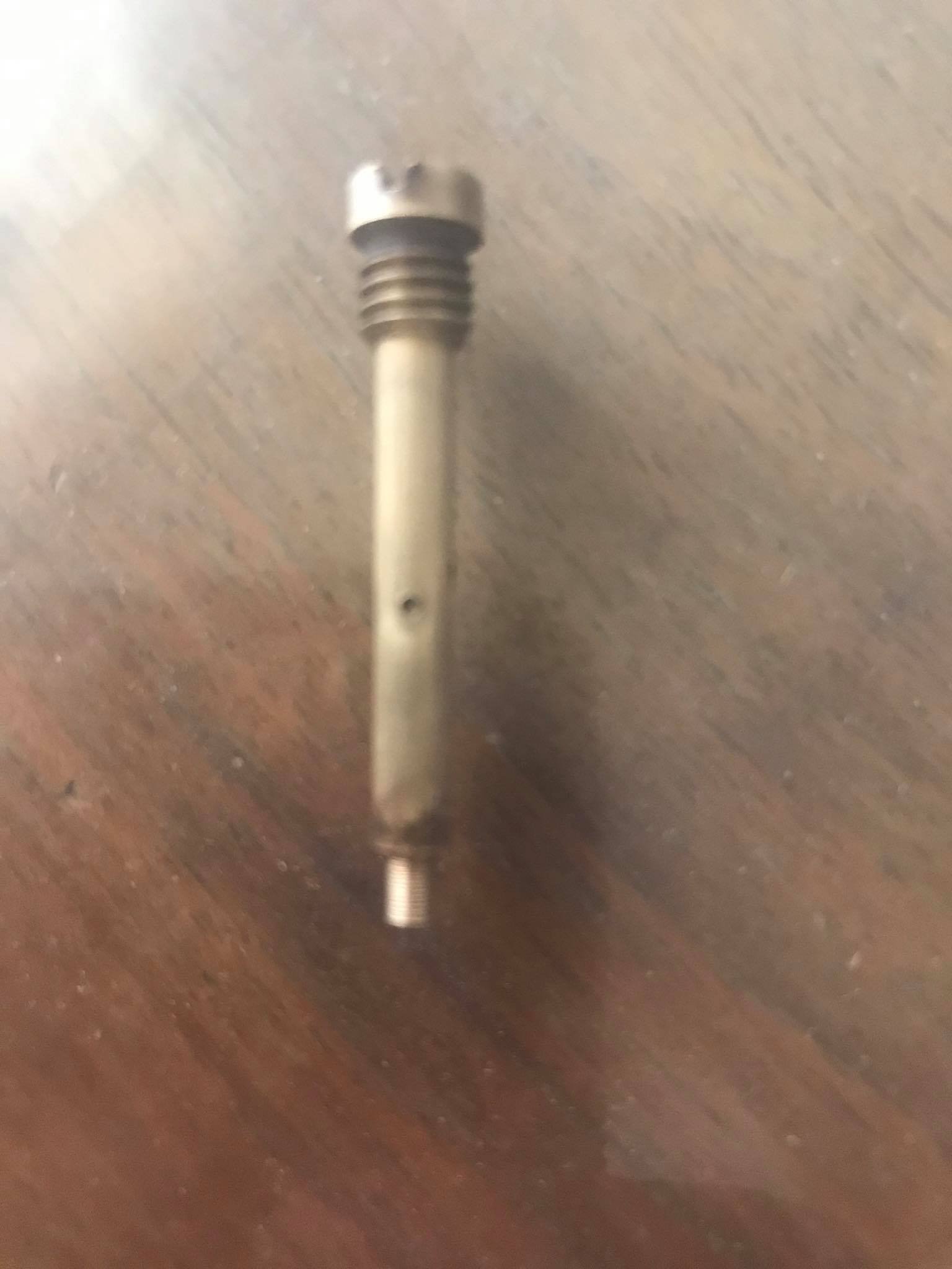

Need help photo of original 2e3 mixture screw (Co screw ) and idling fuel/air jet screw
captain_crunch replied to captain_crunch's topic in Skoda Favorit, Skoda Felicia, Skoda Fun and Skoda Formani have 2 questions first i dont have the rubber ring does it affect ? second if i want to remove mixture screw (co screw) does it need to remove carbruter or like the idle screw ((carbruter installed)
