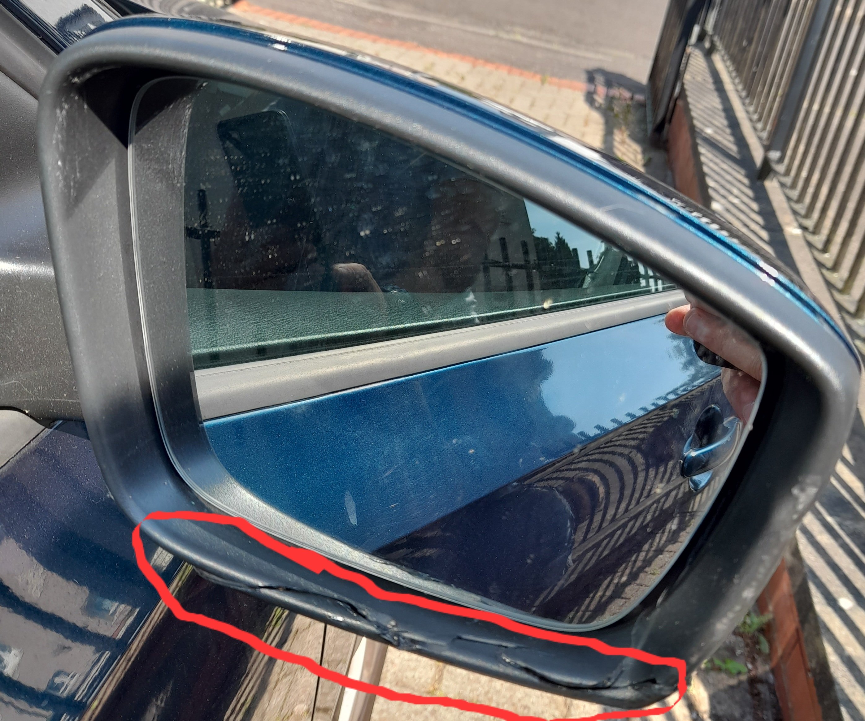

  1. Wondering if anyone knows if you can order the black plastic trim that goes around my right door mirror? As you can see in the pic it's cracked, I'm unsure if it can be pryed loose then a new one clipped back on again. Or if you need to buy a whole new right door mirror? If anyone even knows the part number or where I can order it that would be brilliant. Thanks
