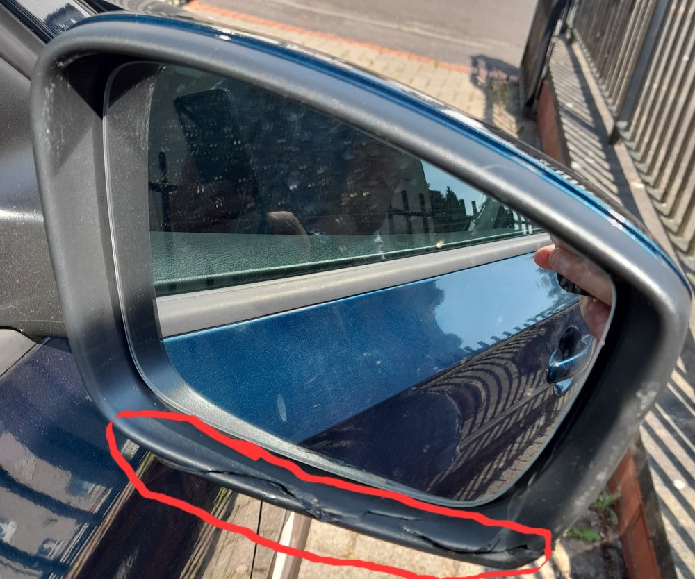

Door Mirror Frame
Wondering if anyone knows if you can order the black plastic trim that goes around my right door mirror? As you can see in the pic it's cracked, I'm unsure if it can be pryed loose then a new one clipped back on again. Or if you need to buy a whole new right door mirror? If anyone even knows the part number or where I can order it that would be brilliant. Thanks

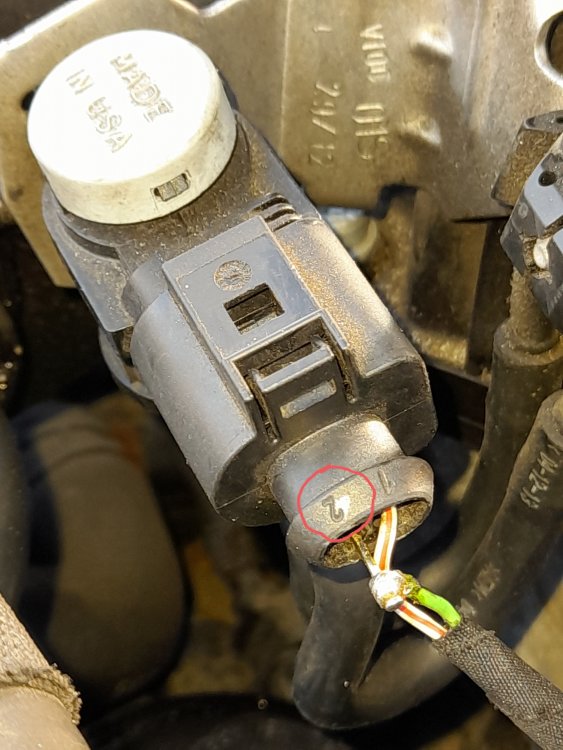

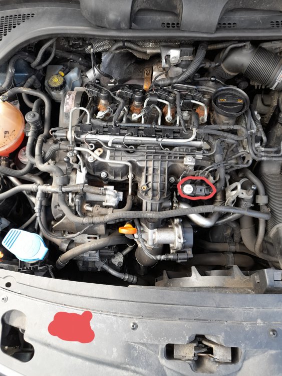

Engine Management Light
**UPDATE** Managed to get this fixed and engine management light has went out on the dash. The problem was the solenoid valve, in slot 2 the earth wasn't getting a good enough connection to complete the circuit and was slightly out the hole. I pushed this in all the way in and problem solved. If anybody gets the same fault I'd check the connections first and if that doesn't work try replacing the solenoid valve completely, only costs about £20 to get a replacement.
