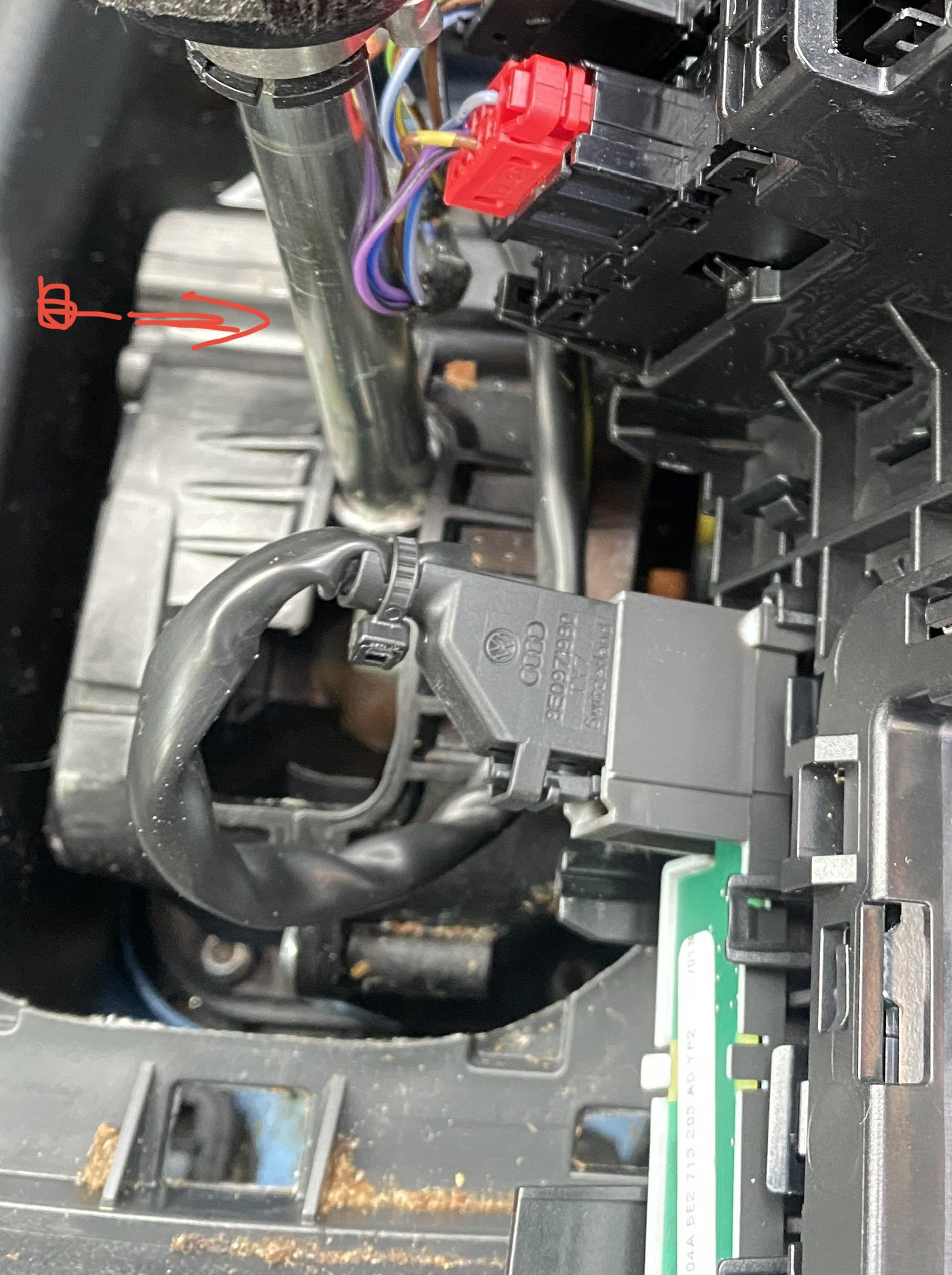

  2. id assume it’s the same DSG gearbox in the superb so same micro switch fix - it’s a common issue across the vag platform. I managed to fix it on the Octavia just by removing the bit panel around the lever - didn’t have to dismantle the whole centre console. There was one screw I needed to undo from the side so I drilled a small hole in the plastic panel on the side- it’s barely visible. Got micro switch from Horton Skoda part no. 5Q0713128A but take care as there’s two types of DSG and thus two different fix microswitches . First pic before pic - red arrow for the screw I had to undo from the side. Second pic shows new switch piggy backed onto gearbox. You can see the white switch. No more irritating beeps and error messages!

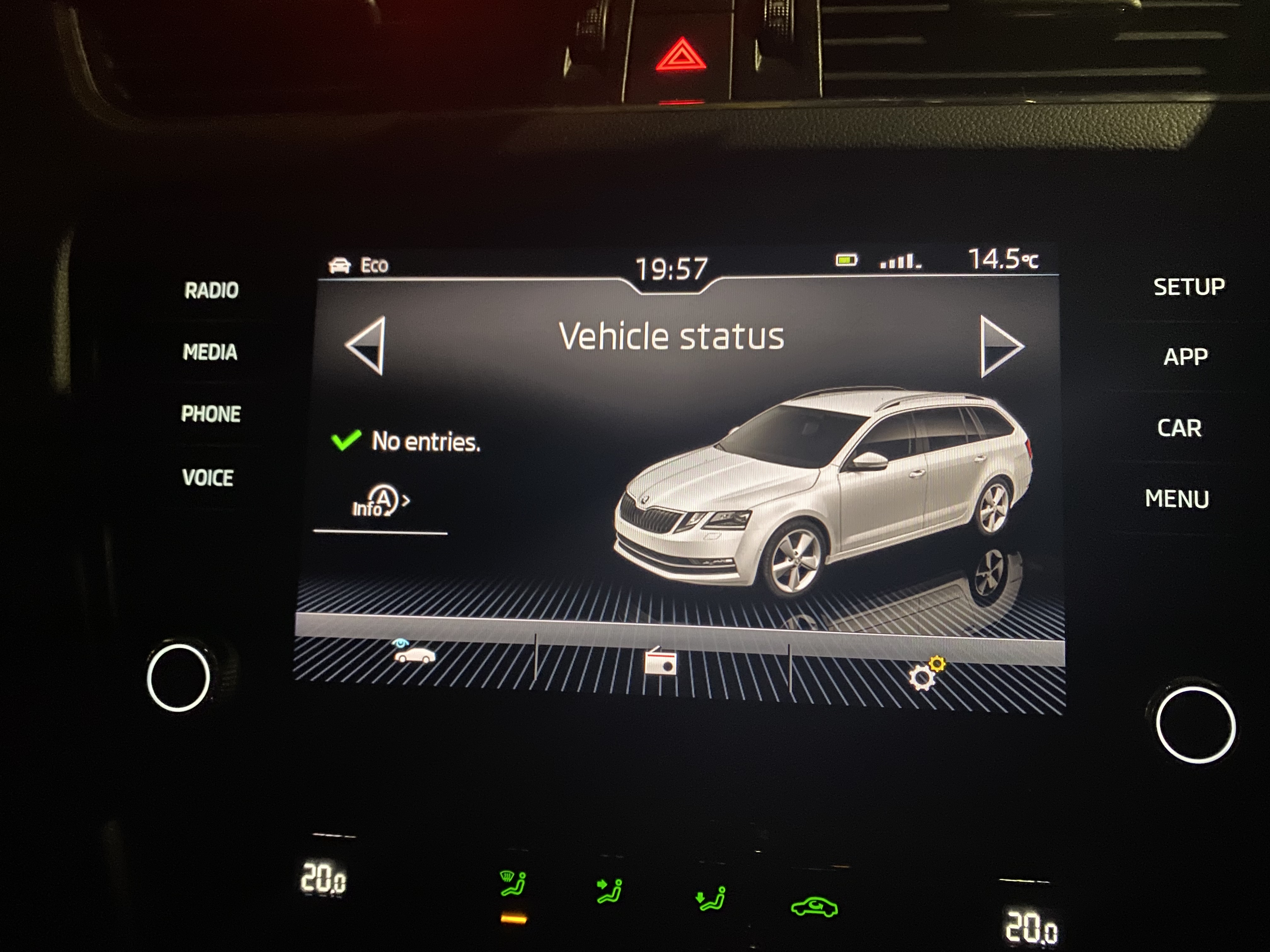

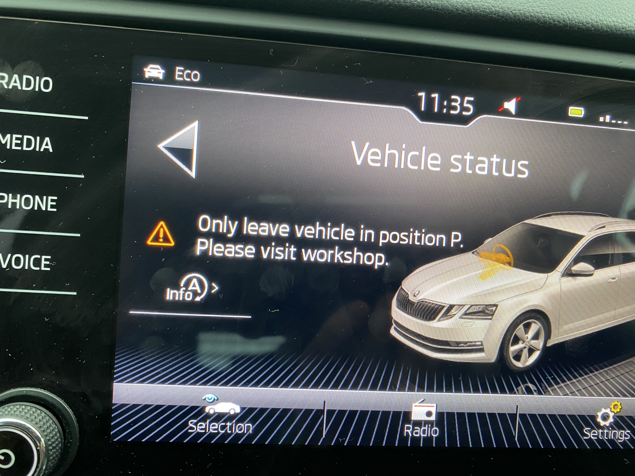

  7. That’s good it showed the error especially with warranty making it difficult without. Bit of a disgrace really as the issue is well known to Skoda/VW so they’re just trying to get out of it. I didn’t get the orange steering wheel. Just the orange triangle!! Before and after pics

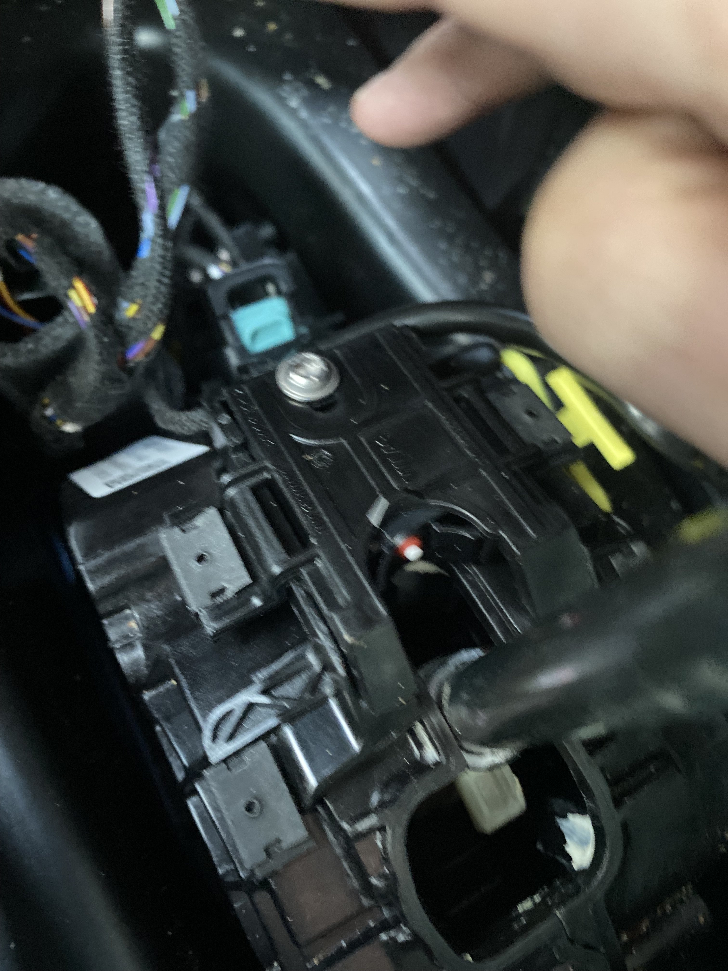

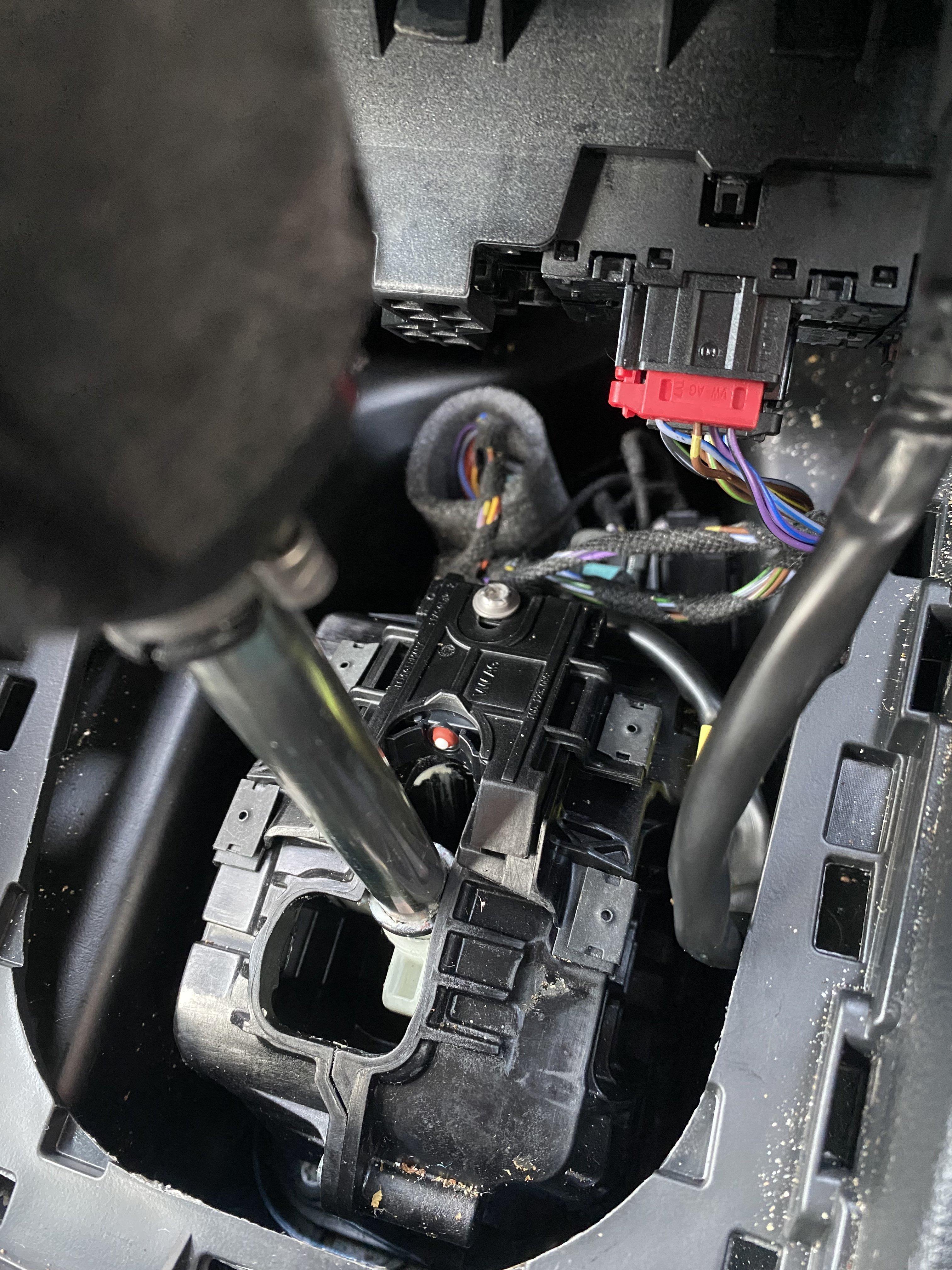

  8. Mine was intermittent for ages but then became permanent. I carried in using it anyway without any issues. Just have to take care you don’t leave the car in D or R when you park up as you can turn the ignition off and remove the key in this position! Mine was out of warranty and I didn’t fancy paying the stealers £300+ to sort it hence I bought the part myself. If you’re handy with a screwdriver it’s an easy fix.
