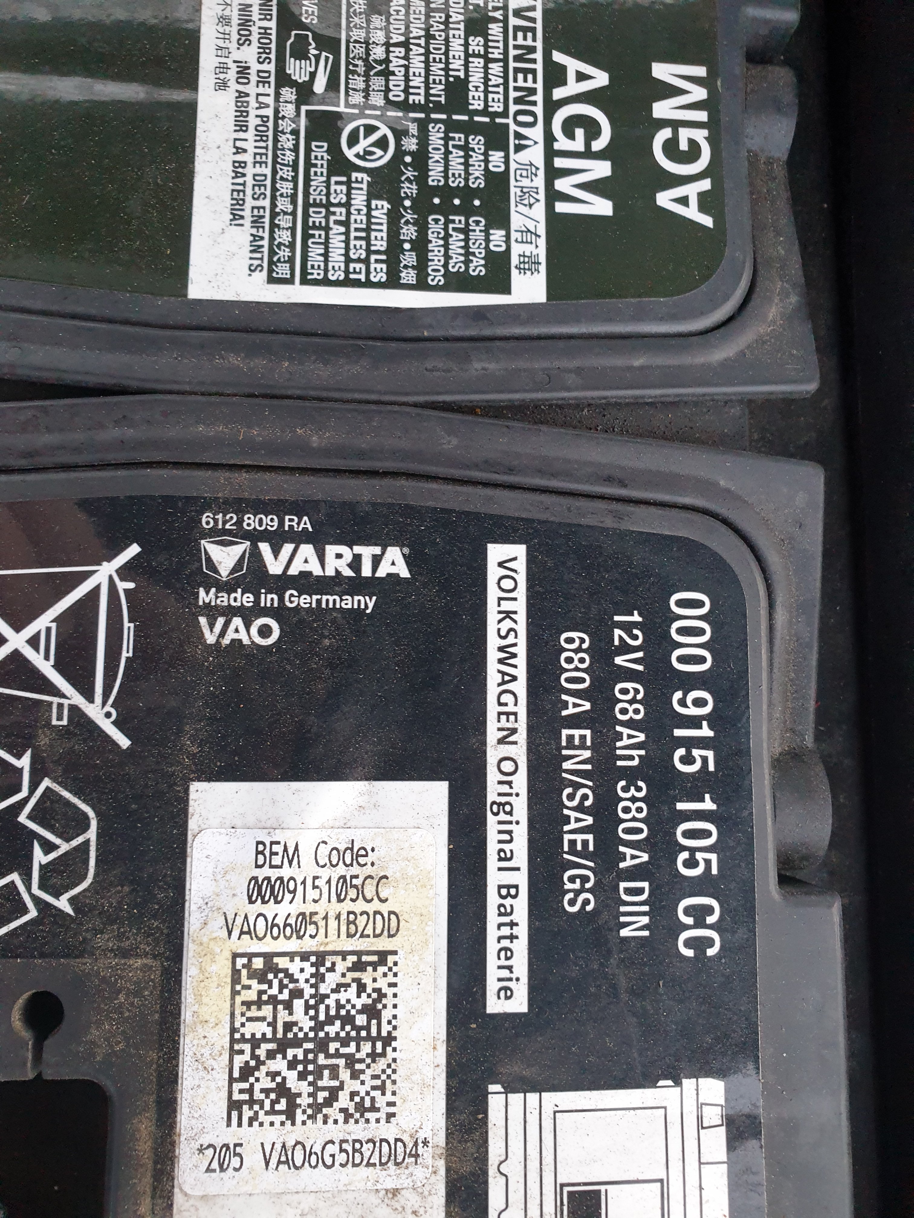

  12. Bit the bullet today, had my local VAG specialist replace my AGM battery and coded it in, all sorted. Thanks for all your support and feedback, much appreciated. Regards Tony
  13. @varooom Tayna say £14 to return, nor brainer I am sending it back and getting the Varta AGM equivalent and then getting my VAG specialist to code it in. Many thanks for all your support and guidance it's much appreciated. Regards Tony
  14. @varooom I will enquire about the return cost and if cheap enough purchase the correct battery and get a local specialist to code it in with VCDS. Are the last battery details I sent you correct?
  15. @varooom Would this battery be more suitable? https://www.tayna.co.uk/car-batteries/bosch/s5a08/
