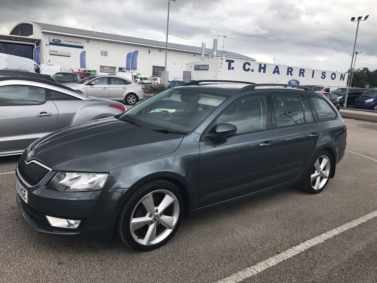

  5. After loosing my 14 plate Octavia I’m now a happy Superb owner. 2017, business grey, hatchback, S E Executive, 2liter Tsi, Dsg, black leather.
