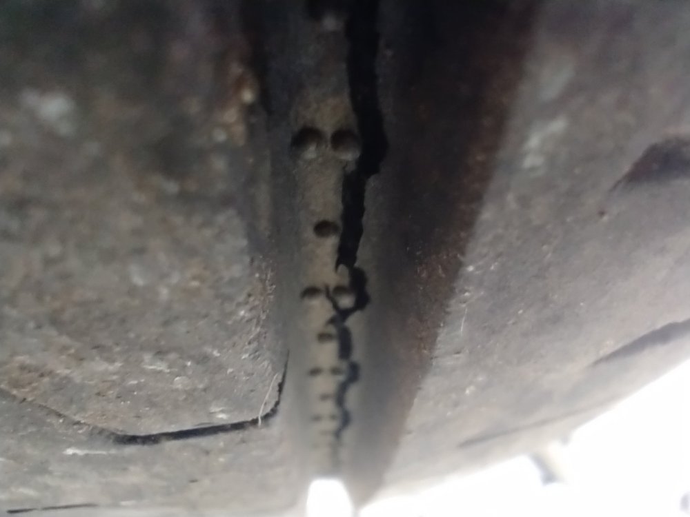

Many thanks for all the replies, help and suggestions. I'll get them changed asap. The cracked tyres are Cooper Zeon CS8. The two on the front are by far the worse. There's one Cooper Zeon CS8 on the back, which just a small amount of cracking. And there's a Runway Enduro HP on the back that is fine. Couldn't find dates on any of them. Do all tyres have dates and if so is written in some kind of unusual format? Thanks again

Hi A confession first... While I drove a Skoda Fabia Mk1 my wife has recently inherited a Corsa and it's the tyres on these that I noticed the cracking on this morning. It's in the long "in between section". It runs around the whole tyre and is the same as in the photo for two of them. A third has it but not so bad. And the fourth is ok. Do they need replacing asap? Are they dangerous? Many thanks

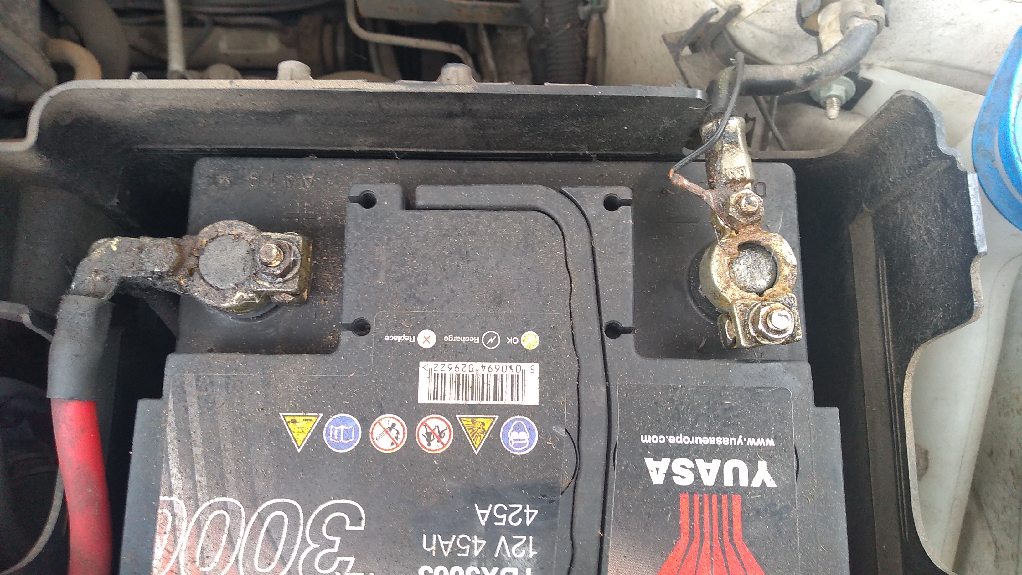

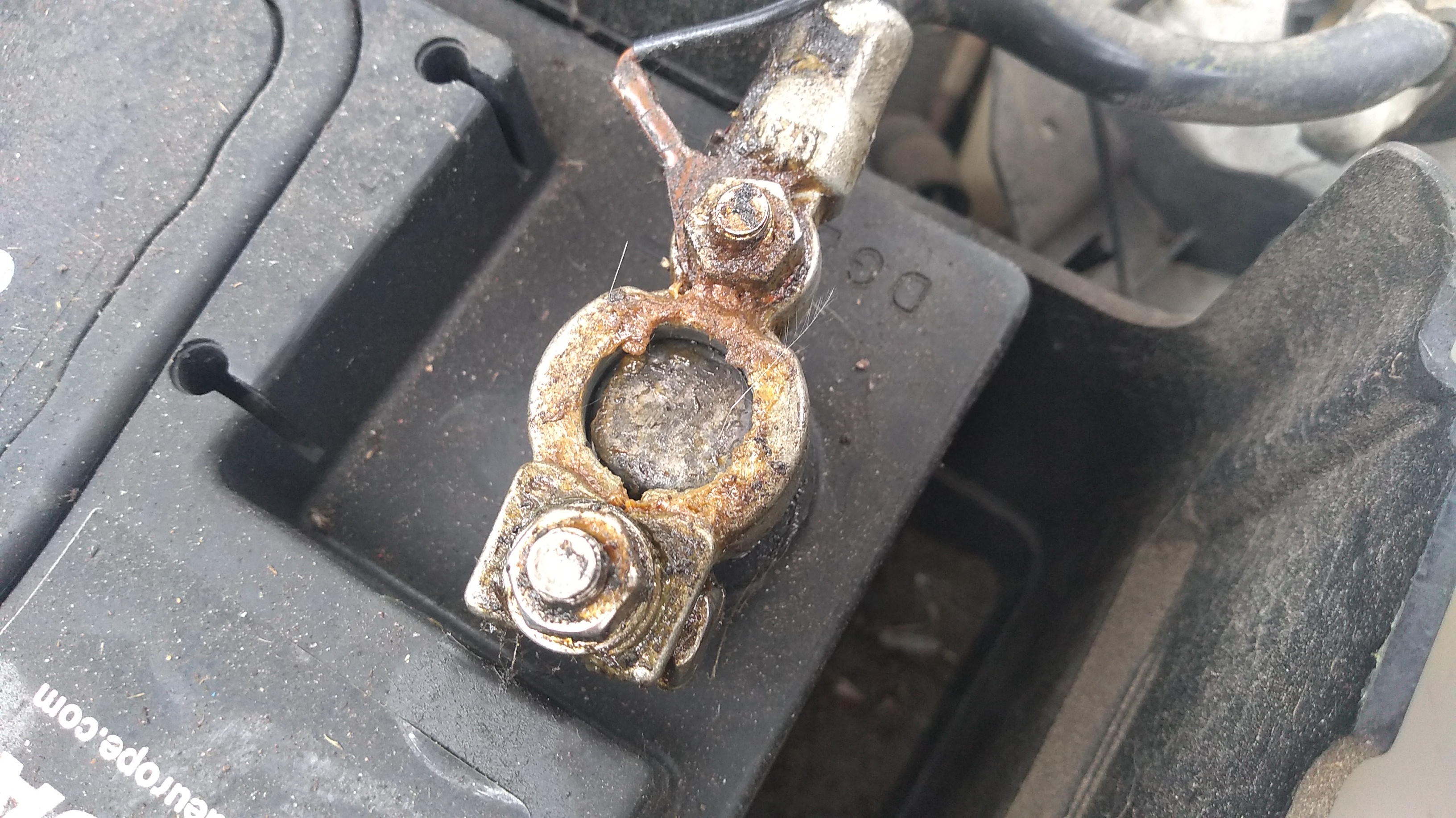

Just wanted to update the thread to say all was well after tightening the connection... And more importantly to say a huge thank you for helping. What a great forum! Is there a forum charity or anything like that? I feel the advice I've got on here has always been great and it's time to say thanks in more than words

Thank you - that's fantastic. Is there anything I need to do - or not do - from a safety point of view?

Well, well, well... I've not been with the car since before I made this thread. Got to it this morning and before calling the RAC I did as recommended. Seems the culprit is the neutral battery clamp, which is loose and half way up the pole. I'm no expert, but based on what you guys have said I feel reasonably confident that this is the problem. To be sure though I've taken a couple of photos which I hoped someone might kindly take a look at? Please see below. Presuming this is the problem, I don't know much/anything about working on car batteries so could anyone tell me how to reconnect/tighten the terminal safely please? Thanks again for all the help. I wish most the mechanics I meet and use were as good as you guys!!! I owe you all a pint or ten Cheers

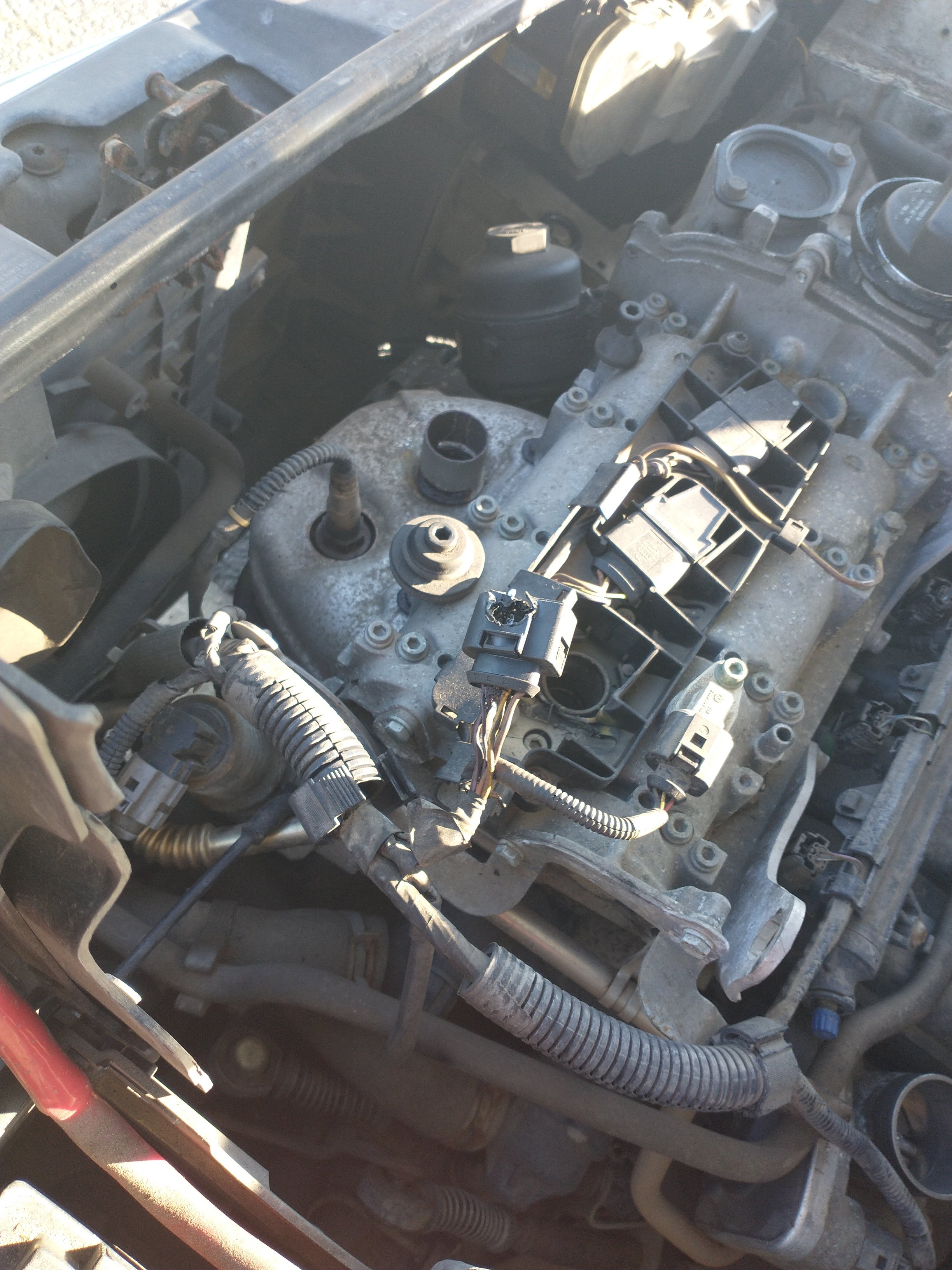

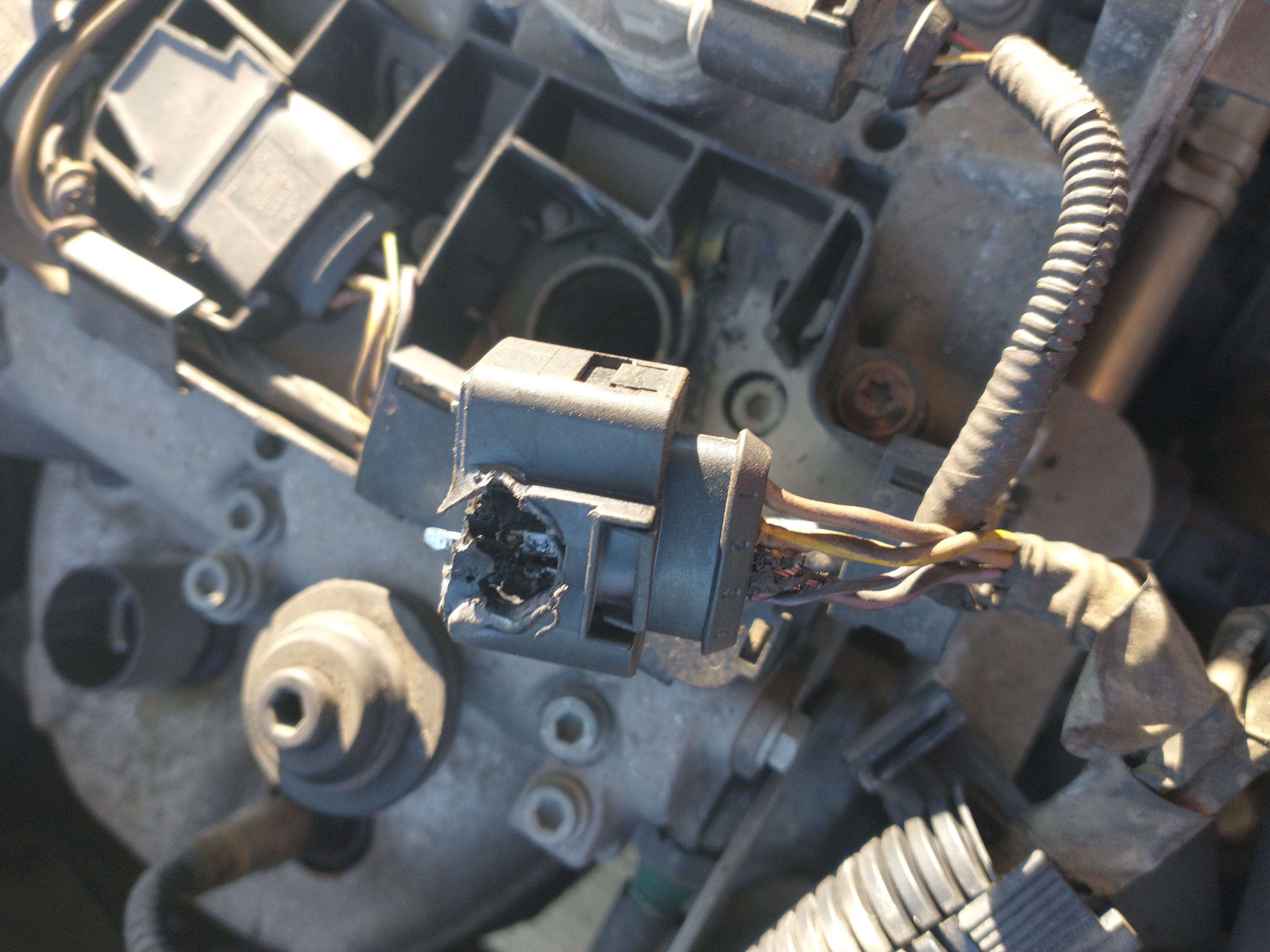

Many thanks for the replies. Do the computer things the RAC carry with them fit the above? Or are they something more basic? That's really strange for a couple of reasons. Firstly, if I remember right it wasn't so much him seeing that the pipe was disconnected. I'm pretty sure it was a fault code which led him to it. Secondly, before the "fix" the car would stutter on every journey more or less, most of which were short journeys. Afterwards, it only did it once or twice over quite a few short journeys and a 600 mile round trip. So everything pointed to that being the cause and that it had been "fixed"... Not that I'm doubting what you're saying! On that note... We spoke to a local mobile mechanic, and he said that they shouldn't have just changed coil pack no 3, but should have changed all of the coil packs. He's surprised they didn't, and seems to think if he was to come out that would be the first thing he would do. No-one else mentioned this at the time. What do you guys think? Is it usually best to change all three? A neighbour who is a retired mechanic had a quick passing glance at the battery and said it looked ok. But a tighten and clean up perhaps? And likewise for the earth connections as @mpm222suggests More generally RE the battery, could an old battery cause the problems described? The car has recently had work, and MOPT, and a couple of RAC call outs and no-one said anything about the battery. But it is an old 'un... Regarding the car computer...: - How long does it store fault codes for? - Are the fault codes time and date stamped? When the gizmo is plugged in, does it show when the fault happened? Thanks again. This forum is so helpful!

Hi all I appreciate that this is a long shot asking, but it's out of somewhat desperation. Any thoughts greatly appreciated. I have a Skoda Fabia Estate 2003 (1.2 petrol). It's on around 130,000 miles but has always been a great runner, very few problems at all. It's mainly used for short journeys to work, but recently have had to start travelling back and forth to Norfolk from Wales every 6 - 8 weeks. The first problems started a couple of months ago with the car stuttering whilst traveling during local journeys. No warning lights came on, and nothing untoward would happen, it just wasn't smooth and would stutter along a bit before sorting itself out. It then got a little worse, so I called out the RAC. They said it was an easy quick fix... The little rubber pipe on the left of the engine had disconnected. Not sure what it's called, but it recycles the exhaust gases for further burning rather than releasing them to the atmosphere. Is seemed to the job. Perhaps the stutter happened once or twice more but nothing like it was. No idea if that's related to the next bit, but best to give the full story! So a few weeks later I was driving back Norfolk and the car conked out completely. I'd been travelling on the motorway fine, but after stopping in a service station as I was pulling back onto the motorway the car totally died. As I remember, the oil warning light came on very briefly just before everything died. The RAC initially thought it was kind of rodent damage to the fuel pump. When he changed the fuse, he said it just fused itself and nothing happened so he wondered it mice had chewed some interconnecting cable. However, he then said he put in a higher voltage fuse than normal and the car started and ticked over (although very chuggy). This lead him onto coil pack no 3, which he said dead shorted, and that I needed a new multiplug and coil. He said it had also burnt out the connecting wires (see photo's). He didn't have the parts of board, so I later arranged for my mechanic to do the work. The car has been working fine since its trip to the mechanic. Up until now! I had to come back to Norfolk a few days ago. It was absolutely fine on the main journey and a few shorter journeys once back. But then, after dropping my partner off, I went to start the car and it completely died again. It was as if the battery had been disconnected - no internal clock or mileage. Nothing. A few minutes later, and the electrics came back on. The car started fine. But a couple of restarts later and the same thing happened; completely dead. That was all a couple of days ago. Today it's starting fine as if nothing has happened, but I haven't tried taking it out for fear of it dying whilst being driven. Any ideas would be gratefully received. Also, any opinions on whether this fault could be related to the previous one would be really helpful. I've since noticed that where the burnt out cables were on the coil pack, they are now covered with tape. I'm not sure if this is a problem or could be causing the problem as I'm wondering if the mechanic taped up the wires rather than replacing them? Also, somebody mentioned that the wires could have burnt out because the RAC put in the higher fuse? Would that really be possible? I'm going to call out the RAC to see what they say. However, my concern is how certain can they be what is causing the problem? I'm not keen on heading back onto the motorway without knowing it's a 100% fixed, but I'm not sure how possible that even is with an intermittent fault. Plus, forewarned is forearmed, and I know a lot of people here know their Skoda onions and so might have some leads on what might be going on. Huge thanks for reading
