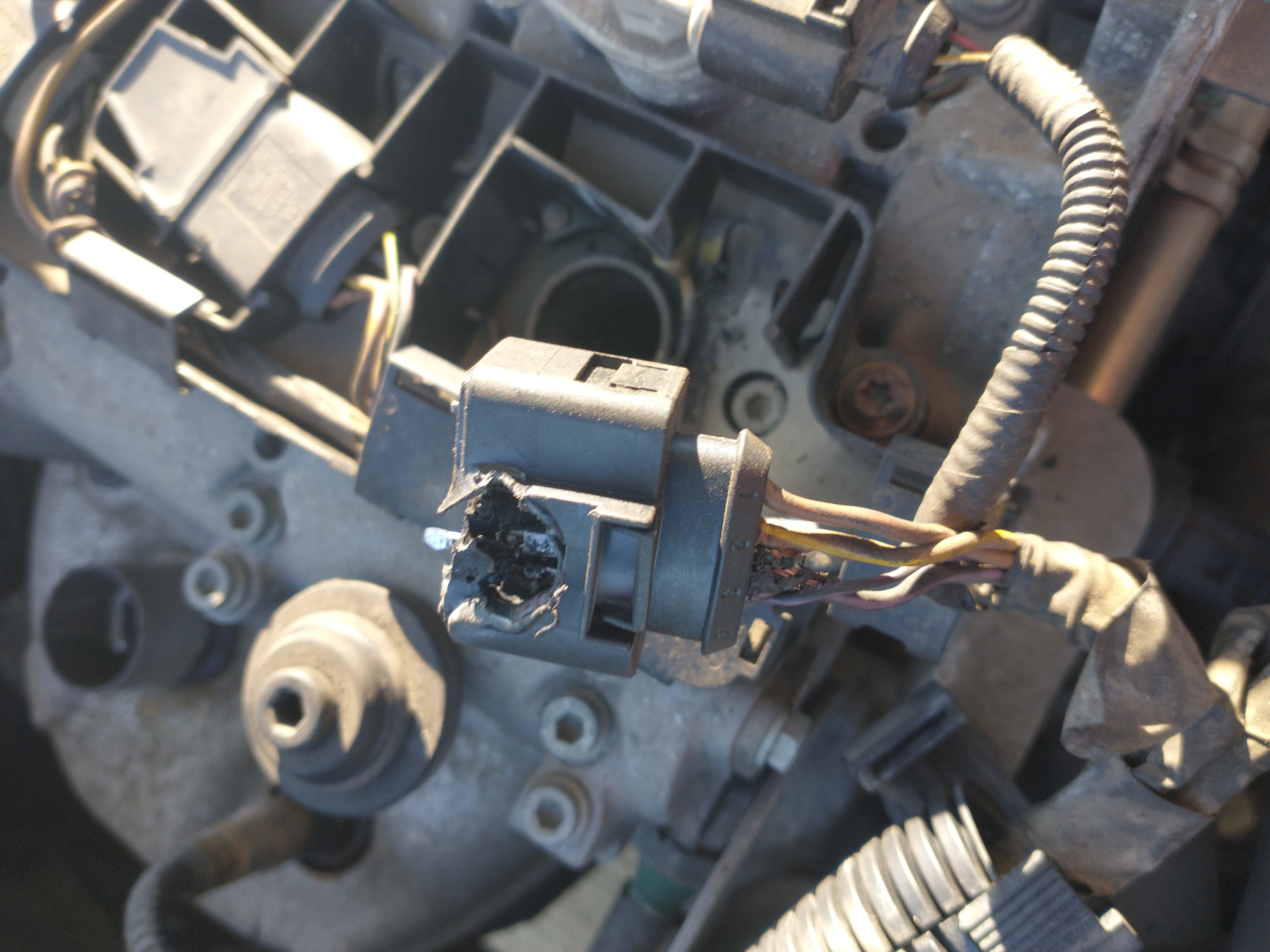

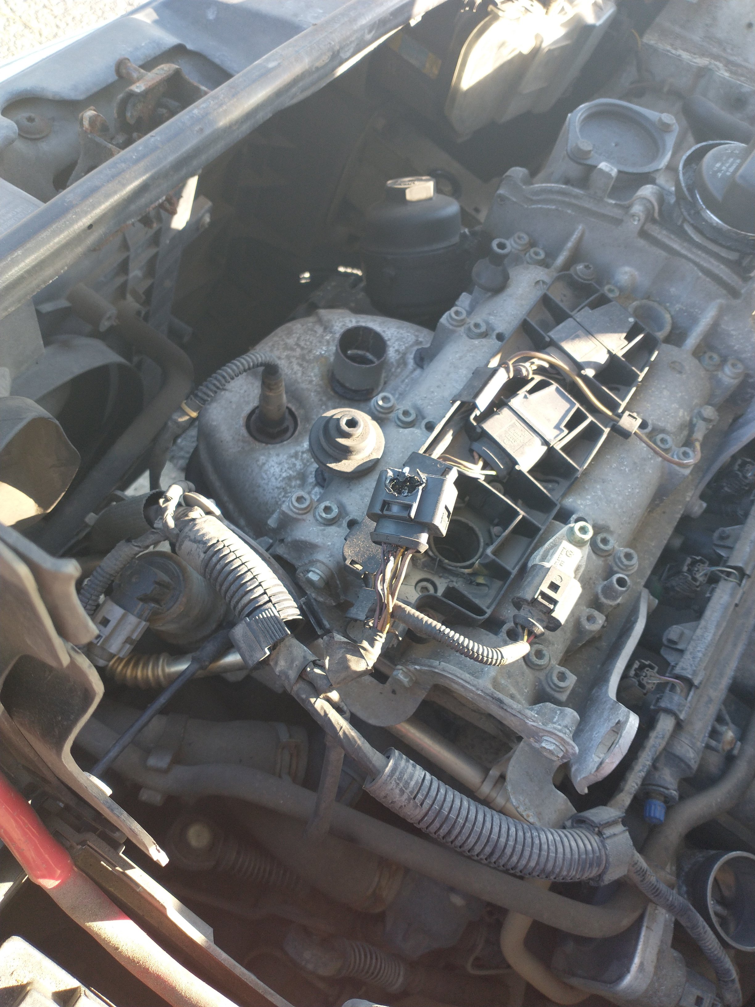

Breakdown - Coil pack no.3 dead shorted / multiplug burnt out - any thoughts or advice please?
Thank you both for such fantastic help. This forum always amazes me in how quick and helpful people are in their responses. Massive thumbs up. @Wino - one away from 15,000 posts - very impressive indeed. Pretty sure it will be at least fuse 61, firstly because that's what he has written on the report, and secondly because when it was blowing he was thinking the fuel pump was the culprit. But that's not to say fuse 52 hasn't blown as well... Will let you know if I find out more. At the moment we've no idea where the car is! RAC - who have always been great over the years - have been quite shockingly bad with this breakdown.
Many thanks for the quick reply @Wino Dramatic doesn't sound good - potentially! EDIT - doubting there is anything major wrong sounds better The RAC didn't mention anything about fluids and my partner (who was with the car - I wasn't there) didn't notice any, but didn't specifically look either. The car is a 2003 1.2 Comfort. HTP 64. It's not here at the moment so not sure of the engine code. Would it be in the log book or anything? I do have then Chassis Number if that helps? Have just asked my partner for more details and this is what she's told me... He thought that it was the fuel pump that had gone first. So he got her to turn the ignition but it wouldn't start, but it was enough for him to hear that the fuel pump was working. The wires coming out of the fuel pump showed rodent damage though but he thought were ok, but when he changed the fuse (presume fuse 61) it blew straight away. He then thought that maybe the wires had been damaged somewhere else. However, he then put in a higher rated fuse and it didn't blow and the engine started (but sounded chuggy and throaty), which then led him to find the coil issue and multiplug issue. Not sure if that helps?! Thank you so very much - you're a great help. PS - are coil no.3 and multiplug expensive parts?
Hi all Had a break down yesterday and am waiting for the car to be recovered back to me… I’m trying to find out a bit more about the fault that the RAC man diagnosed, as well as finding a garage who can book us in to repair. Whilst calling around, one of the garages said that the fault is an uncommon one and may be a sign of a much bigger problem (but couldn’t say for sure without looking at the car). None of the others have mentioned this so far. Whilst I carry on calling to try and get something sorted I wondered if anyone here has had this happen and/or has any thoughts to share? The report says: - Coil pack no. 3 has dead shorted - Requires new multiplug and coil - Fuel pump fuse F61 will also need replacing There’s also some photos which I’ll attach below. Many thanks
