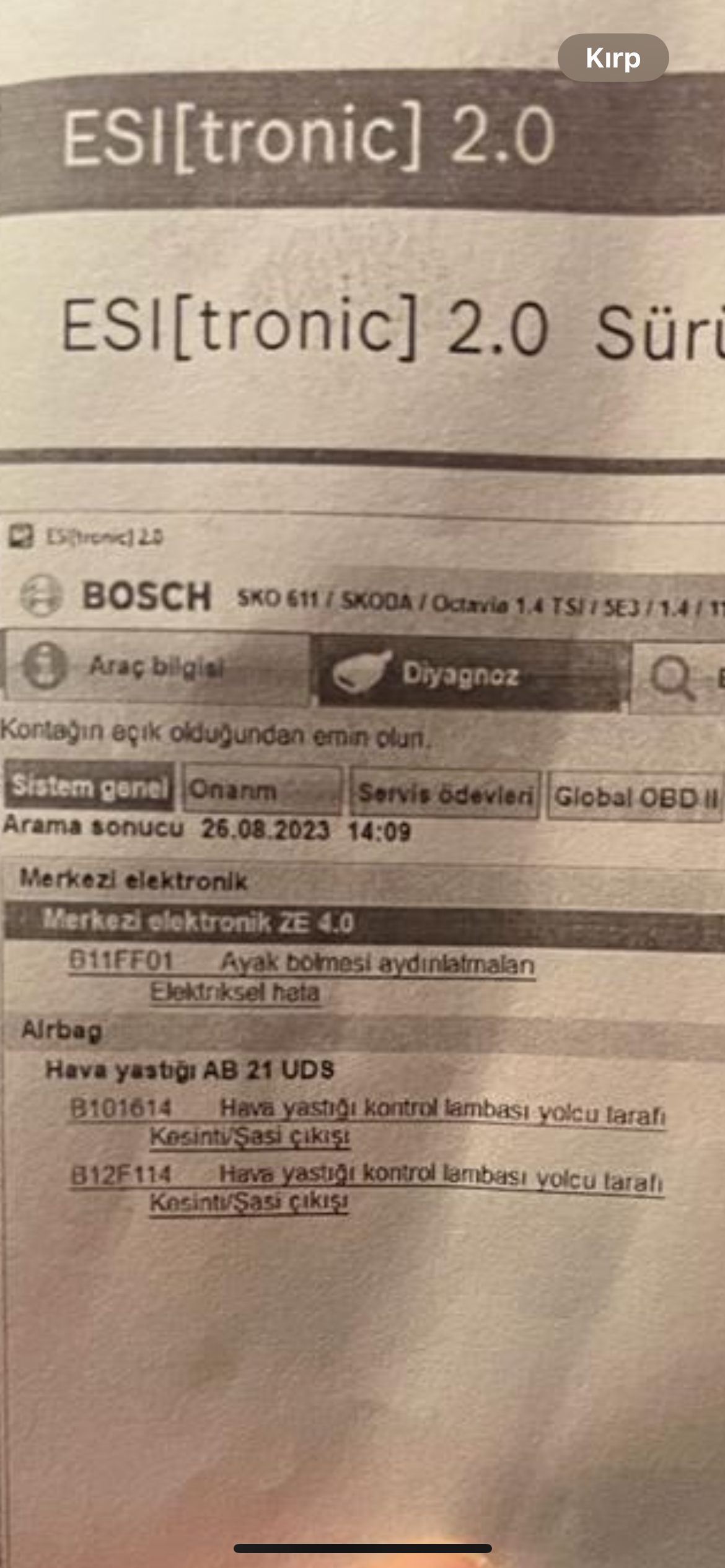

  1. Hi there, i have finally removed the airbag light and cleaned its socket with contact cleaner. Also changed the footwell light. Deleted the errors and its been 10days no errors thanks
  2. i can delete it but comes back in a few days
  3. Hi everyone, recently airbag ertor has popped out. error codes are B11FF01 and B12F114. Computer said its a passive error code and rekated with the passenger airbag indication şampanyası (short to ground). Does anyone has faced with this error? Thank you
  4. Hi everyone, recently airbag ertor has popped out. error codes are B11FF01 and B12F114. Computer said its a passive error code and rekated with the passenger airbag indication lamp (short to ground). Does anyone has faced with this error? Thank you
