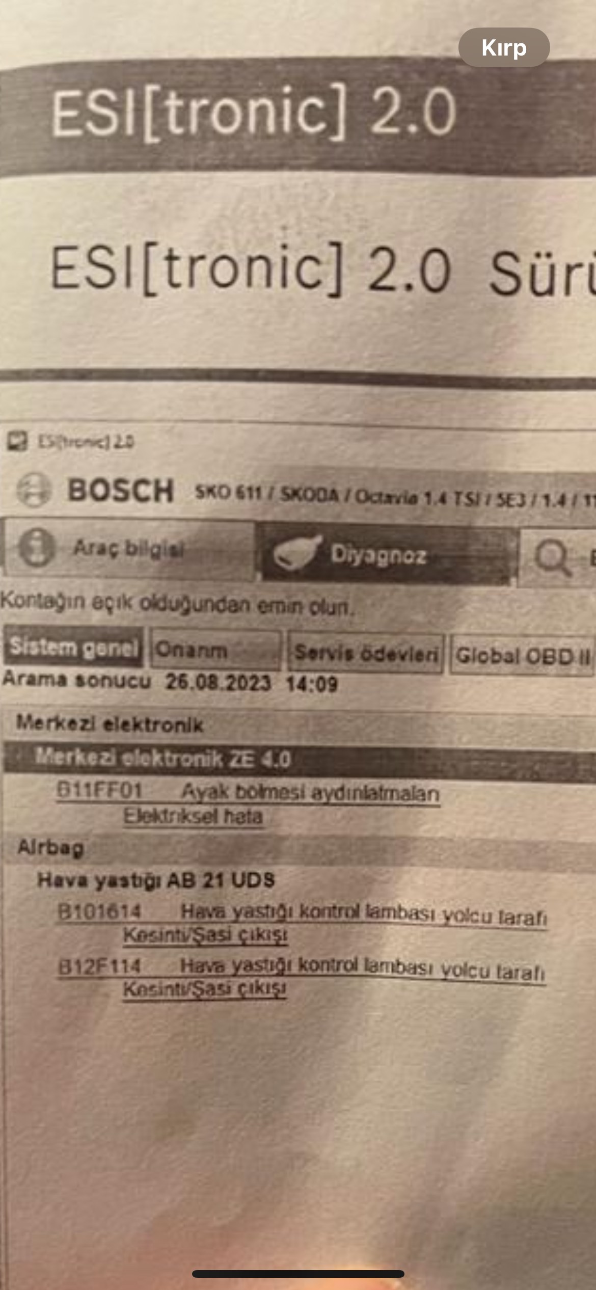

Hi everyone, recently airbag ertor has popped out. error codes are B11FF01 and B12F114. Computer said its a passive error code and rekated with the passenger airbag indication lamp (short to ground). Does anyone has faced with this error? Thank you

Will the error codes not delete?
i can delete it but comes back in a few days
A few days, perhaps internment then or poor connection or wire then, I assume the airbag light works and you have checked it and its connections.
You also show a footwell light(?) error code has that been dealt with.
Other is the scan tool you are using suitable for your VW make and year and is its program for your make and model fully up to date otherwise you can sometimes get errors in its reporting, other than that sorry I don't know.

Hi there, i have finally removed the airbag light and cleaned its socket with contact cleaner. Also changed the footwell light. Deleted the errors and its been 10days no errors :) thanks
