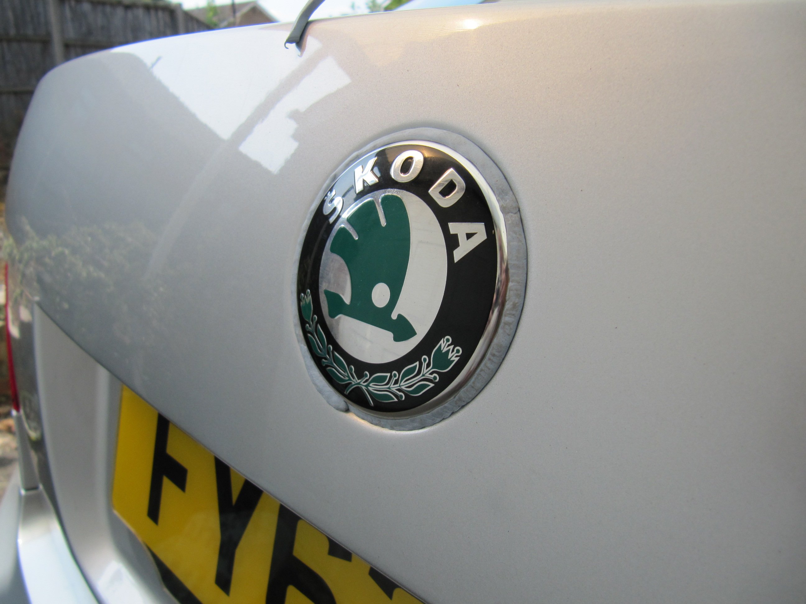

  5. I'm trying to fill the narrow gap between the badge edge and the recess with blutack just in case rain does come in here. I need to tidy up underneath.............after the car-wash yesterday I found the lid opening button underneath the badge was wet.

  7. I found the wheel well has water that is touching the lower treads of the wheel. I'll add a photo tomorrow. The rubber seal top edge was damp after the car-washand I cannot work out how. I'm sorry to here about crisund123 drilling drainholes. Before I do that I'll try to stop it getting in first. The boot lid has a circular SKODA badge above the number plate, and tomorrow i'll fill the fine gap round the outside of the badge & the recess it sits in with bluetack. I'll take snaps.
