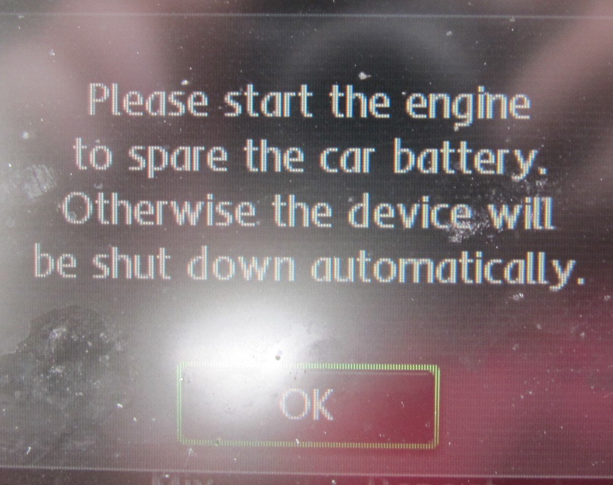

This post follows one about my cd player wanting the engine on or it will stop - then stops, after working flawlessly for 11 yrs.    It was suggested here the replacement battery hadn't been coded.    I have attached a photo if the new Yuasa battery.

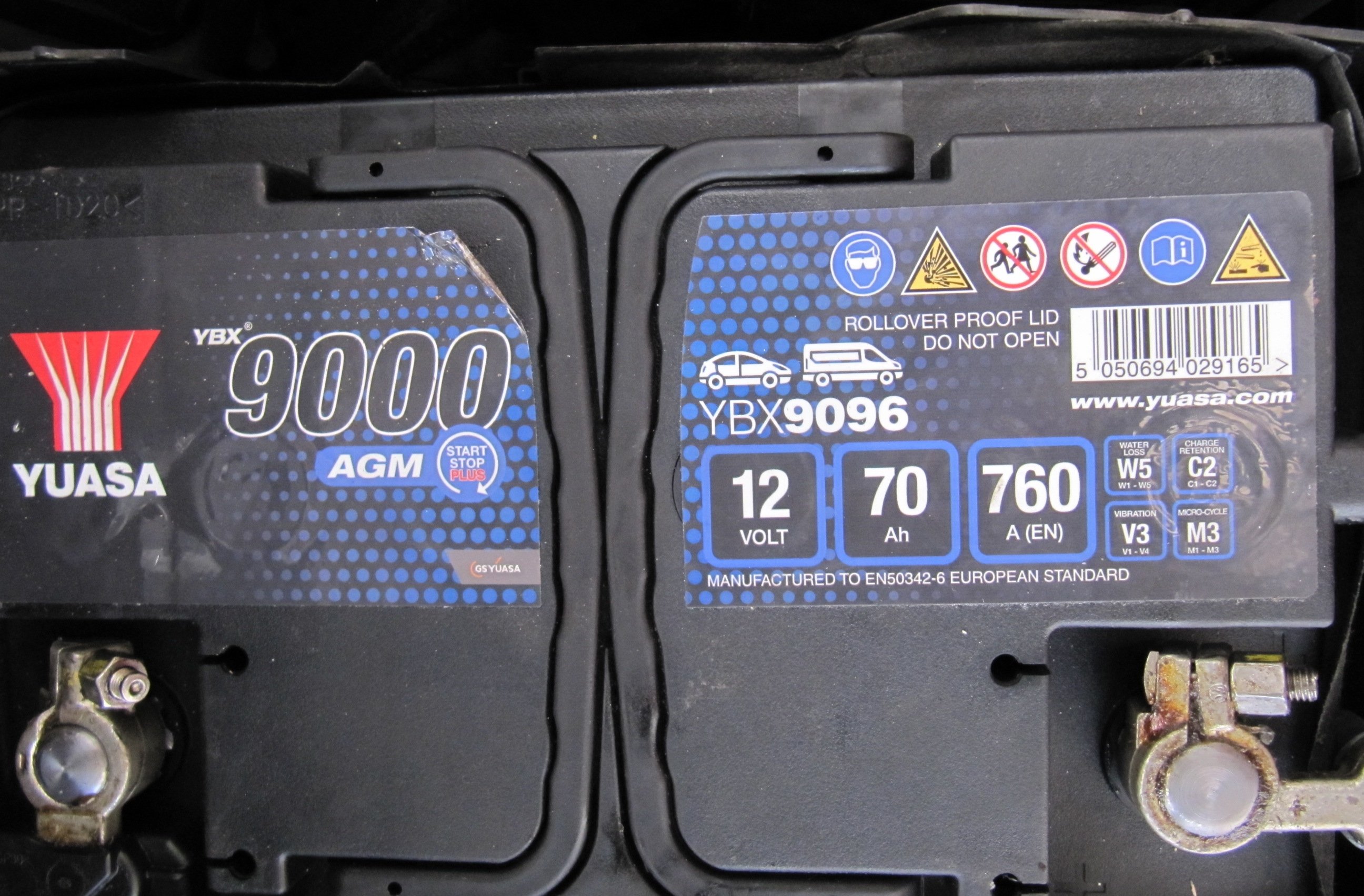

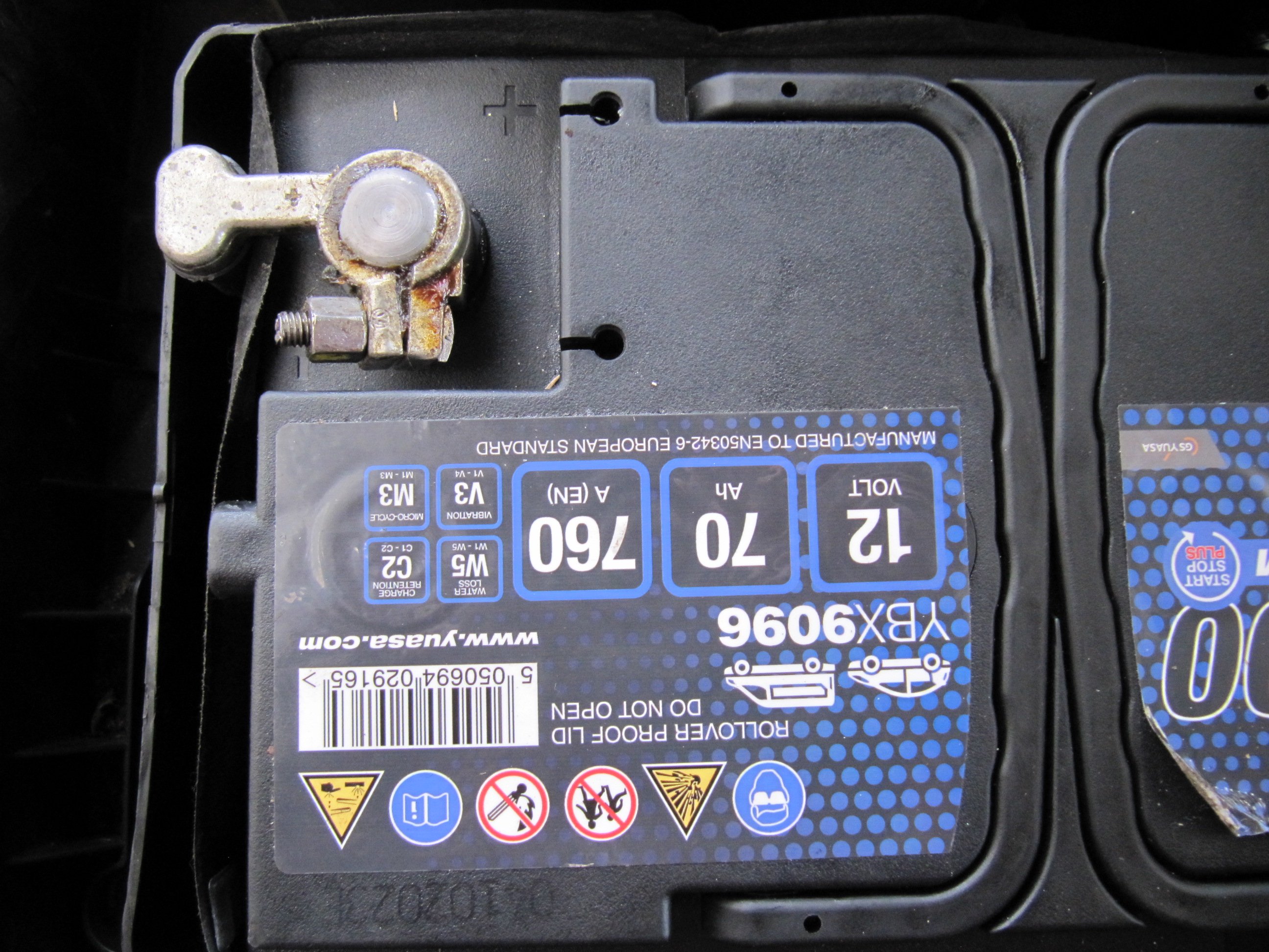

My local garage changed the original 11 yr old start stop Varta for this start stop Yuasa for £220.  However, the cd player is still malfuncting.  I went back today only to be told by  the senior mechanic that this Yuasa battery cannot be coded because it lacks the usual proper numbering & it is not an original Skoda battery.  Only original Skoda batteries can be coded & do I know how much they are ?
I said I don't care - I want a working cd player not one that shuts of & bongs all the time.it.  I suggested they fit the correct battery.  He said I'm stuck with the Yuasa & do I know how much an original Skoda barret will cost ?

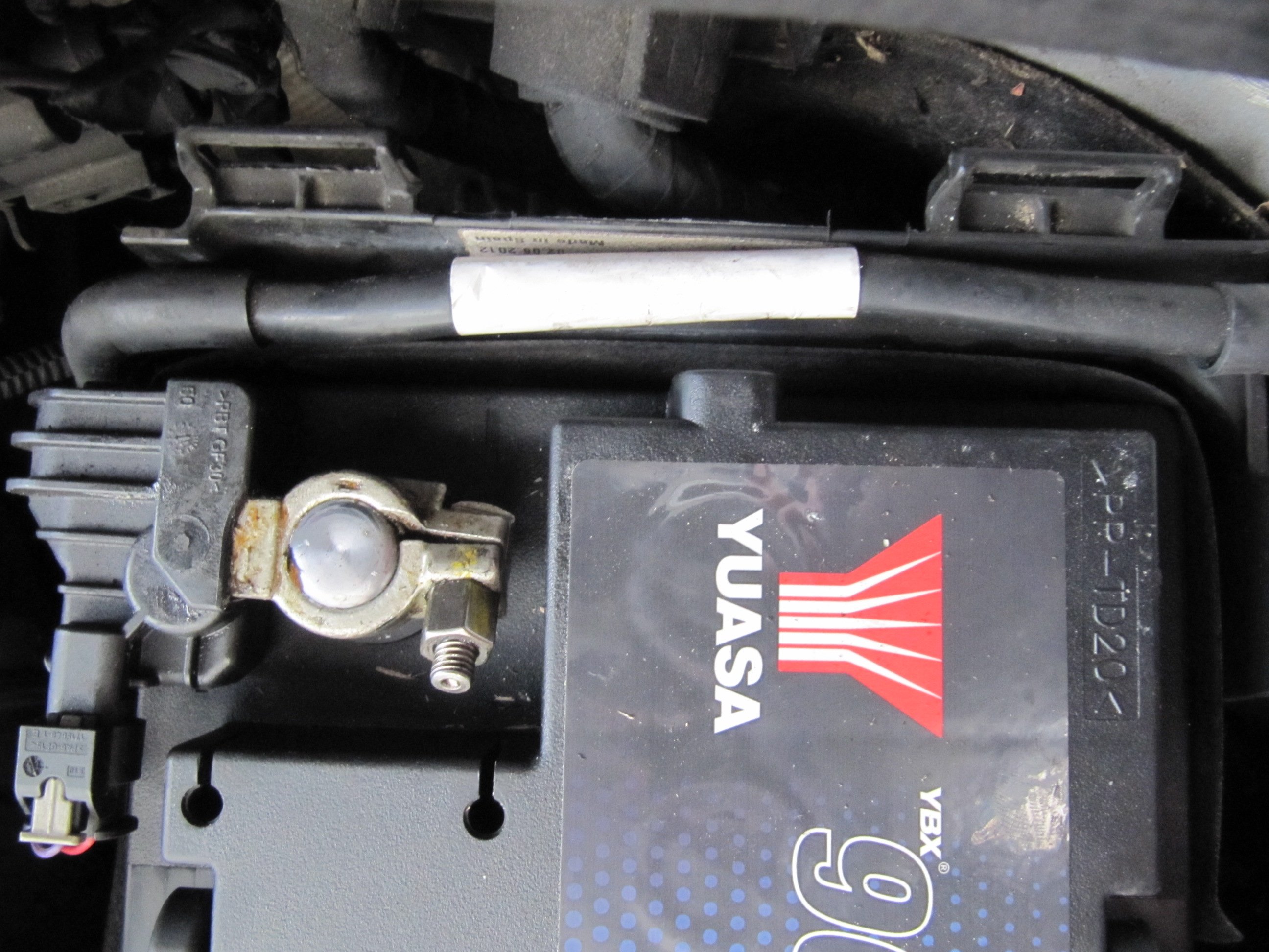

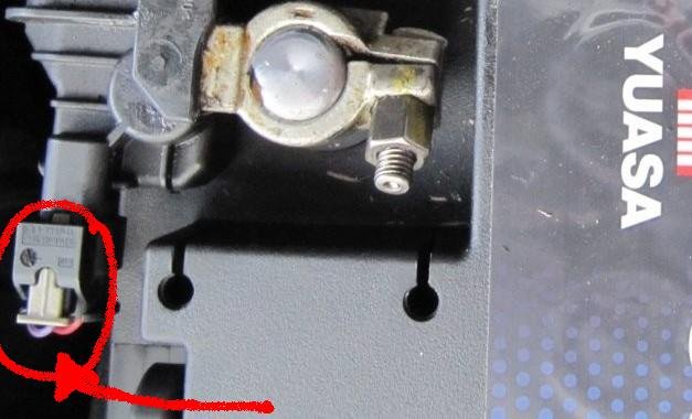

1. Its hard to tell in your picture but i cant see a current monitor on the negative terminal - in which case your car needs a normal lead-acid battery and not this AGM one.
2. An AGM battery can be coded and it doesnt have to be a genuine battery - they clearly have no idea what they are doing

4. What is the warning you talk of, do you have a photo? I assume something like "12v battery low - start engine or infotainment will switch off"
5. Have you got a more zoomed out photo of the battery, i want to see the terminals
6. If the warning is as I said in 4, then the battery needs testing, charge rate, idle voltage, resting voltage all need testing to see if its a car-wide voltage issue, or if it needs to be looked into further for a localised voltage issue such as a poor ground.

So it has start/stop, therefore it probably had an AGM or EFB battery as original equipment

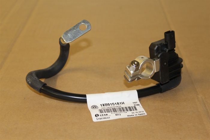

I think I can just about see it. This is what it should look like.

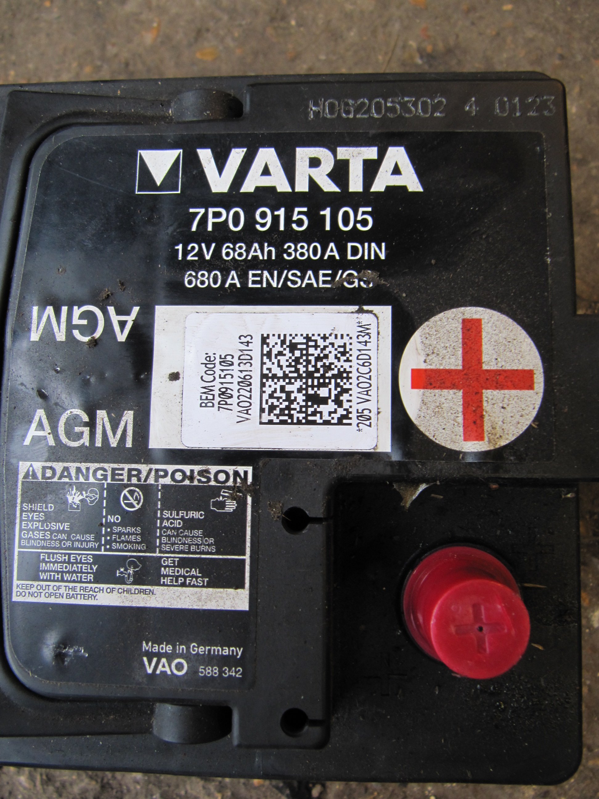

ApertureS = Original was a AGM - see attachment.  An email from Yuasa has just arrived which says "Just get the code from the old battery and change the last couple of characters (so the code is unique). This will be enough to reset the system."  Warrior193 said this previosly in his answer to me.  I will get this done when I find someone with the necessary kit.
The warning I've mentioned.  Zoomed out picture attached.

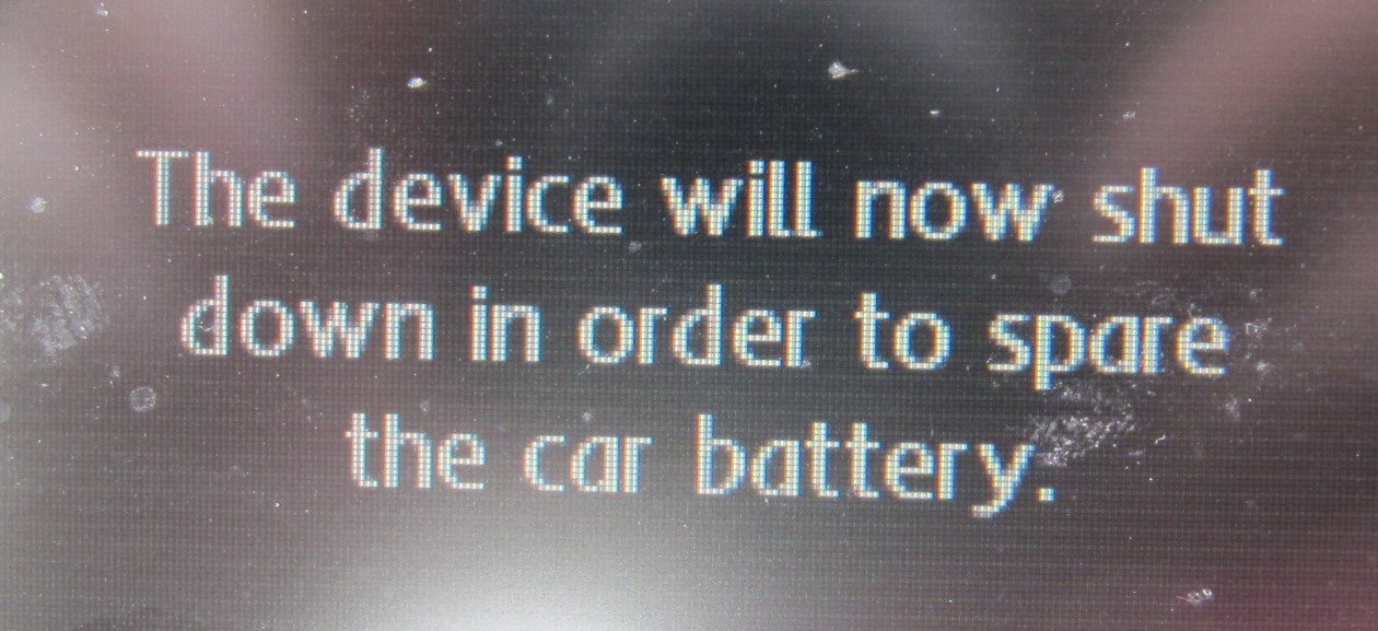

Bolero warning:    Right now it lasts for 30 seconds then closedown appears for 20 seconds before it closes down.    I came across in a related topic here - the Carista coding tool company.  I gather it comes with software & instructions.  I've asked for a quote for a tool to do the Octavia seeing that VW & Skoda loclly are making such a meal of  what on video takes 10 minutes......my fingers are crossed.  It could be cheaper than the £105 Skoda & £84 VW want........

Afaik if you disconnect the current sensor (located on the negative battery terminal) then the alternator will revert to standard non smart charging. So you could try running like that and seeing if the CD player issue is fixed.
