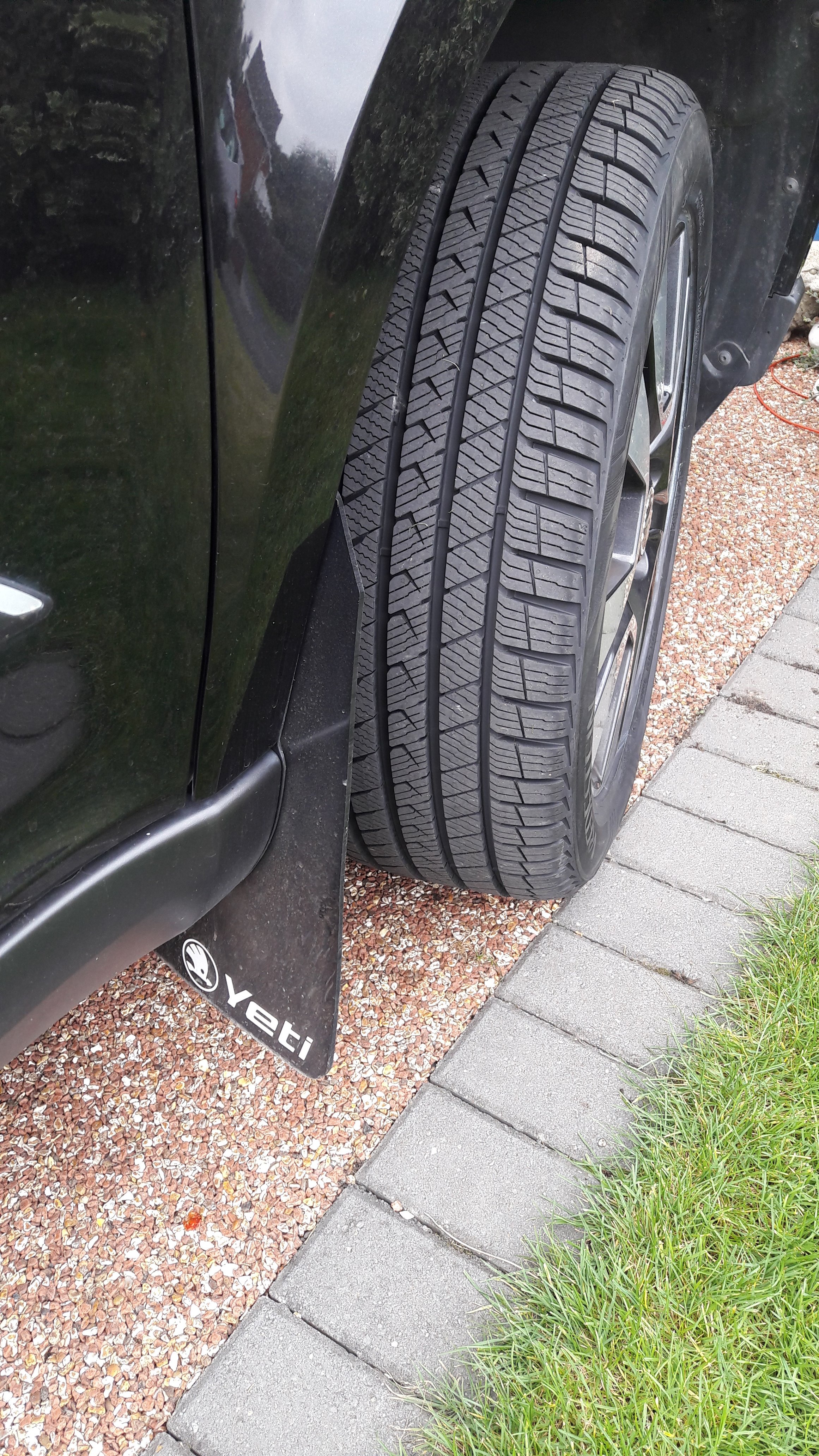

Took me a little while to get there but finally sorted this morning with 4 x Vredestein Quatrac Pro purchased on Black Circles and fitted at ATS. Thanks for the information all. Looks like I timed it right to buy them too. They have gone up almost £23 each now!

My 2016 2.0 diesel L&K 4x4 is coming close to needing a couple of tyres. Currently running Goodyear Efficient Grips which have been pretty good to be fair. I travel on a good mix of roads, including some gravel tracks and we do get a bit of snow here. Also tow a caravan all year round. I've been mulling over a change to all seasons and I know the best advice is to have them all round. Seems everyone loves Michelin Cross Climates but W rated ones are rather costly! Local dealer did suggest I could drop to V rated, but I'm not sure that is correct. Anyone know for certain? Not looking to change wheels to accommodate Winters so come on folks what do I do? Stick with the Goodyears or any suggestions for 225/50/17 W all seasons much appreciated. I confess I'm struggling to make a decision 🙄
