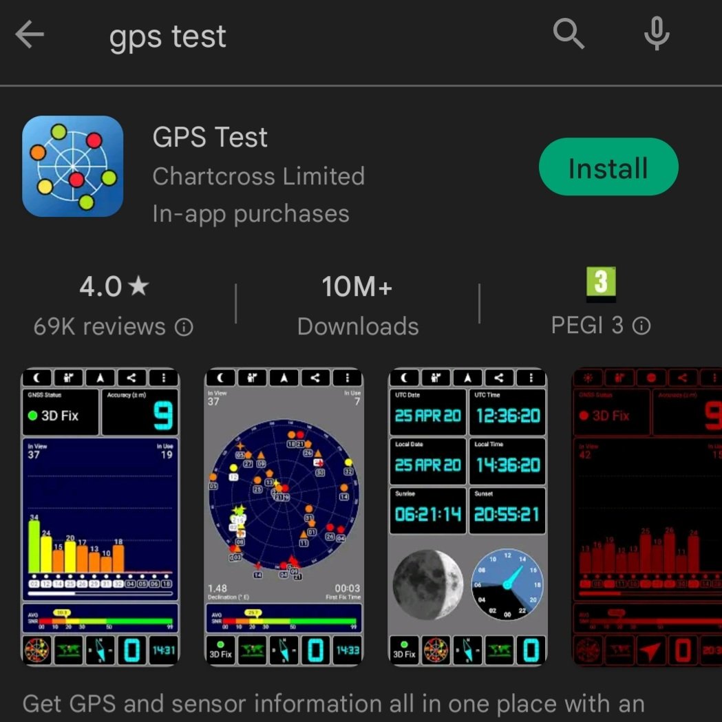

  9. I have had lost of gps a couple of times whilst using Waze but it either sorts itself out in its own or I just restart Waze. Usually it is a satellite problem as far as I am concerned. I have this installed just to check GPS if needed
