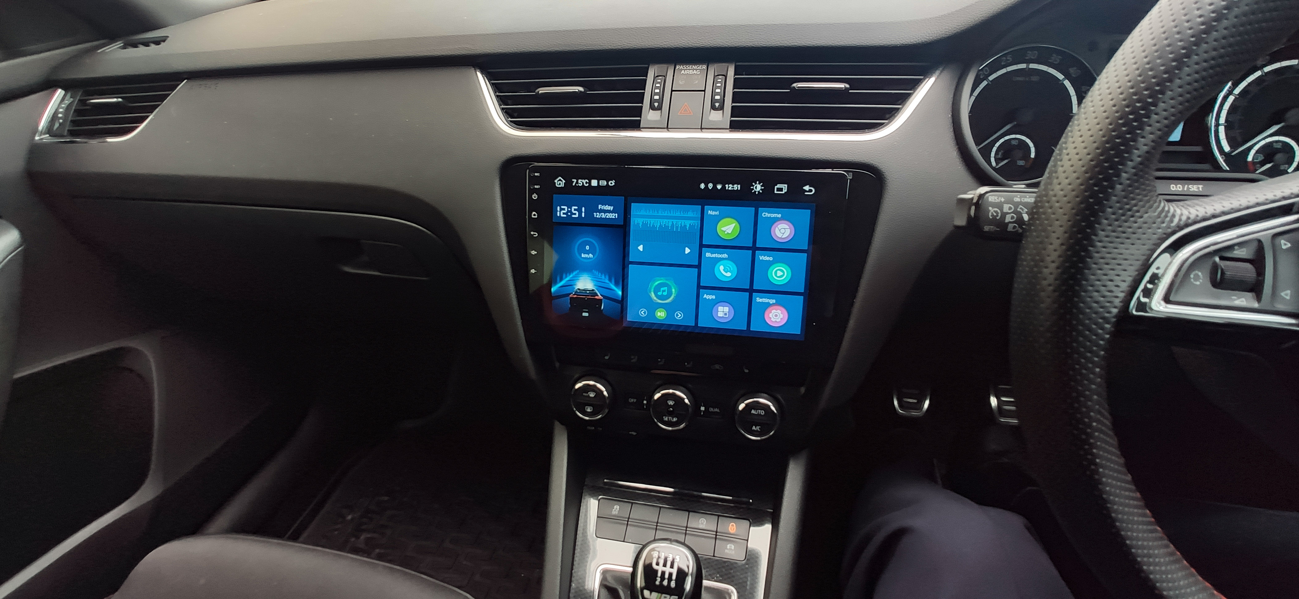

Small update as have now gone back in and put a generic external microphone in place. I opted not to put it behind the trim where factory one is as it's blanked off on driver side and didn't think it would work too well being essentially in a lunchbox (cable routed up directly into head lining behind mics boom so out of sight, across and down behind passenger pillar trim in and across etc. 3 meter cable on mic was perfect with about 20cm to spare (was slightly worried). As everything is black up top I just stuck it on its swivel mount on top of rear view mirror and it's working perfectly on test call after.
Also had a play in menus and found a big list of boot screen logos to choose from inc a Skoda one, but can also upload anything I want, so will get a newer Skoda logo I think or a vRS one or something. Then I noticed the menu for steering wheel controls and I can remap any key function to do whatever I want it to, that's pretty nifty.
