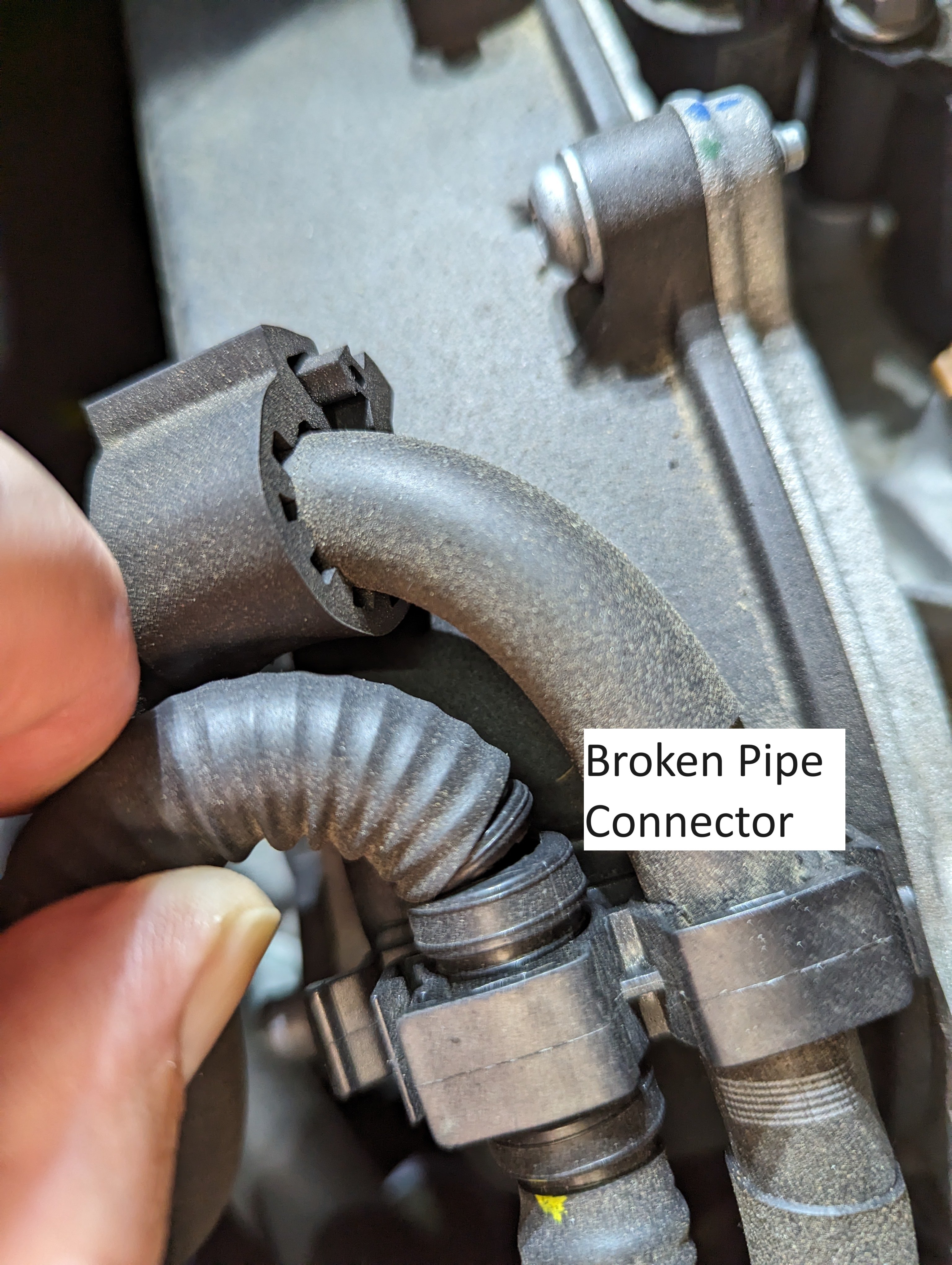

  21. Hi, I have a 2020 1.5 TSI mk4 Octavia. I too have to wait a few moments after cold starting until the revs drop to 900 rpm (Otherwise the car kangaroos). Regarding the noise, it could be a hole or break in a plastic pipe connector(s) in the EVAP system, which is located under the plastic engine cover. It is a recognised fault by Skoda and mine started at about 4 years and 55,000 miles - BTW this has no effect upon cold start kangarooing! Good luck!
