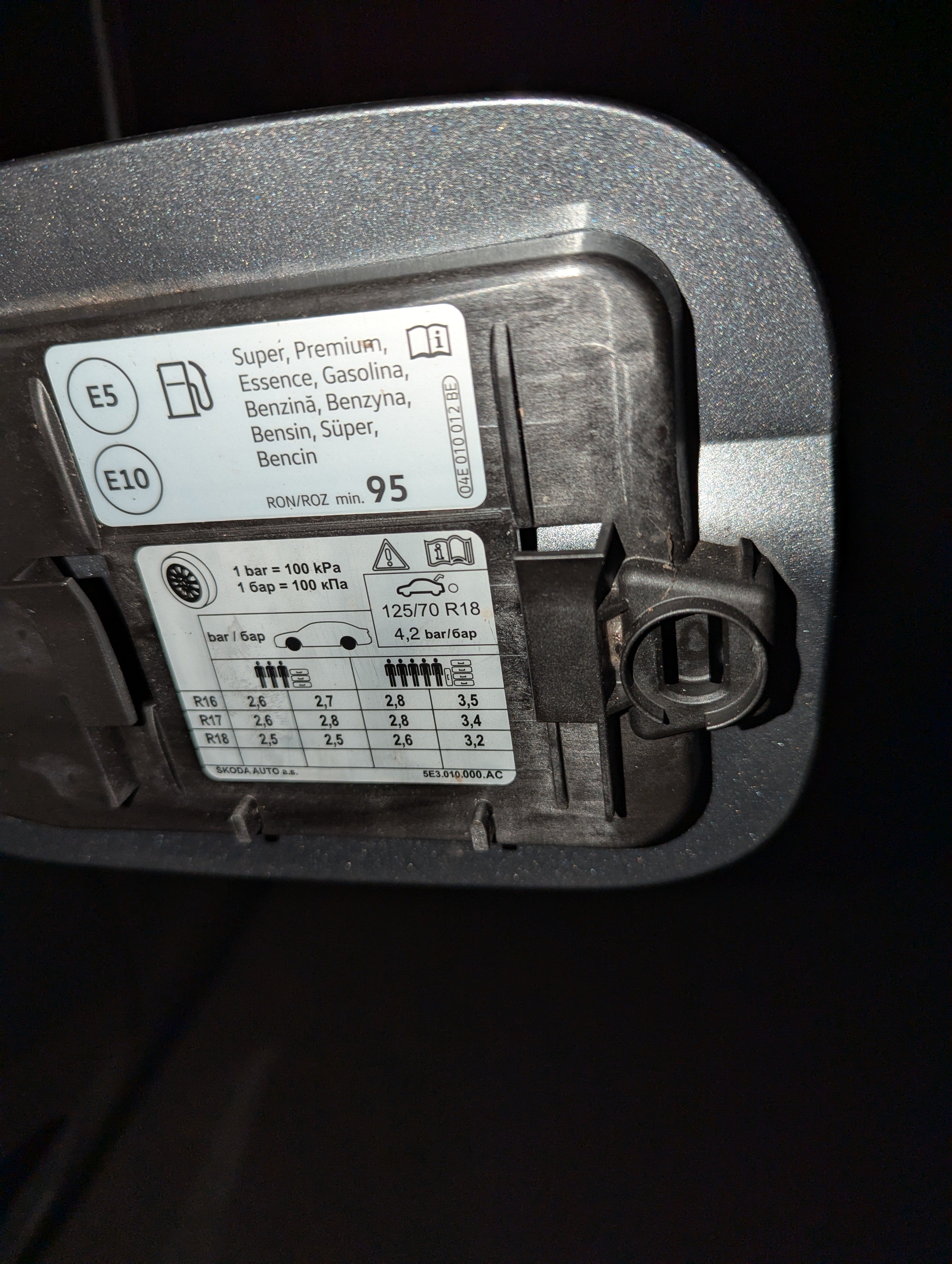

  5. Hi again, no I bought an early 2024 model pre facelift. Cheers, Alan

  7. Hi, it sounds a little like relays clicking? as above, perhaps related to charge/ discharge cycles of the 48V battery related? I have a 24 plate e-Tec MHEV which does not make any such noises - Worth a word with the Dealer I think! BTW, if you don't mind my asking, what tyre pressures do you run please? I am using those stated on the Fuel Flap (2.6 front, 2.8 rear) which seems to result in a harsh ride?

  9. Thanks to everyone who has responded thus far. I have reduced the tyres to 2.2 Bar all round - A brief drive around the City and then A483 has yielded a much mor compliant ride, it seems more stable over the lumps and bumps around here and still returning 57 ish to the gallon around town. Kind regards Alan
  10. Hi PetrolDave, as far as I can find out (I have PDFs of the manuals) then the MK3 Diesel was the heaviest at 1322 kg, the MkIV E-Tec weighs in at 1313 kg and the MkIV I previously owned is 1268 kg Operating Weight. So, yes, the E-Tec seems to weigh approx. 45 kg more than the standard 1.5 TSI, but the Mk3 is 9 kg heavier still! I ran both the Mk3 and my previous MkIV at 2.2 Bar all round with no apparent detriment to the Tyres (The fronts had covered 48,000 miles and were still legal when I part exchanged the car for my current model
  11. Hi and thanks for your input, my Diesel Octy had the same wheel and tyre size as my current one, namely 205 R55 17. I will try dropping the pressure - the roads in North Wales are full of uneven tarmac repairs and potholes!
  12. Hi and thanks for your swift response to my question. I suppose I am worried about the legality of driving on pressures lower than those on the fuel flap?
  13. Hi I have recently purchased an early 2024 mk4 Octavia 1.5 TSi SEL e-tec and find that the recommended tyre pressures seem too high? 2.6 Bar front and 2.8 Bar rear lightly loaded (According to the fuel flap). (205/55VR17 MICHELIN Cross Climate 2) Bearing in mind my mk3 Diesel Octavia was somewhat heavier but ran 2.2 Bar all round! Driving with these pressures result in a very harsh ride indeed, the car feels 'Bouncy' over rough tarmac. I was wondering if anyone out there had decided to lower their tyre pressures accordingly please? Kind regards Alan
