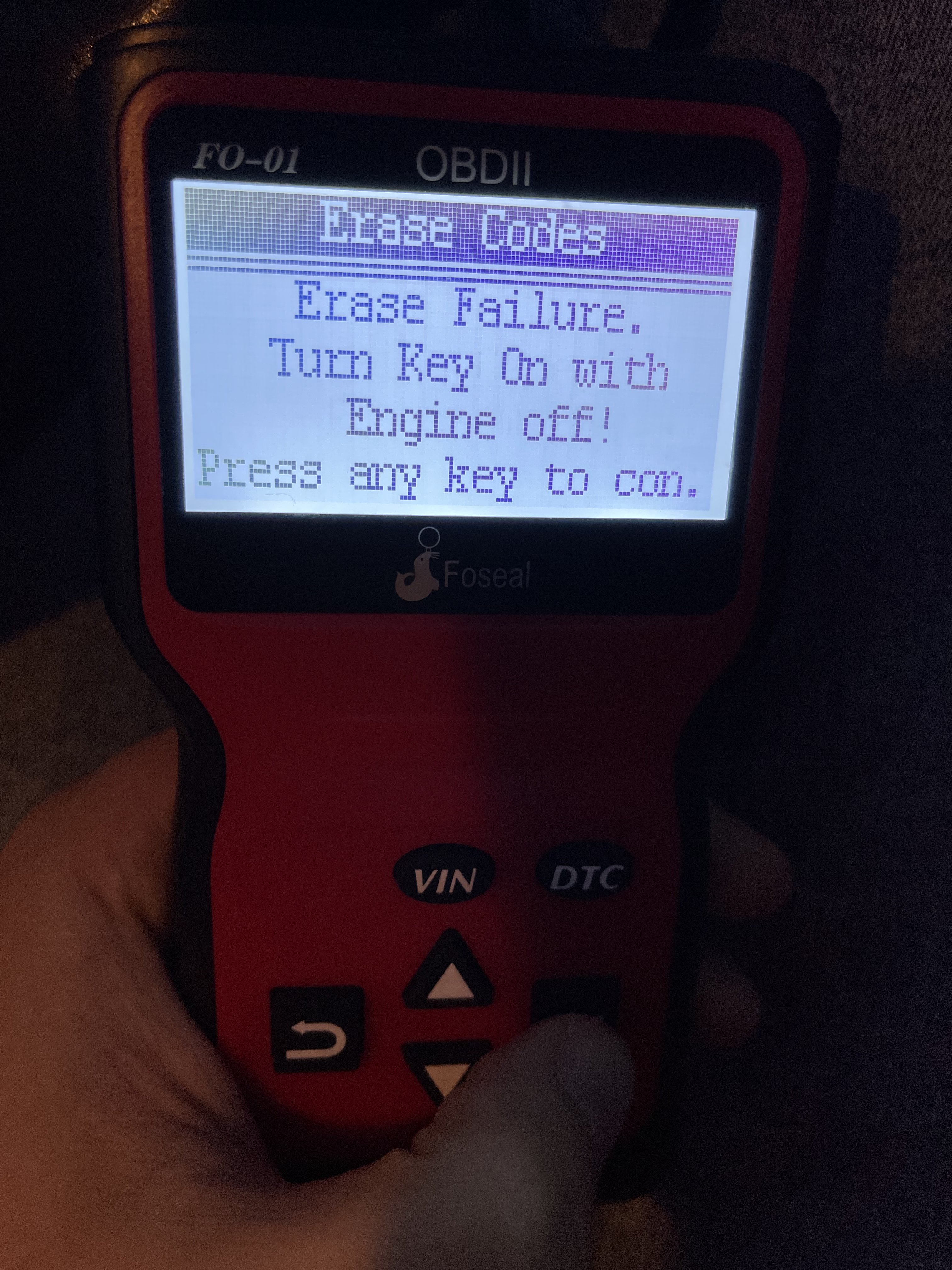

  2. Does anybody know why I cant erase the codes? The car is in ignition and the engine is off..
  3. I just ordered the car code reader from Amazon to delete the error. In the next couple of days when my tank is almost empty, I will put the DPF cleaner, fill tank with Shell V Power and drive on the motorway on second and third gear at around 4000rpm. Also will do couple of accelerations from a junction and see if there is any improvement! will even see if the oil temp goes above 80 degrees
