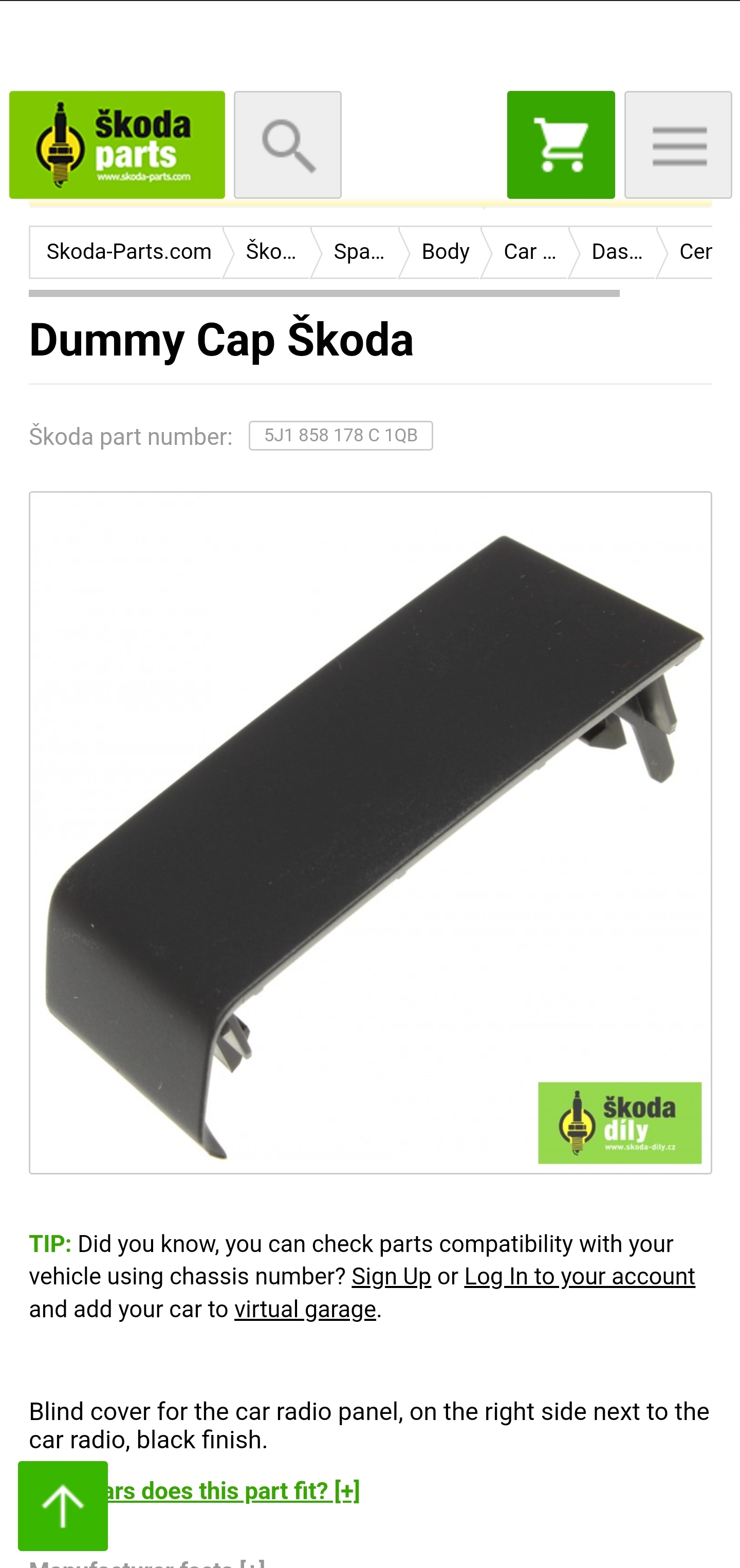

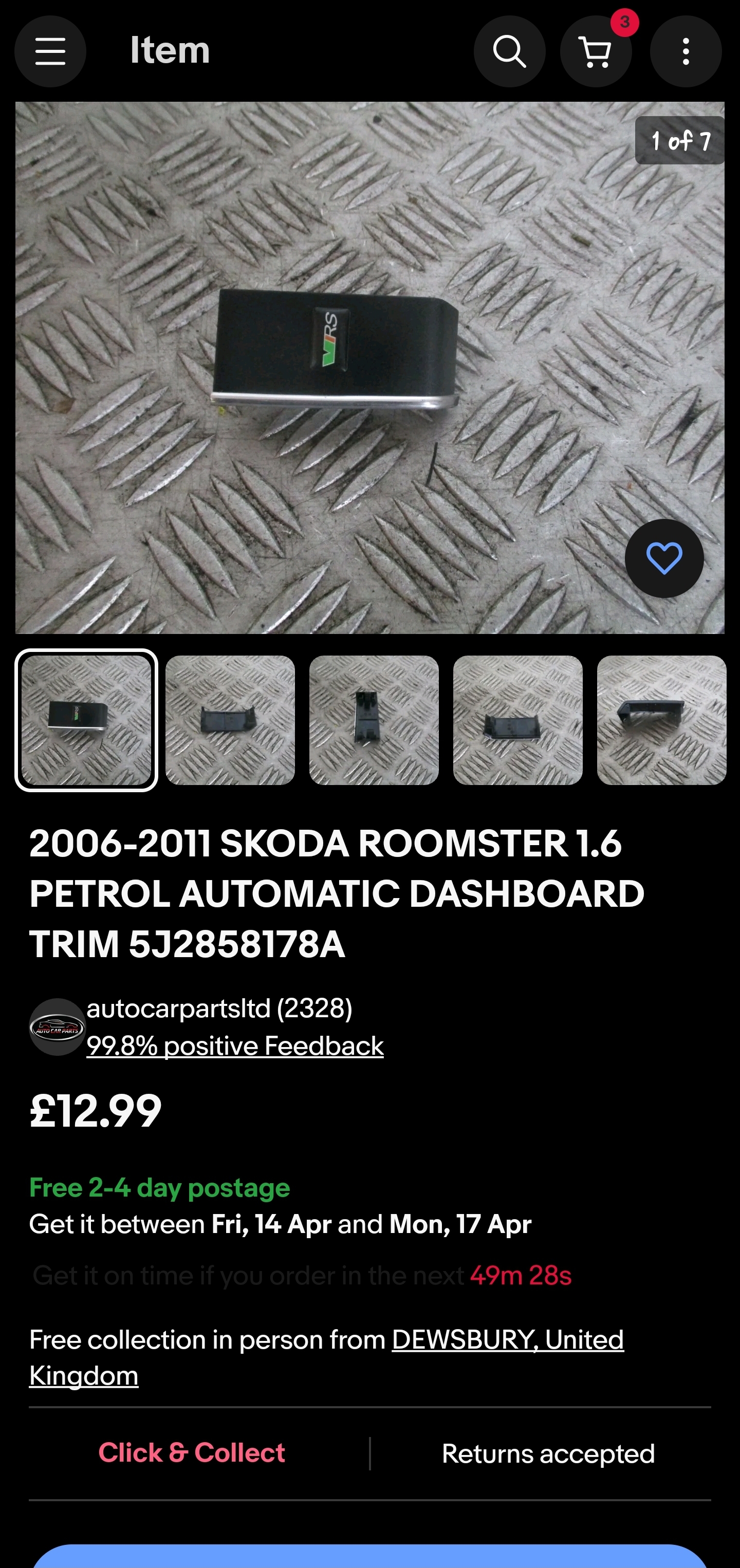

I've not checked with main dealer, I'd guess it'll be around £20 ish. It cost me £50 for genuine center caps for my wheels. Here is the left hand blanker from the same breaker on ebay. Thay has a vrs badge with the aluminium strip
Thanks for getting back, I found one on ebay eventually. It was from a vrs so has the aluminium strip on one side. So I'll probably end up taking that off

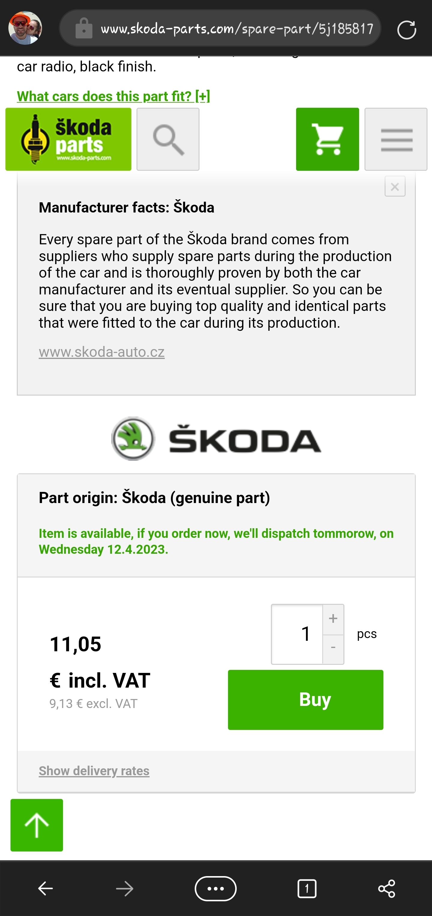

@Murdockman see the pictures I've attached. They only seem to sell blankers not ones with holes in. Price is only €11 aswell

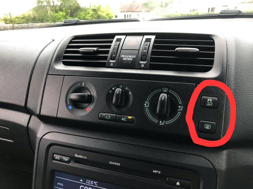

Ummm I think £91 plus delivery is extremely over priced for a simple piece of plastic 1" x 3". I'll give that a miss I think. Are you taking about the same panel I've circled in the picture?
Hi all, I've looked everywhere online, I'm trying to find a specific dash panel as I need a new one. The panel I need is the rear demister panel with 2 cutouts. I've looked on ebay but no luck. If someone knows the part number maybe that would locate one for sale on ebay. Trying to avoid main dealer prices Cheers See pic to info.

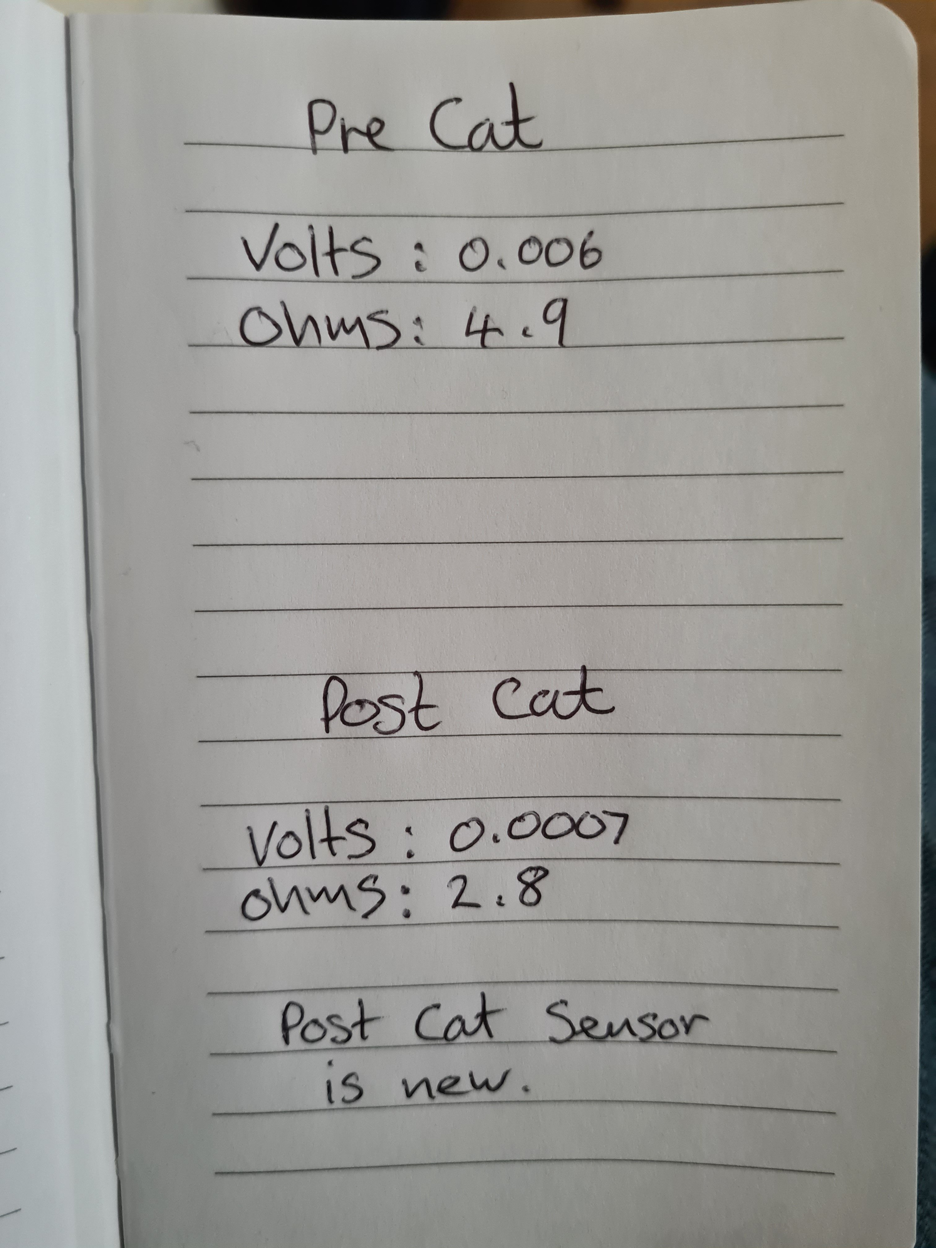

Volts look extremely low on both sensors and ohms should be around 7.0?

Hi, Thanks for your responses. I've cleared the codes for now but out of interest take a look at the live data I'm getting on the O2 sensors in the videos I took. Thanks 20230219_091233 (1).mp4
Hi all, I've seen so many forum posts about this issue but every one gives a different answer. The car involved isn't a VAG group car but the issue seems to occur in vag cars too. The issue is this, one day I was driving my partners C1 and all of a sudden the tyre pressure warning light, the esc light and engine management light all come on at the same time for no apparent reason. Scanned the ecu on my generic scanner and it showed a P0137 and P0139 codes. Both codes are oxygen sensor based codes. Bank 1 sensor 1 gives slow response. First thing I did was put a rear oxygen sensor on and reset the light. About 30 mins into driving all 3 lights come on again. Lots of other forums suggest it's a wheel sensor or a dodgy wheel bearing. But I'm not convinced. I will test the sensor tomorrow once I have the car warmed up just to eliminate it. Tyre pressures are all fine. Any suggestions as to what else to look out for? Thanks
