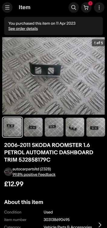

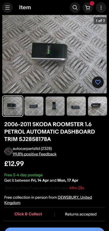

  4. I've not checked with main dealer, I'd guess it'll be around £20 ish. It cost me £50 for genuine center caps for my wheels. Here is the left hand blanker from the same breaker on ebay. Thay has a vrs badge with the aluminium strip
  5. Thanks for getting back, I found one on ebay eventually. It was from a vrs so has the aluminium strip on one side. So I'll probably end up taking that off

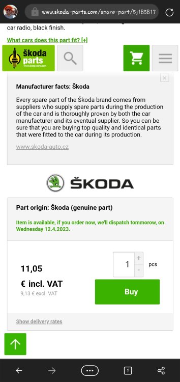

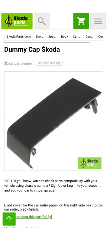

  6. @Murdockman see the pictures I've attached. They only seem to sell blankers not ones with holes in. Price is only €11 aswell
  7. Ummm I think £91 plus delivery is extremely over priced for a simple piece of plastic 1" x 3". I'll give that a miss I think. Are you taking about the same panel I've circled in the picture?
