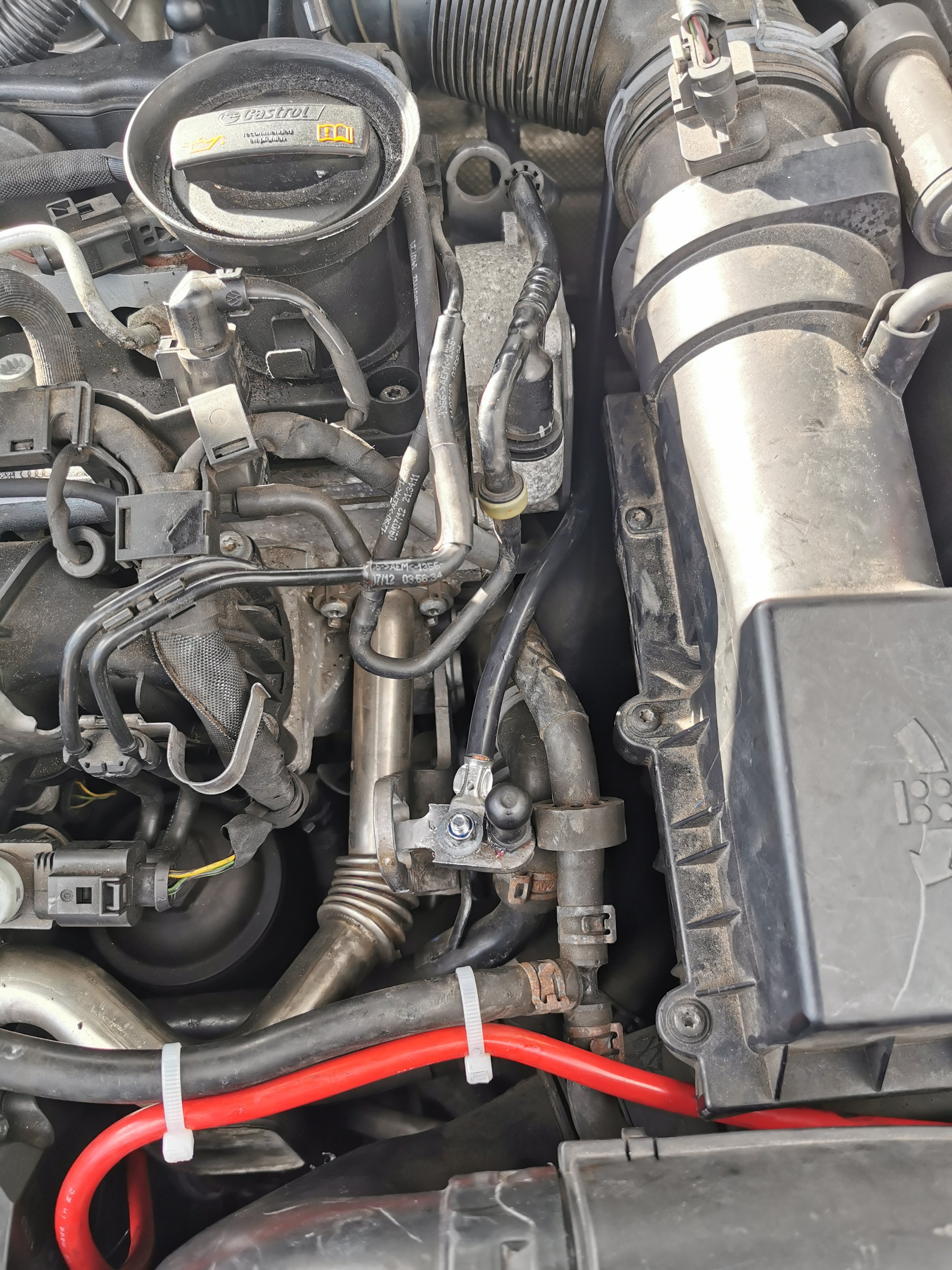

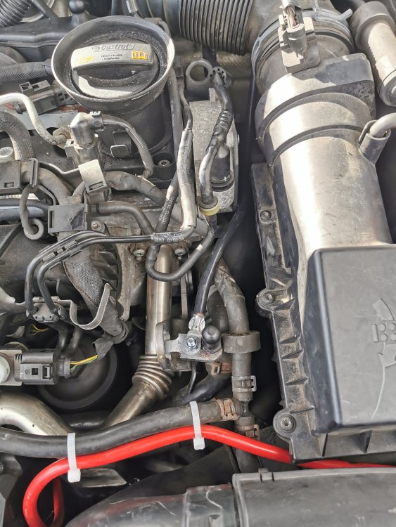

  15. Fixed my charging. Used new, extra 170A cable. One side fixed to frame where a rubber bush for the plastic lid is (see picture) and another end straight to battery. Charging from 13.2v jumped to 14.5v. With full load 14.1v. Brilliant. Love you guys.
  16. Hello! May I know on what cable you purchased and where exactly you bolted this in? Thanks
