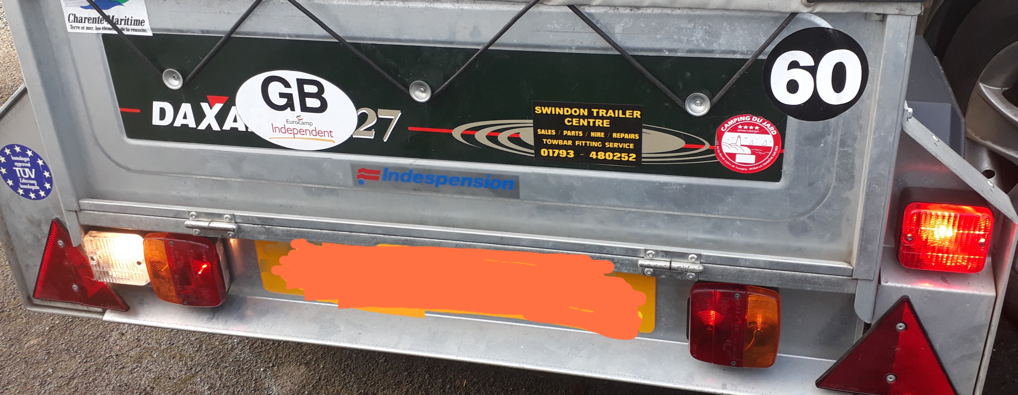

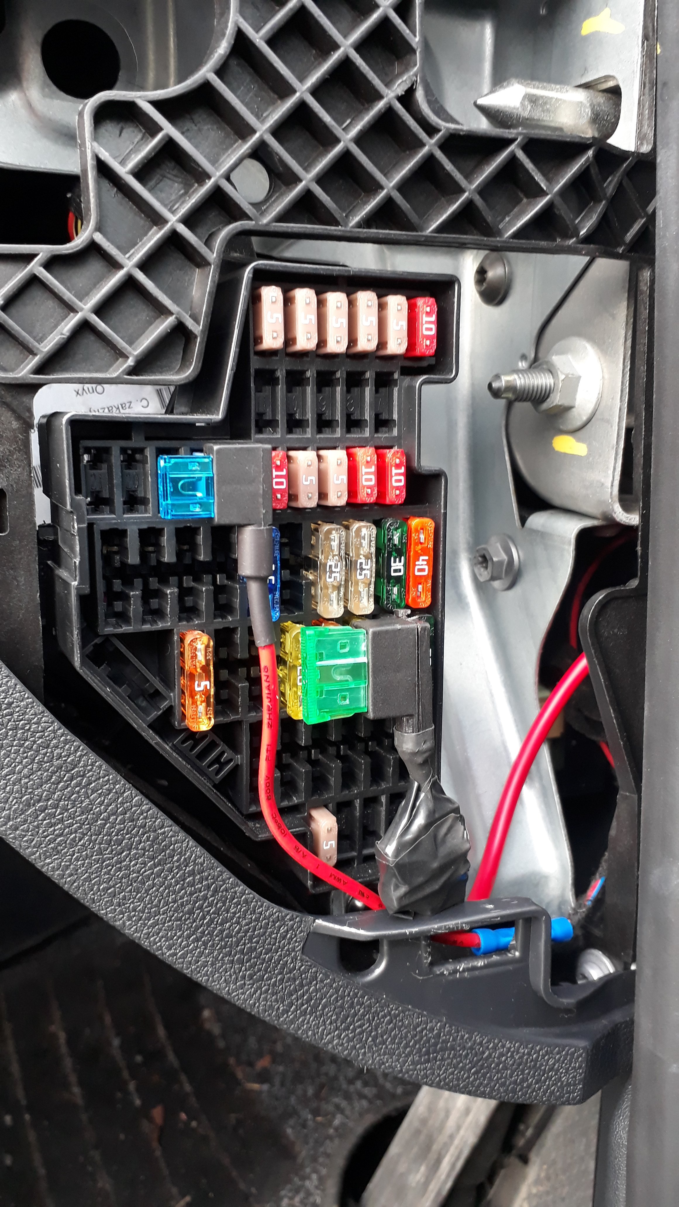

So I got the large piggyback fuse thing and found a spare slot on a bus bar that is perminantly live. I think its the bus bar with the cigarette lighter. Using a spare slot meant I didn't have to muck around with another fuse, but the piggyback thing meant I didn't have to put the cable into the back of the fuse box. Made the job much easier. I have disconnected it again because of battery drain though. Oh and as for the other bypass unit, the second one I got, I think it's faulty, as I tried it on an older simpler car that doesn't have shared tail light wiring. The tails still didn't work. Never mind I have still saved money over having a tow bar company do the job. I have even fitted a reverse light on my trailer. See picture. So a productive day. Oh and thanks for the help from everyone that did.

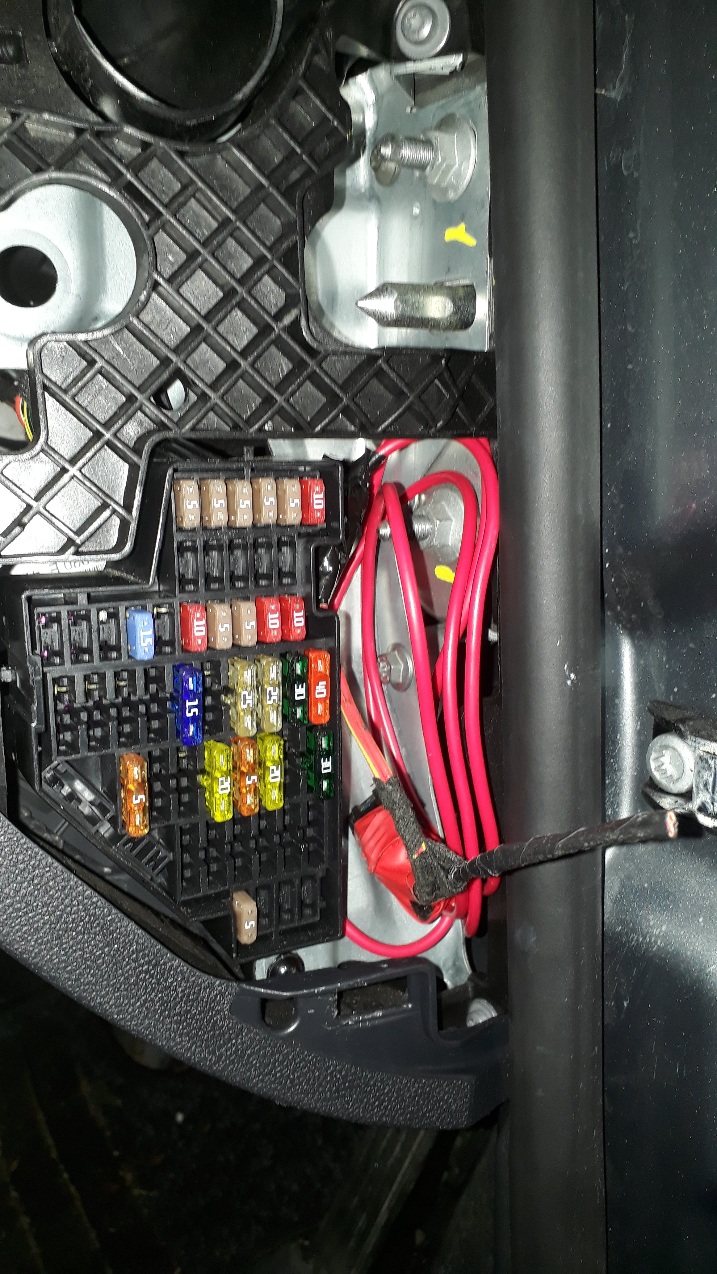

Hi an update, I managed to get all the lights working with the first 7 way bypass unit, I then tried with the second and all but the tail lights worked. So I used the first unit. I also got a cable from the back of the car to the front to allow the other caravan power options, battery charging, fridge, internal lights ect. I still don't know how to go about connecting that to the 12v supply behind the fuse box, to get a clean unfused supply thats powerful enough. I would like some advice about how best to proceed with that. I have included a picture of where Im at with it, there are two inline fuses in parallel 15 amp each totalling 30amp.
