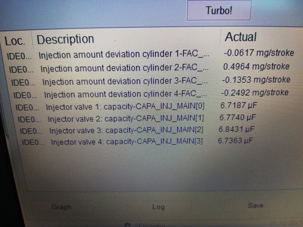

  5. Here's my readings, would this imply injector one, any help would be great. Darkside are near me aswell
  6. It will be an injector in its way out, mines doing the exact same mate

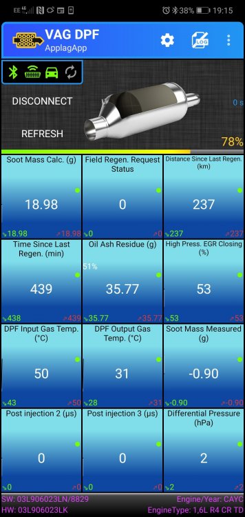

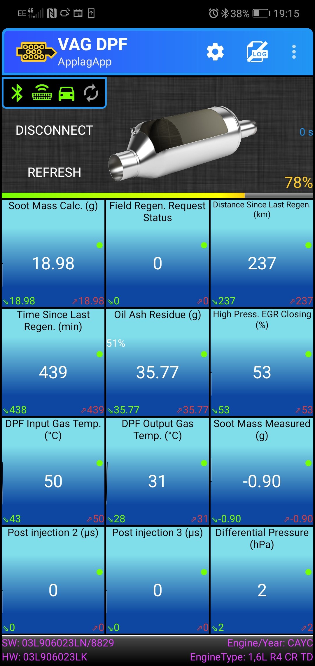

  8. Whats this telling me it says 78% at the top

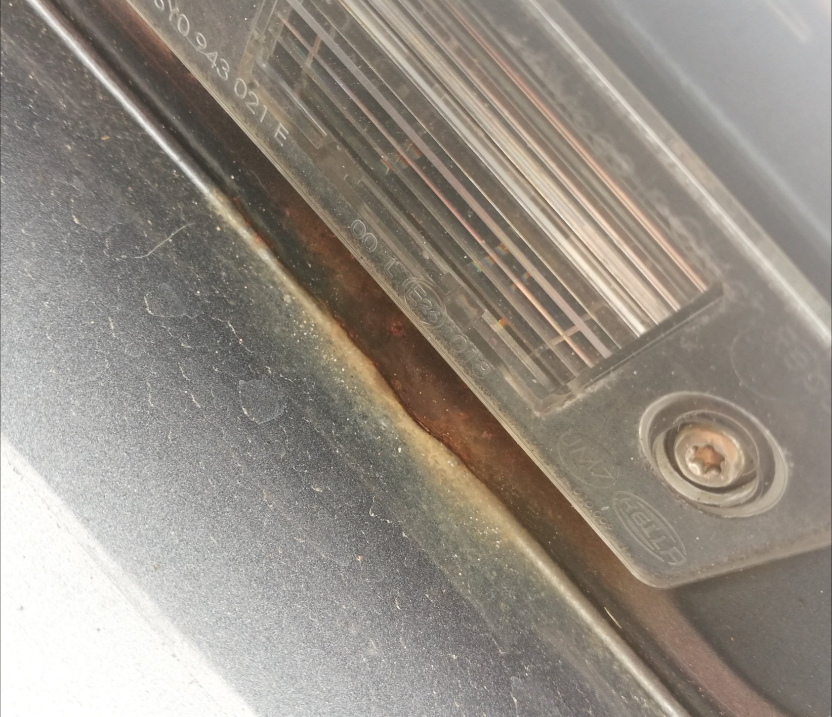

  9. After spending 20 mins at the dealer he measured the paint and took snaps of the car and stamped up service history. He said its very very hard to get them to honour stuff anymore but it looking like the rubber gasket between the reg plate light has had trapped moisture causing it to rot from the inside. His, my case has to go to skoda uk but also might have to be stripped down for a better look. He said it would probably be a full new boot lid.
  10. Im down there at 330 mate, ive got full service history but the paint schedule hasnt been done since 2015, bet they slide out if it by this
  11. Thank you this will help me tomorrow. Im told they replaced the screwed in type lights for plastic ones to stop this

  14. Brill ill pop down tomorrow and see what they say

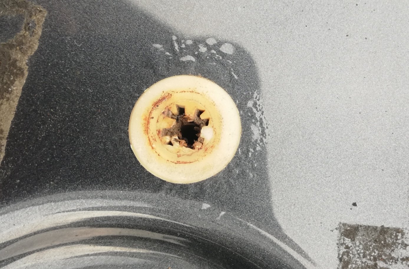

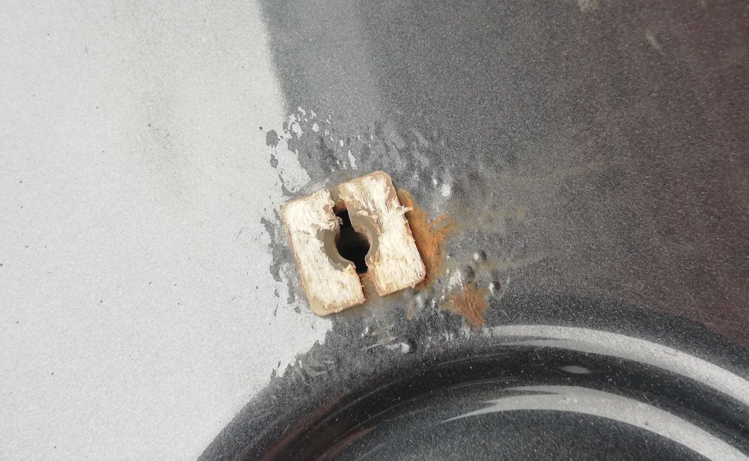

  17. Hi ive just bought a 2011 monte carlo and took the rear reg number off to change my plate over and noticed rust starting, its near the reg plate light and all around where the plate screws on. Anyone else had this
