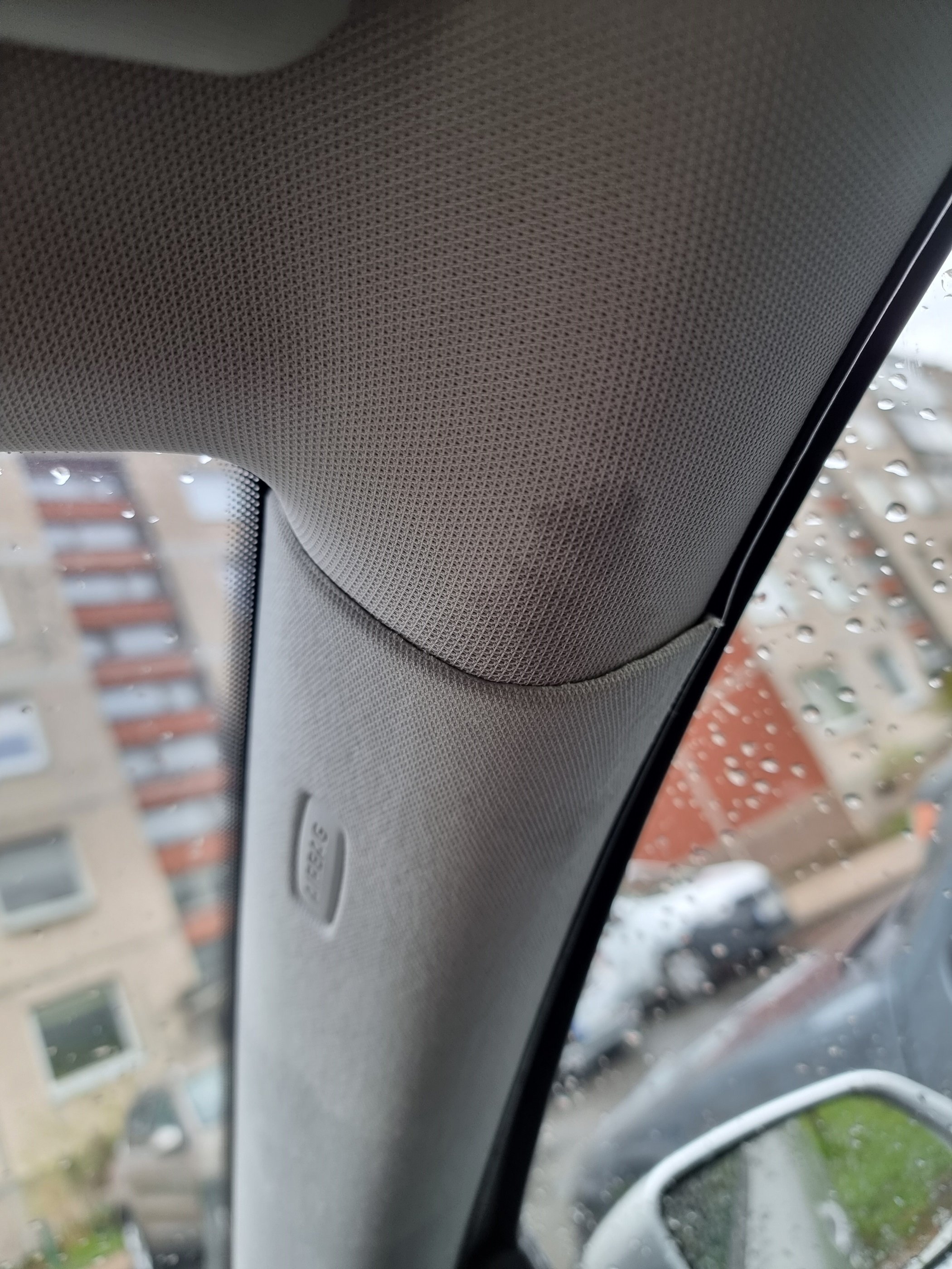

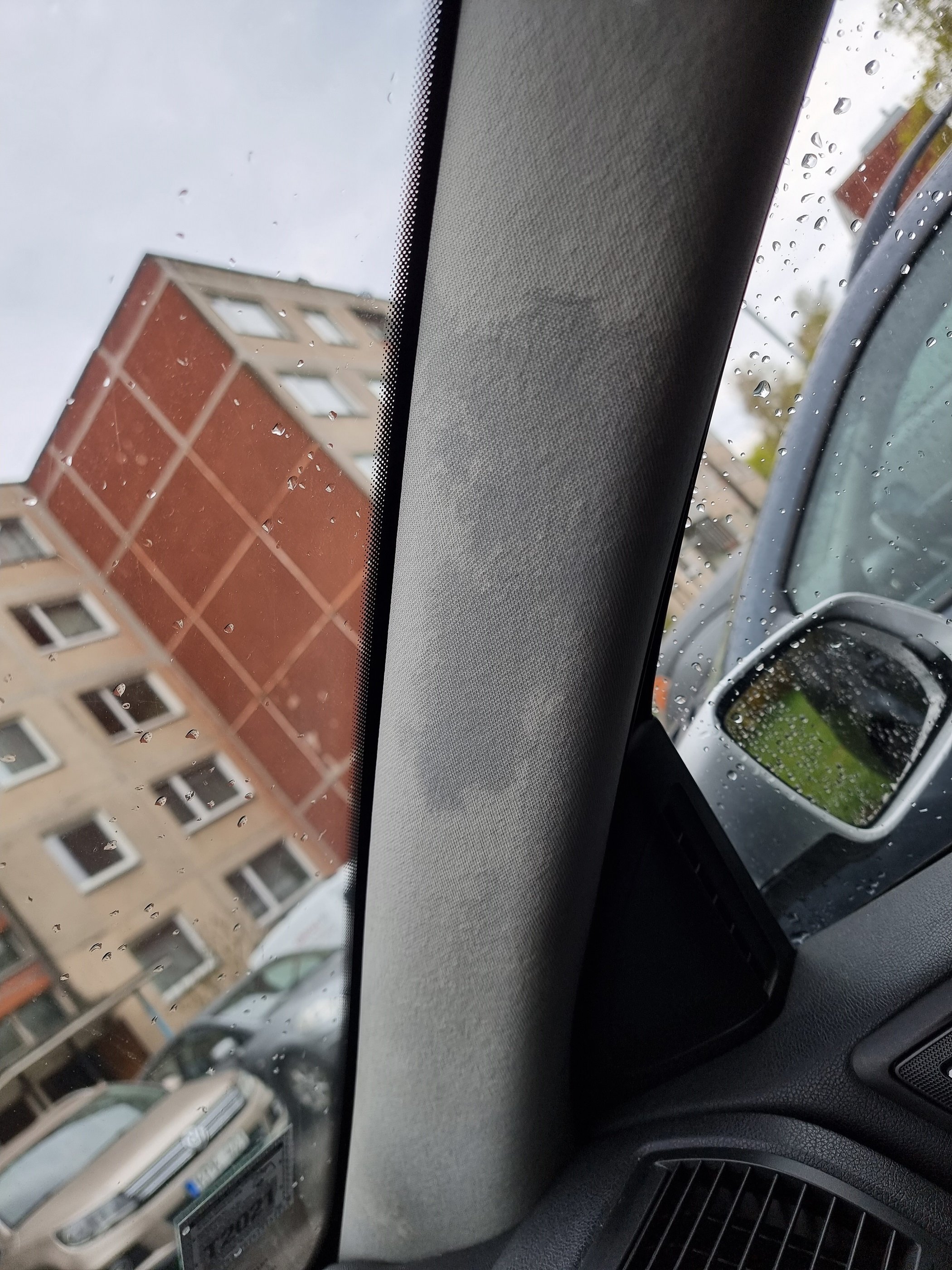

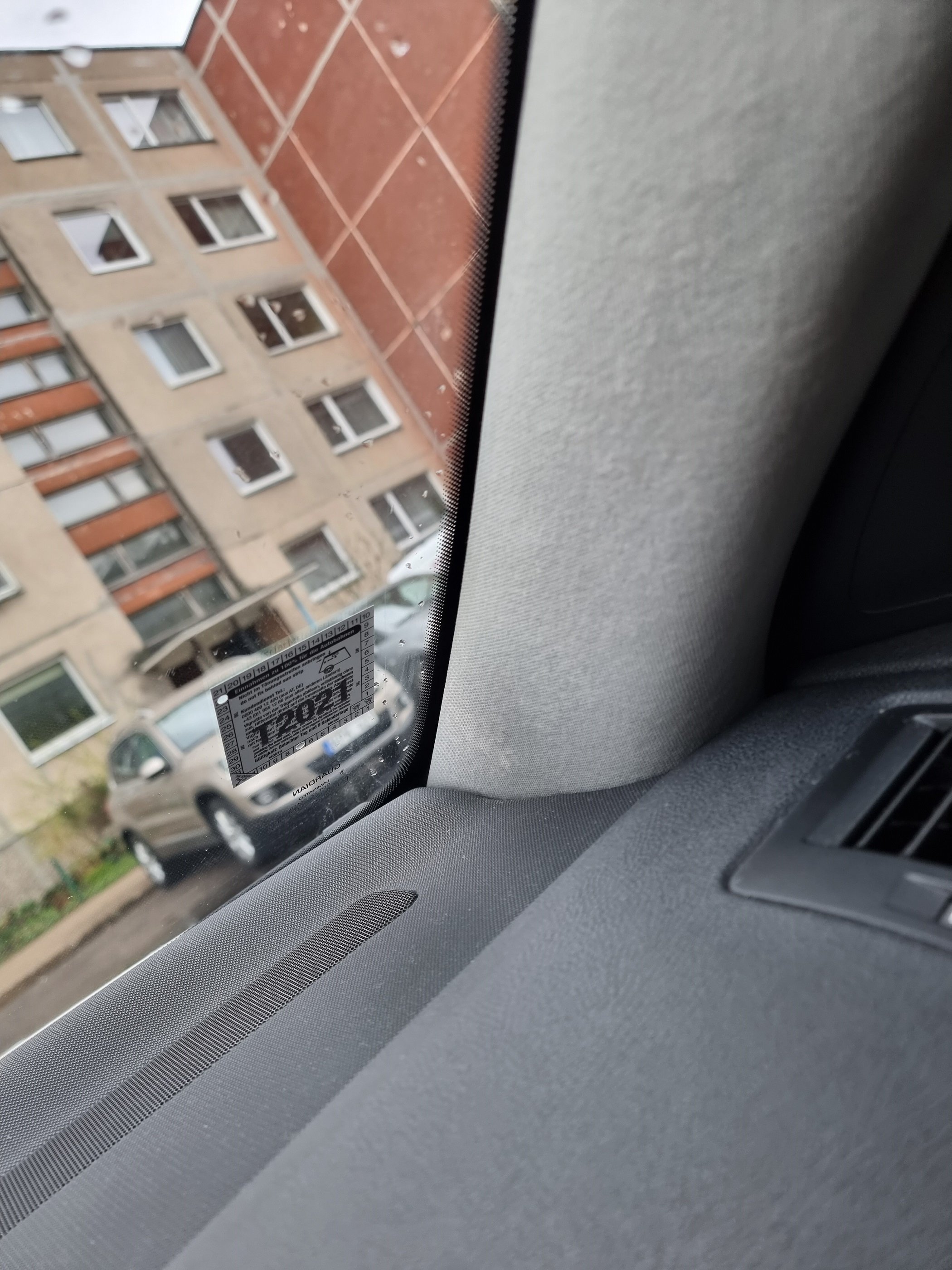

  10. Hello, So after a rain i got some leakage on the pillar. Car is without sunroof.. Any ideas from there this leak could be? Can it be a front window?
