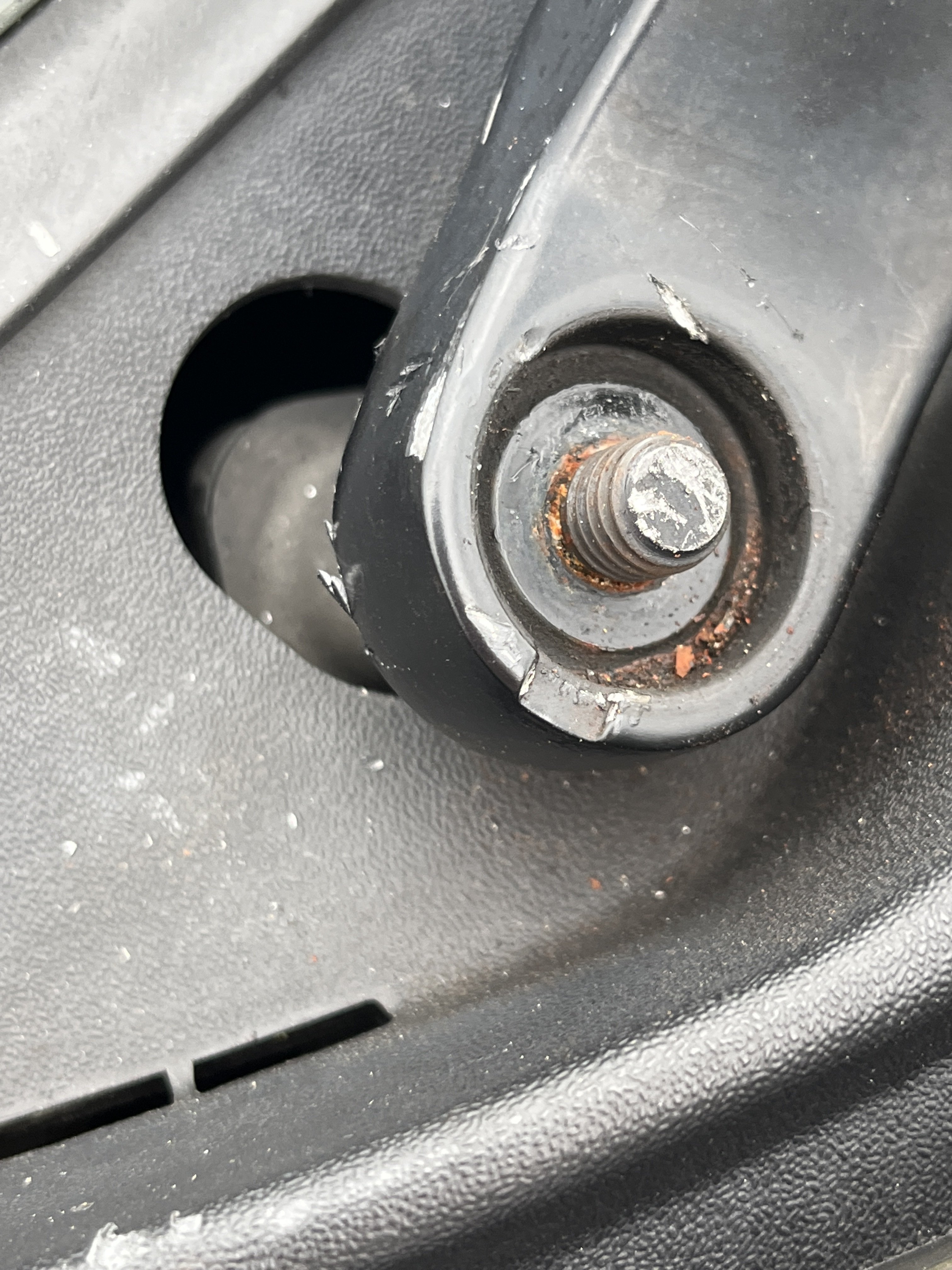

  20. Finally got the sods off! Battered the wiper arm in the process but at least it's done

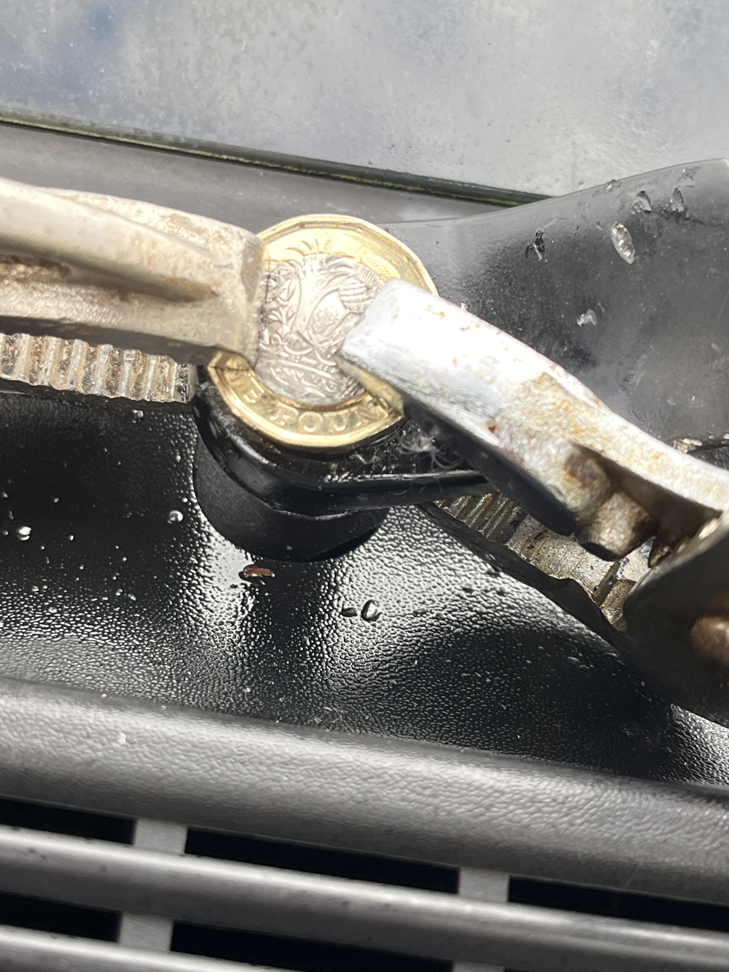

  21. I've got the one off after using wd40 and a lot of elbow grease but the one in the centre of the window won't budge. I've tried putting a pound coin over the top but in just deforming the coin
  22. Hi there.I'm following petes advice to go through the grommet near the windscreen wipers. As usual I've hit a problem. I can't get the freaking wiper arms off! Are these things welded on? 😂 I haven't got fancy removal devices at hand either. Just a couple of spanners.

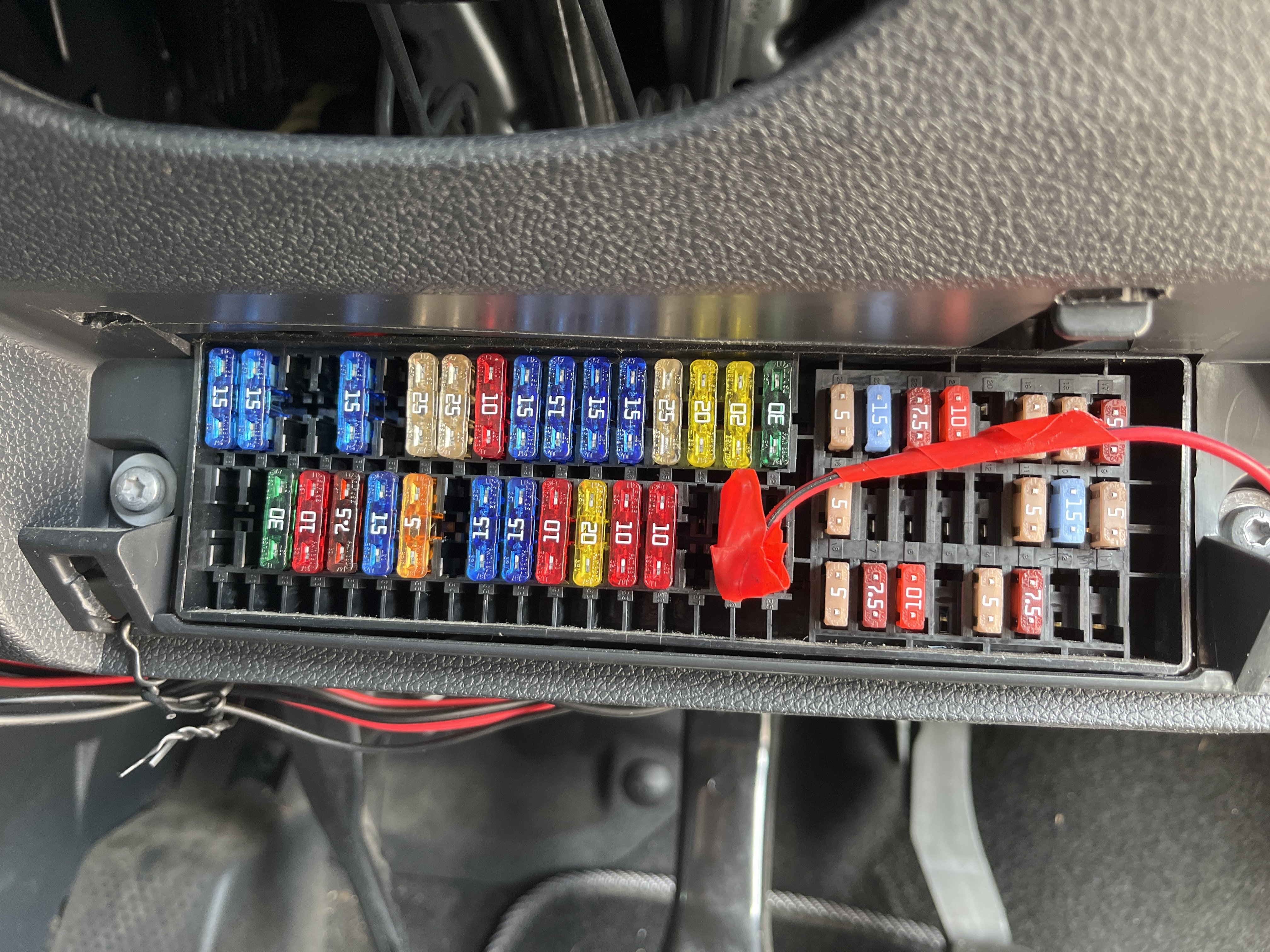

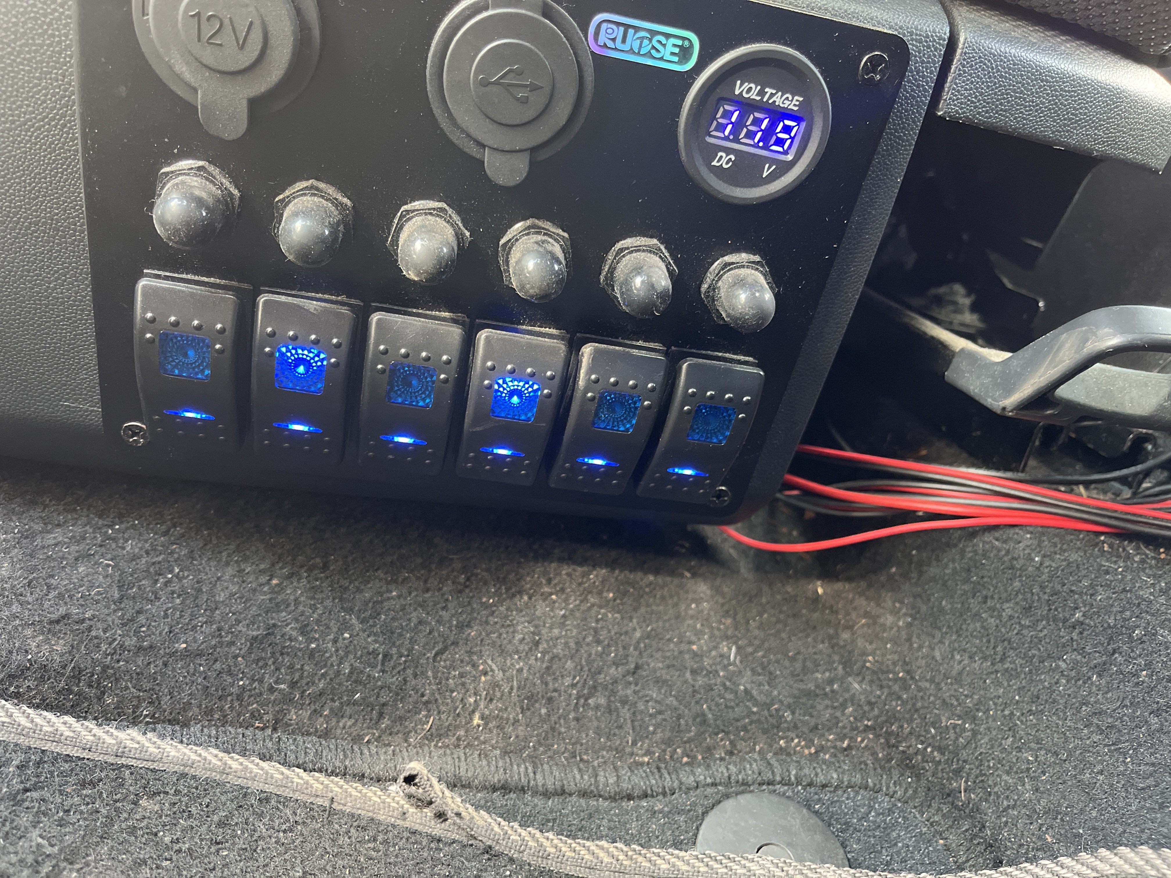

  23. I've just realised that the fuse that i took the power from was in the wrong fuse socket. The wiper is working again now lol. I think i had figured out incorrectly which fuse was for the ignition. The supplied sticker is confusing because it is for the lhd version. Looking at this web page https://fusecheck.com/skoda/skoda-fabia-ii-2007-2014-fuse-diagram Should i take it from fuse 30 instead? Ps- my switch sends to have some loose connections but those two switches are still on permanently. Possibly the switch is faulty now. I'll have to examine the wires at a later date
  24. It seems i only have one reverse light. But yes it is working. I also have some foot well lights attached to some switches (actually a set of switches for boats but they have worked. Since connecting then again to a fuse on the interior fuse box - mot guys disconnected then possibly - two of the switches are permanently on even when flicked to off position). I'll send some images.
