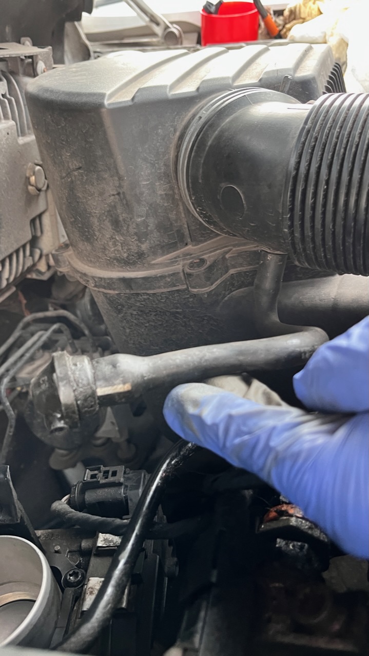

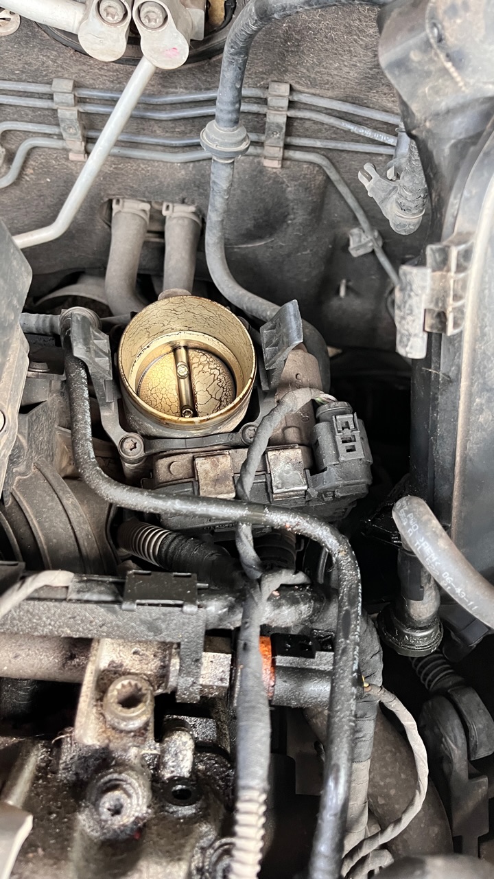

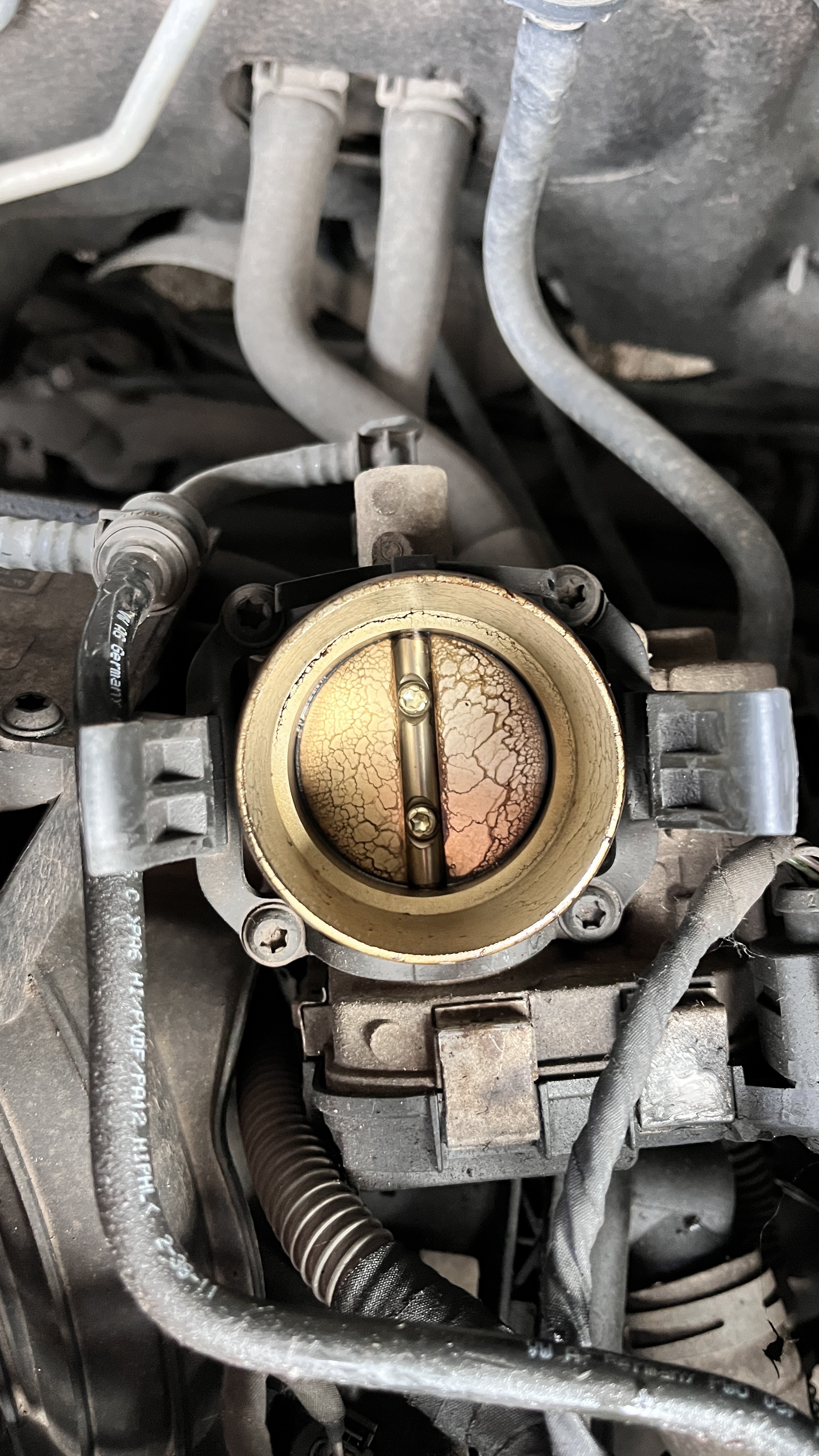

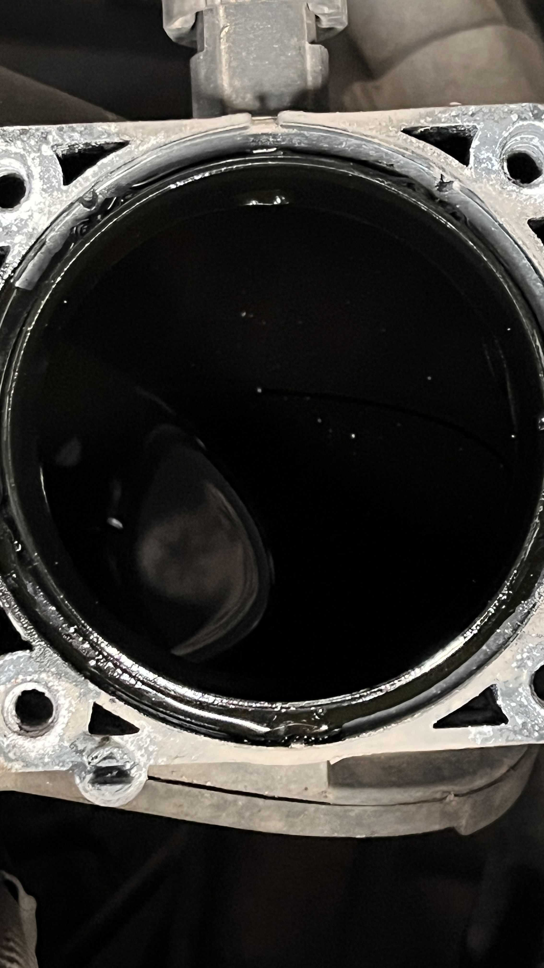

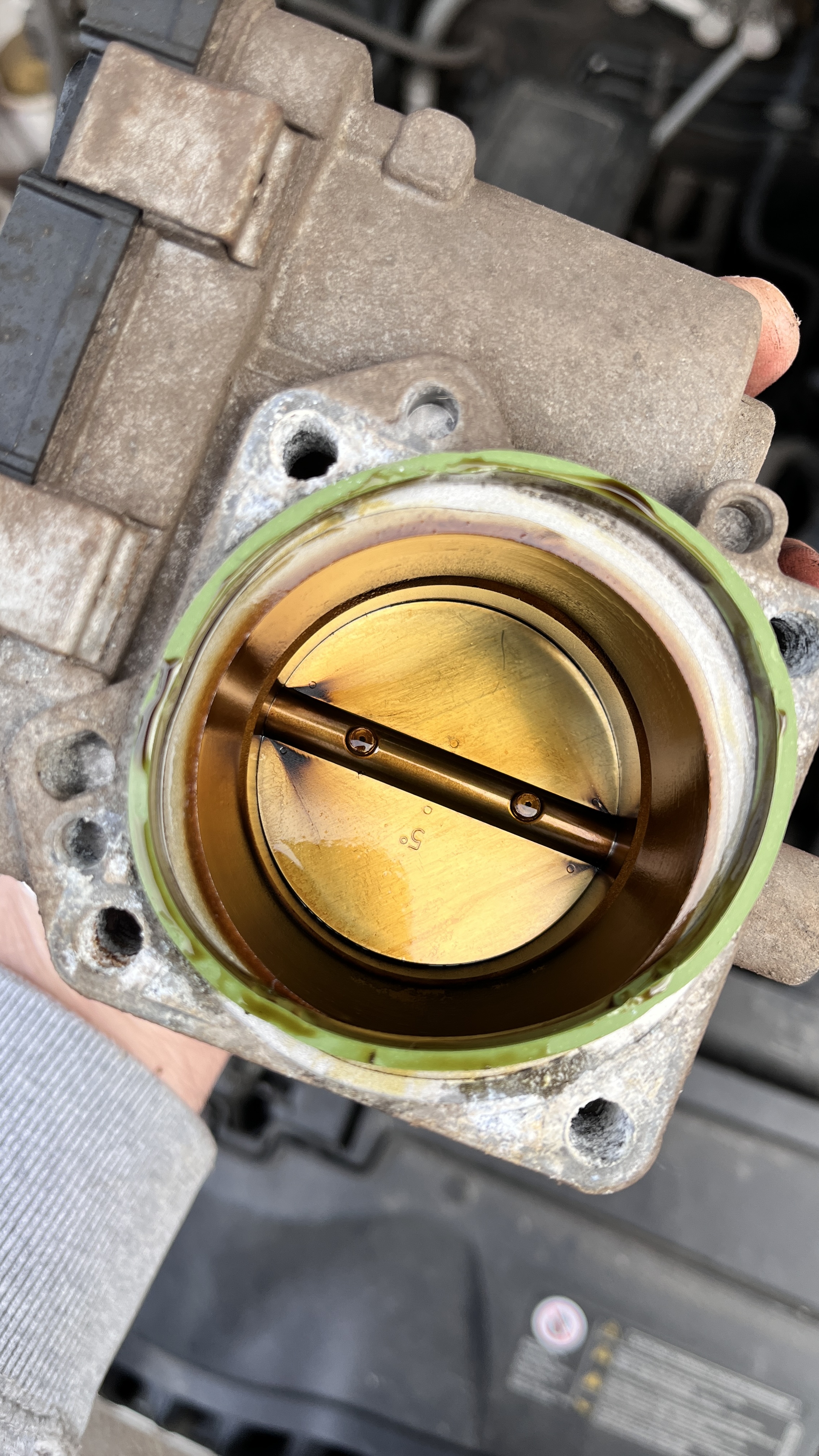

  11. I explained to the mechanic about there seeming to be so many causes of the problem so he had the car back to diagnose further. He concluded that it was, i can't remember the exact name, possibly the ecm box - a box with some websites in and i think an epc that communicates with the computer. I've got to take it in this coming Friday to get done. He claimed this box will cost about £300! So I'm more ****ed off because of the costs understandably. And it makes me question whether he is correct, in the hope of Cheaper fix of course. Maybe it is only a sensor that had failed within the box and he is just replacing the whole box to make sure the problem is fixed? I don't know. Additionally, i cleaned the throttle body yesterday. You should have seen it! Underneath the tb is a pool of oil! This has dirtied the tb. There is also oil that has got onto the engine area. Possibly through a pipe which looks like some sort of overflow outlet (see photos). For a few years i have smelt what smells like fuel or exhaust fumes coming, through the interior fans, quite quickly after idling in a static position or reversing. I thought it was part of the exhaust that needed tightening up and I'm sure it was made better when i asked a previous mechanic to tighten things up before. Lately I've not smelt it so much but now I'm wondering if it is this pool of oil? Could this oil be too do with the pcv valve (i think that's what is called)? What do people think about it all after reading this info and looking at the photos? Sorry Tb top Dirty tb bottom Underneath tb with oil pool Done kind of outlet, possibly how the oil has come out onto the engine? Oil all over the engine
