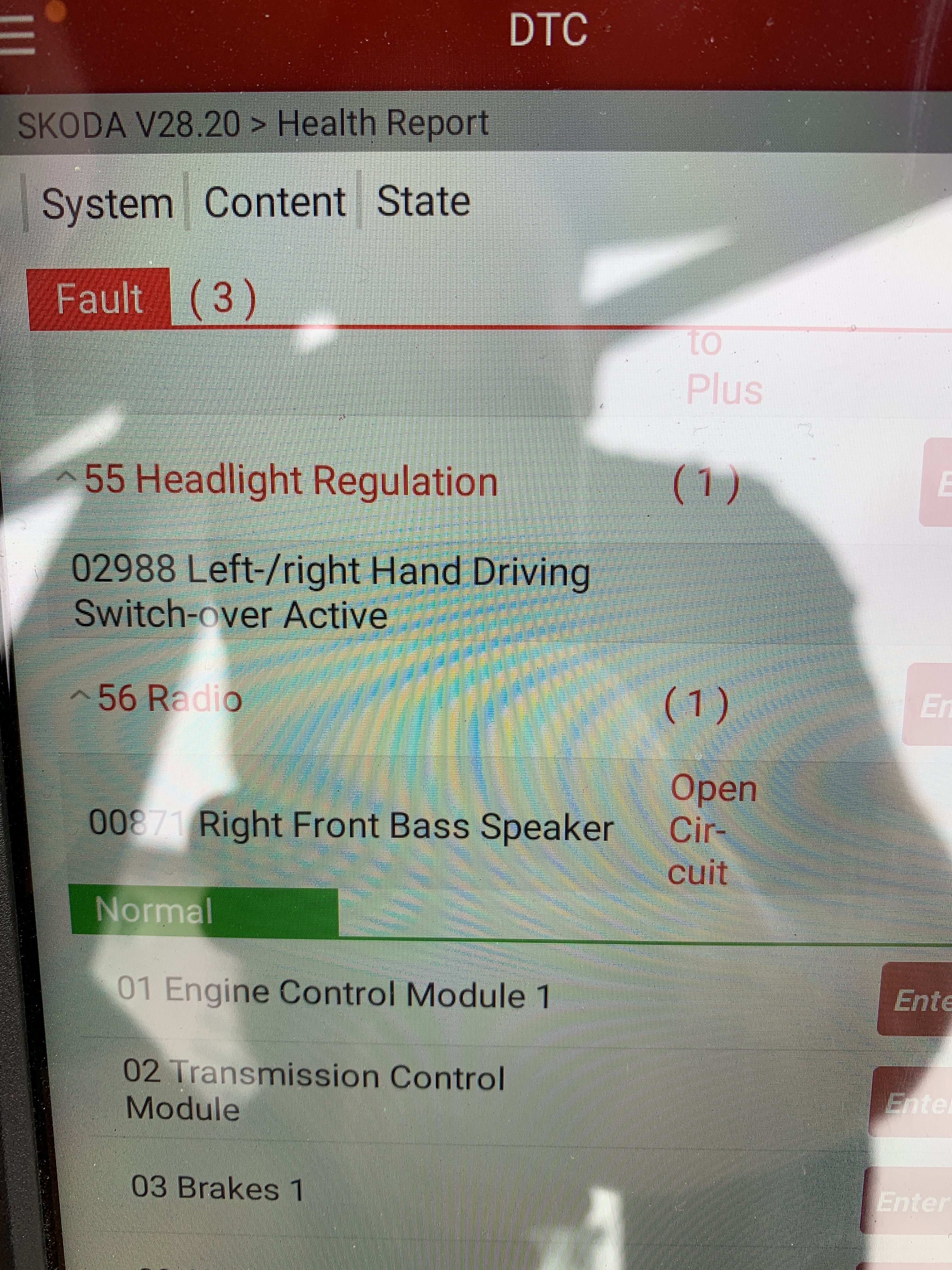

  1. I have fault code of 02988 which is left right switchover active. I tried to dissble tourist mode via vcds but it wont let me because in the area of parametres it shows security access required even if I enter security code. My friend told me that coding could be done only via VAS 5054 diagnostic and I visited official skoda dealer and they told me they have this one.

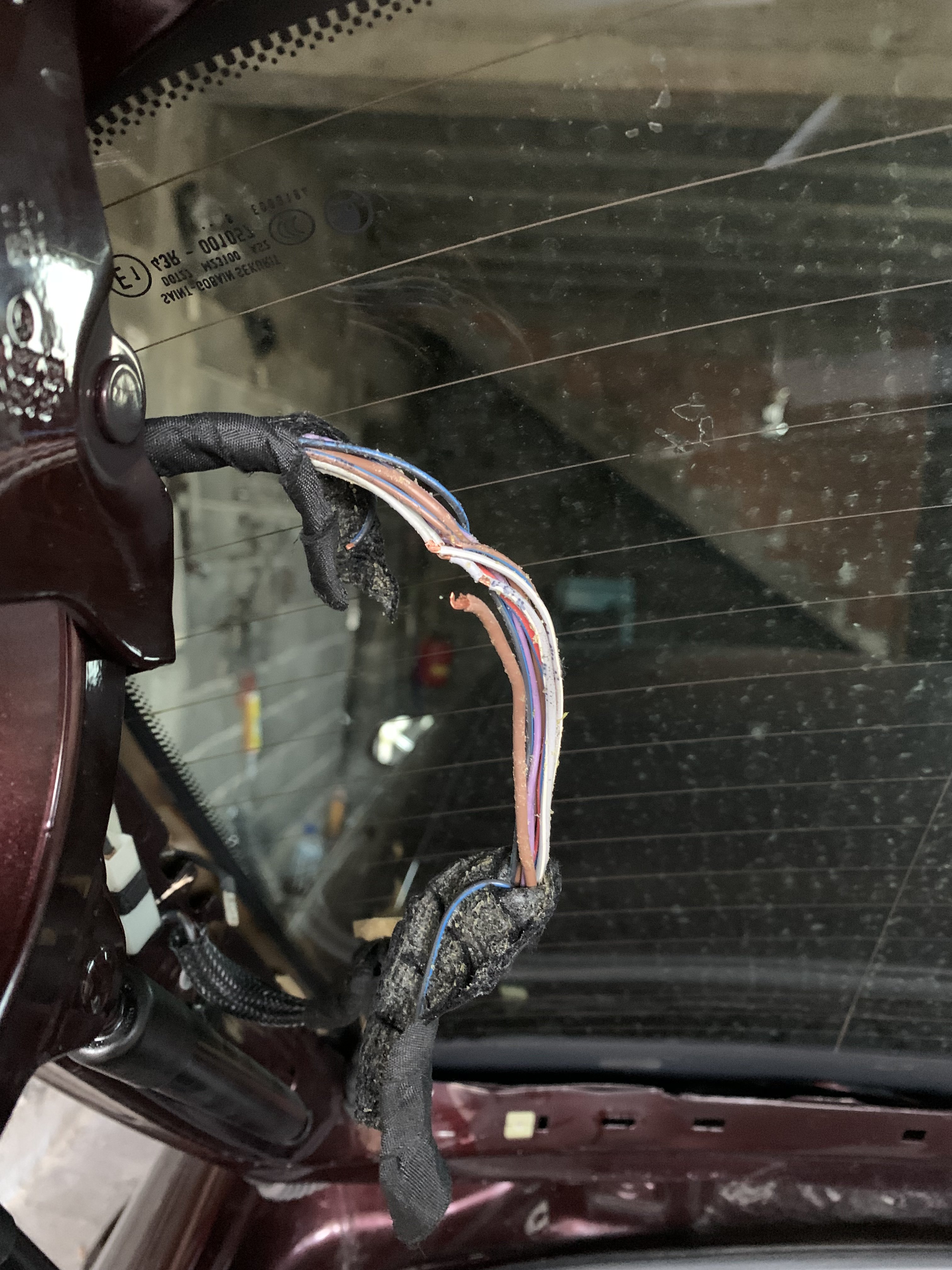

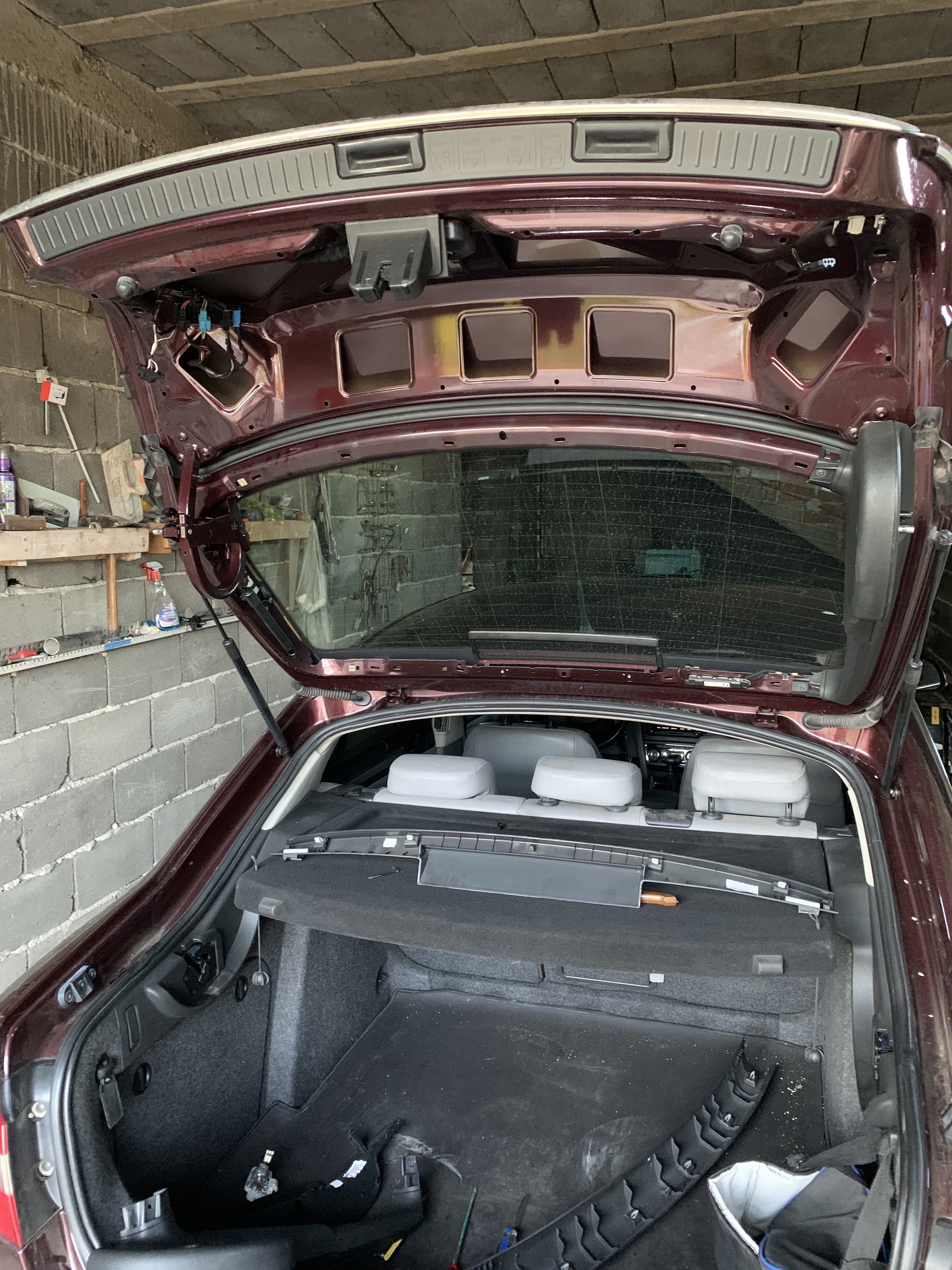

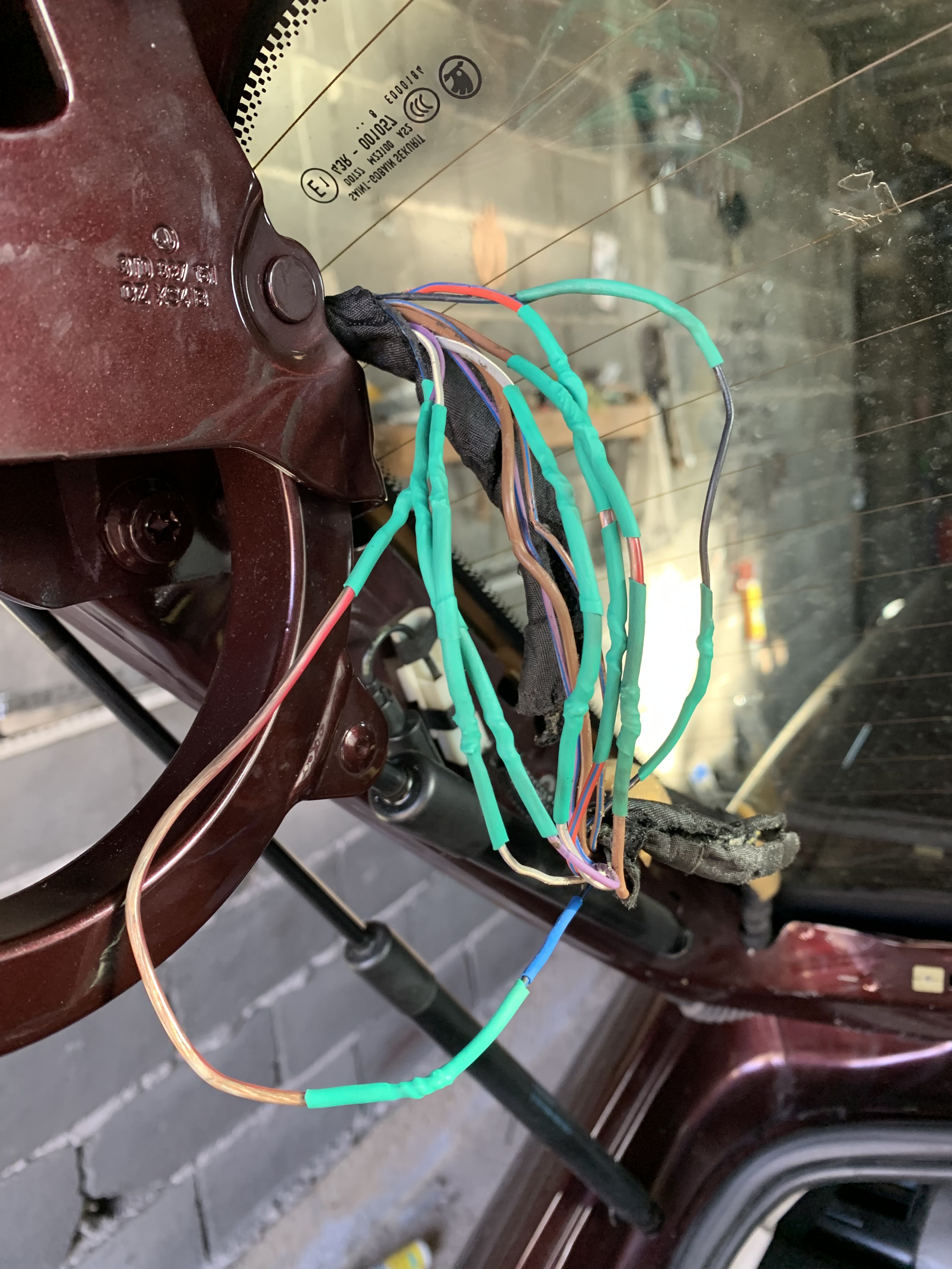

  2. It was fameous twindoor wiring issue. Fixed.

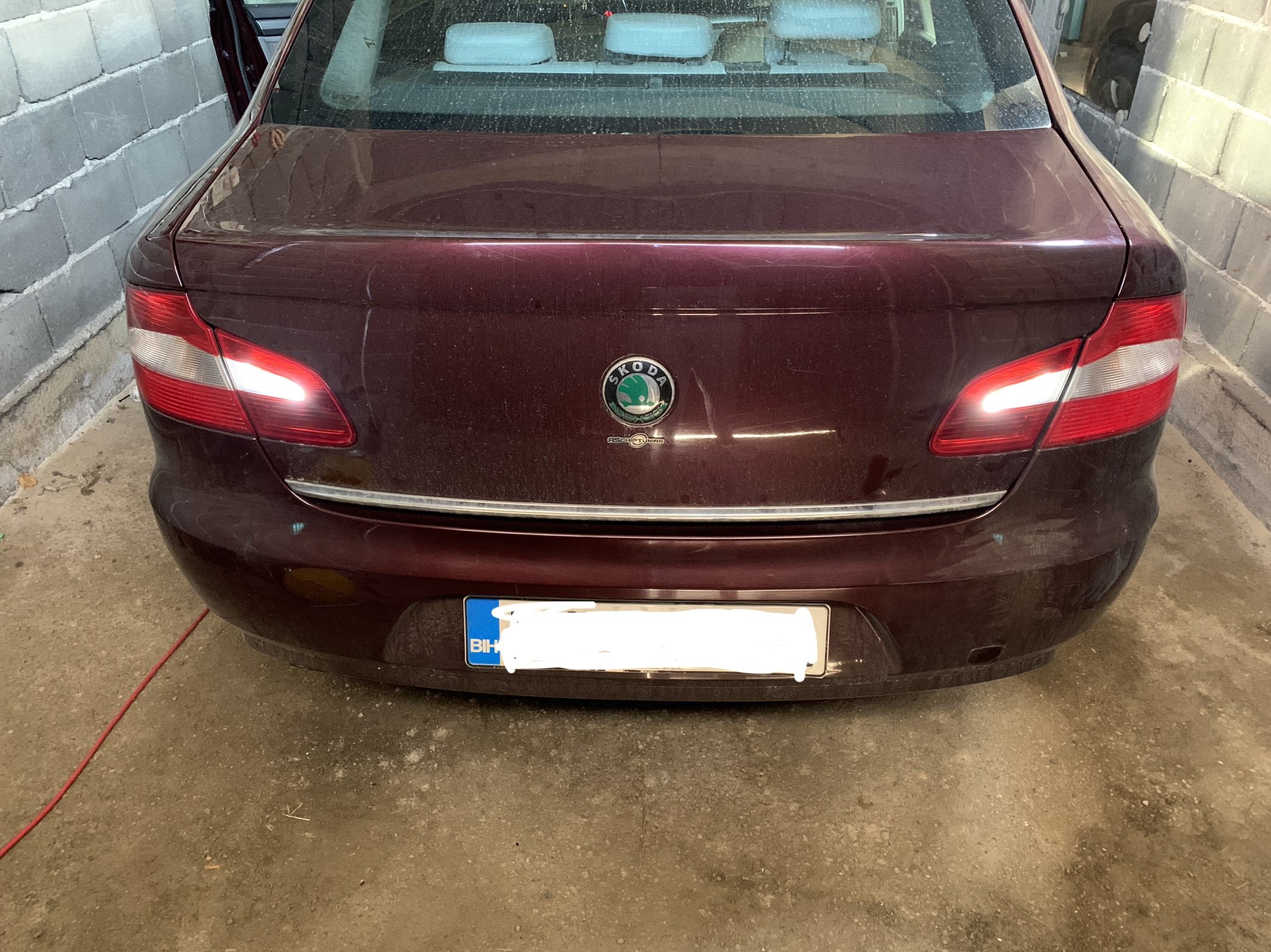

  3. P.s. fog light works on left side perfectly. Only backup light does not!
  4. Hi there, as you know superb has 2 backup lights , i have problem because the left one does not work and the right one works perfectly. I disconnected the wiring from left side and everything seems good. Also I disasembled trunk part to check wiring , no broken or loose wiriing also. My electrician told me that left and right side use same power and I am reallly confused why it does not work. Is there any way to pull out wiring from this part ( check photo) and to check 2 other wires? I know there is wire missing here but I fixed that !
