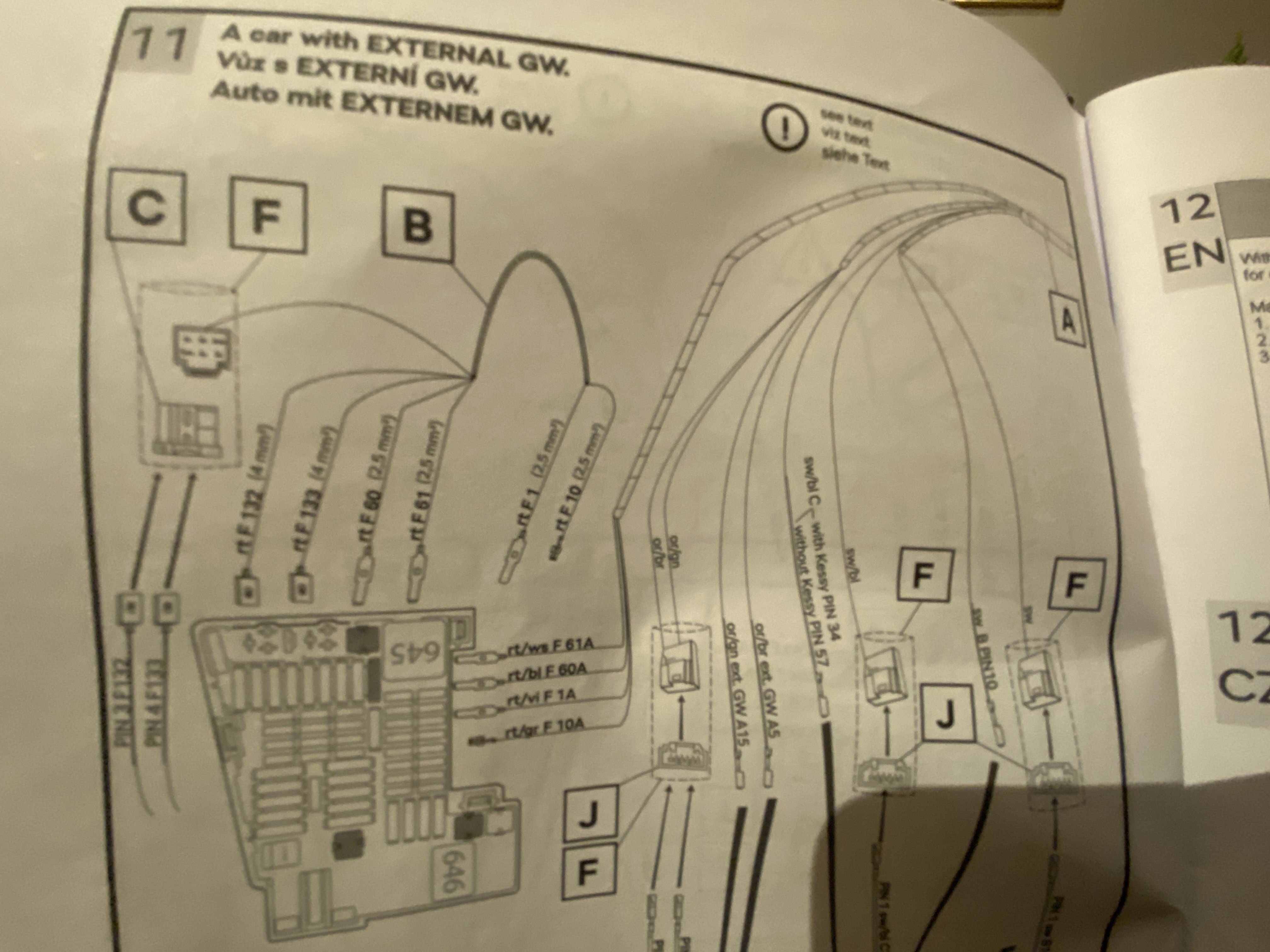

  1. My 2019 Skoda Kamiq is fitted with a genuine Skoda factory harness that runs from the dash fuse box and BCM to the back of the car? Fitted by me. I have information that the correct trailer module is 5Q0907383L. I don’t want to purchase this and to then find that it cannot be coded due to incompatibility with the BCM , CANBUS etc. Note that i can find multiple listings of module 5Q0907383L but a 5Q0907383L being sold for a Fabia has different codes on it than a 5Q0907383L being sold for a different model. Very confusing.
  2. Yes, under the dash on the drivers side. Have also checked the engine bay fuse box but no F132 or F133 there either
  3. Did your instructions state connections F132 and F133 in the fusebox? Mine do but i can’t find them in the fusebox.
  4. Hi. The Skoda towbar wiring instructions (see attached) refer to fuses (or terminals?) F132 and F133 in the fusebox under the dash. I can’t find these listed anywhere. Any ideas? Thanks
