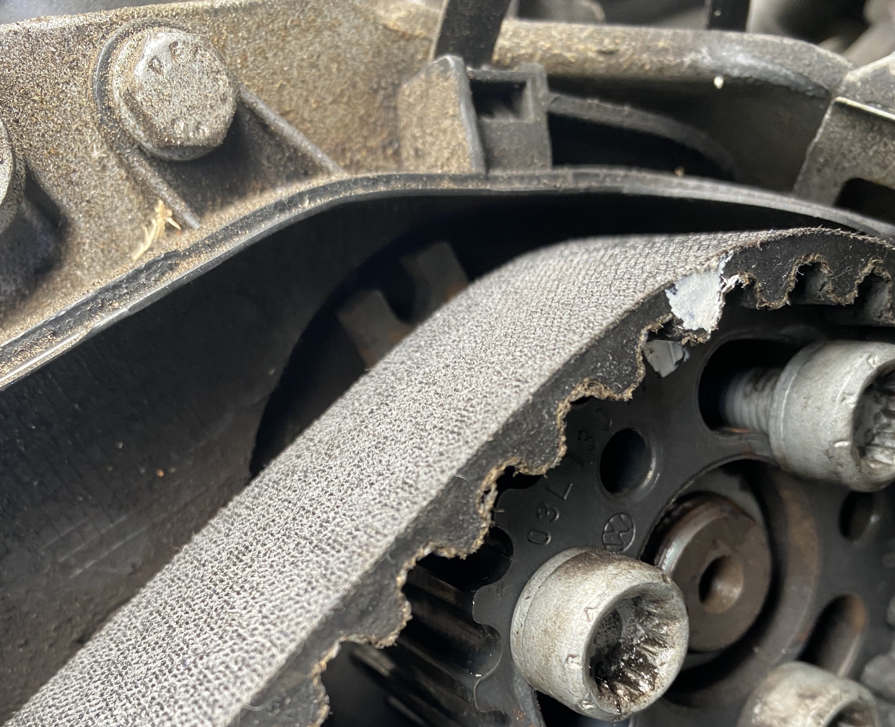

I have just changed the Cam Belt on a 2009 2.0 Tdi VRS CR CEG engine. 125k miles When locking in TDC there was the following problem. The locking Pin for the CAM went in ok but I was unable to lock the High pressure sprocket, the attached photo shows that it was off by about 20 degrees to the right from where it should be. SO... I decided to put the new belt on exactly the same and did not to move the pump sprocket back. I marked the belt and 3 sprockets and transposed these marks to the new belt, I also made sure that the number of teeth on both belts were the same between marks. Its back on the road and running perfectly. It would seem that whoever fitted the previous belt got it wrong. As the manual says these positions are critical , why with this offset does it work, in fact the performance of this car is outstanding both before and after belt change.
