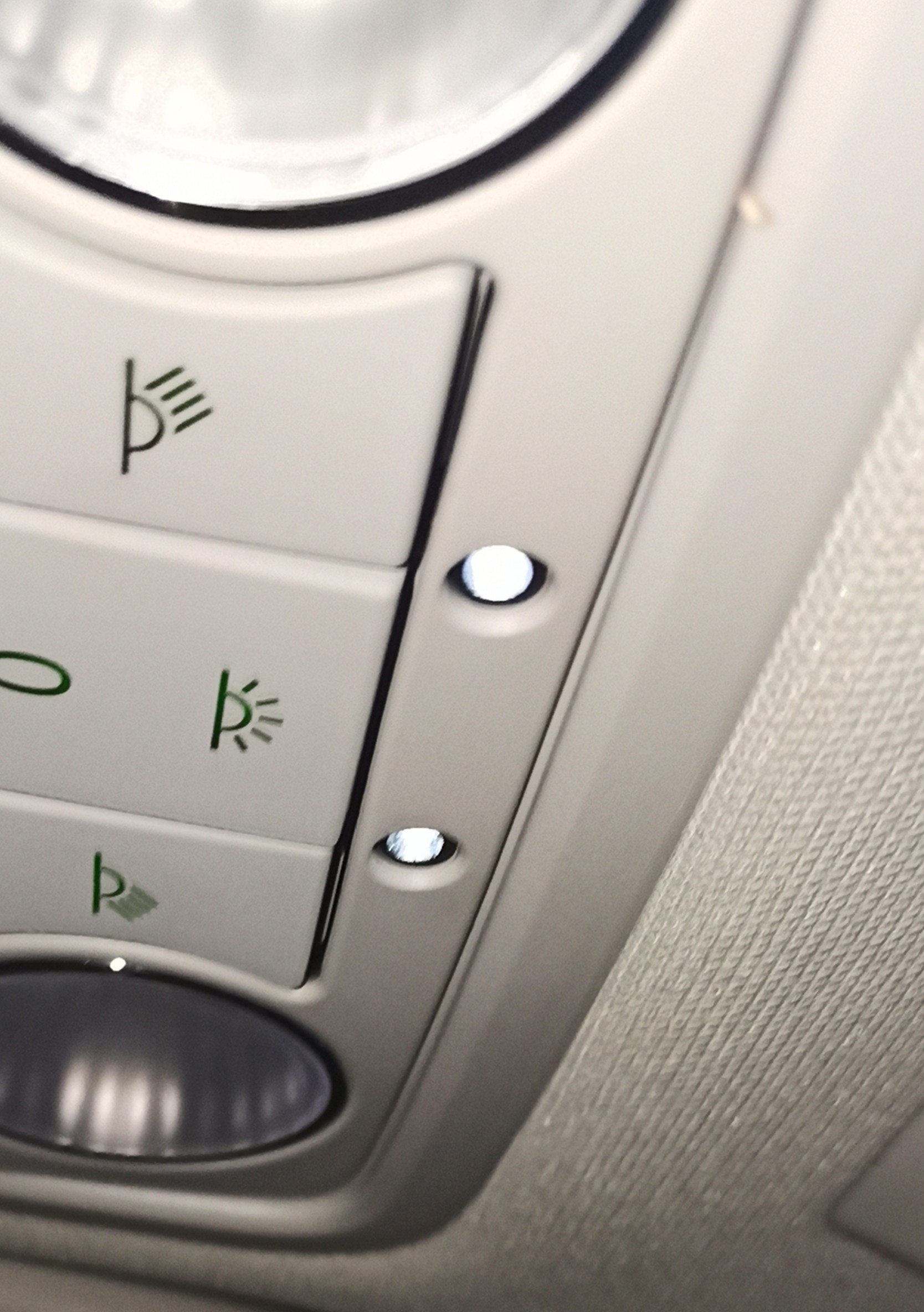

  3. Is these a way to turn off these two tiny lights? I'm finding them distracting at night, but there's no switch and I can't find anything in the settings. Any help would be much appreciated 🙂

  5. Is these a way to turn off these two tiny lights? I'm finding them distracting at night, but there's no switch and I can't find anything in the settings. Any help would be much appreciated 🙂
