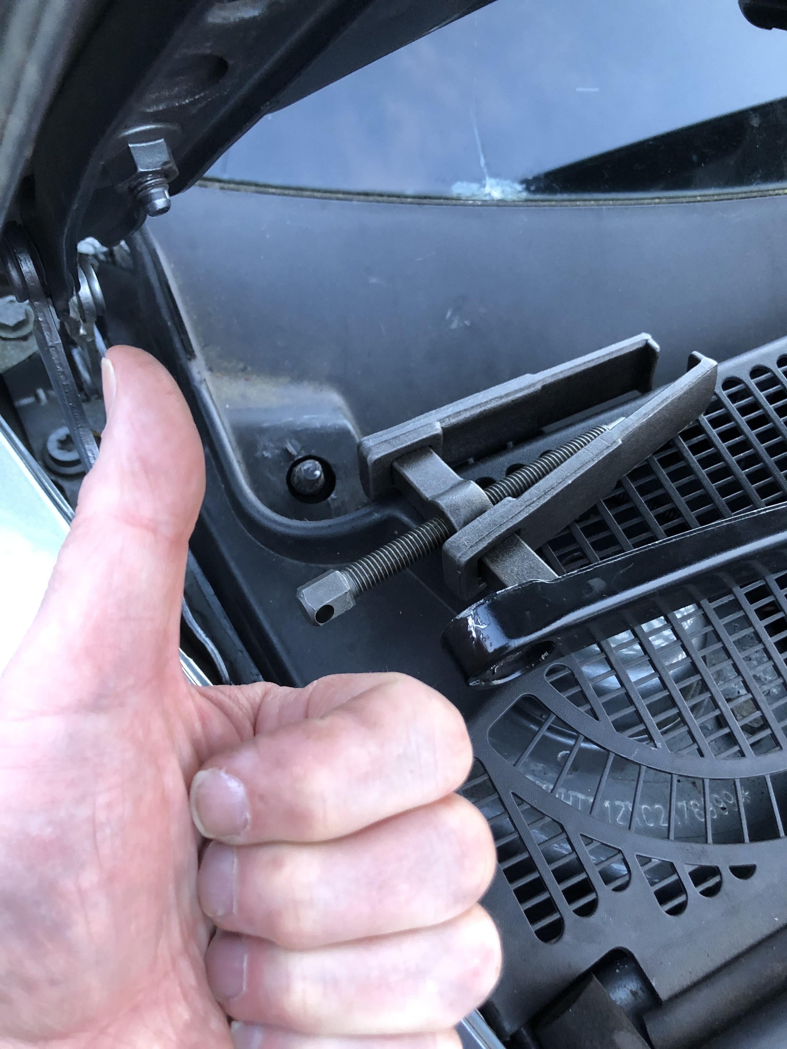

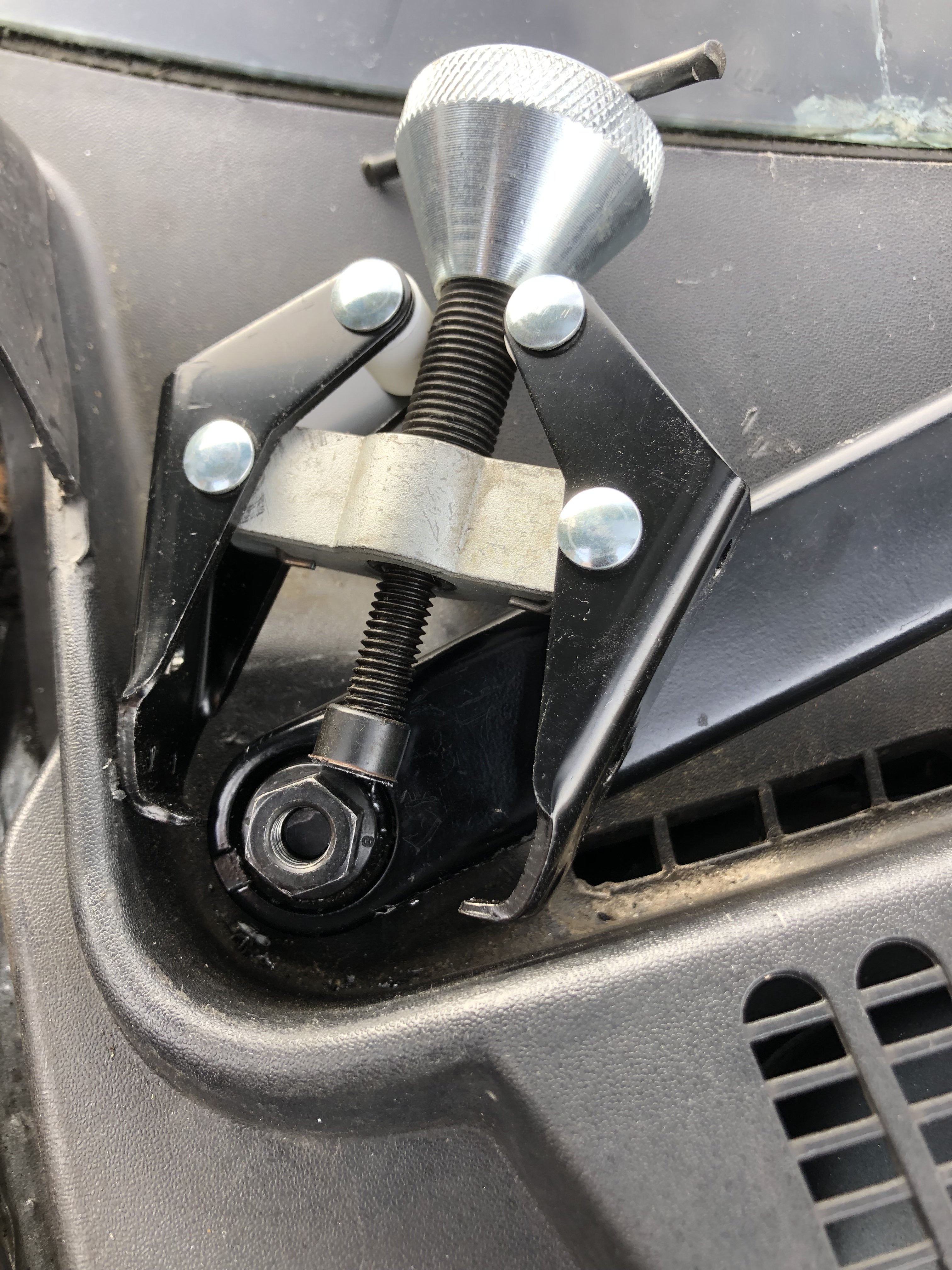

  7. Update on removing my window-pillar kissing wiper. Success !! I used this simple but excellent puller which did the job in 2 minutes. No hammer tapping, no plastic cover removal. The thing looks like it was made in a small backstreet workshop, but perfect for this job. Big thanks for all the tips and advice on here gents, I hope this helps someone else before getting a crowbar out !

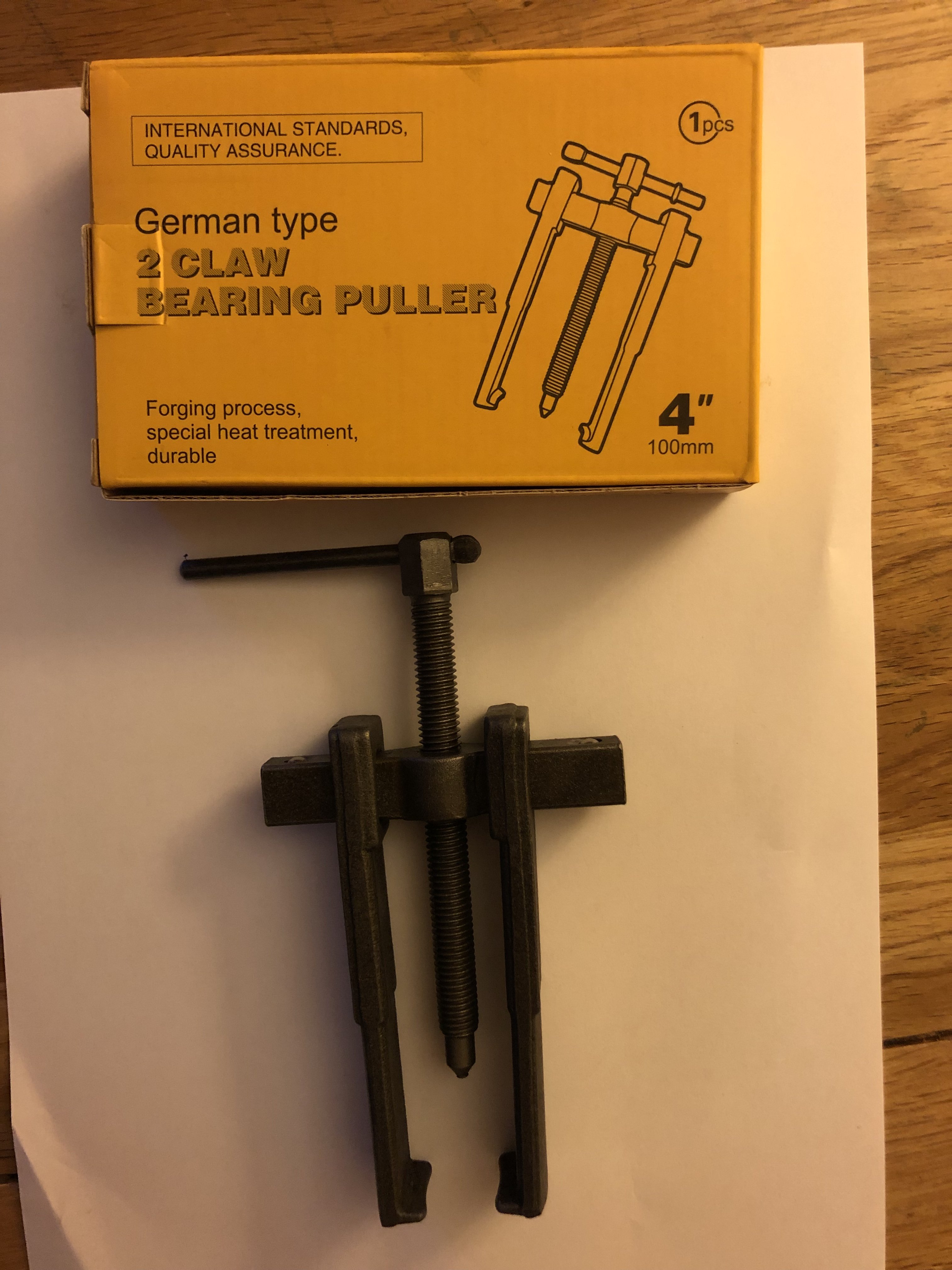

  8. That’s the very first one that shows up on the search, but I wondered if it would be up to the job. On the reviews for it someone said the plastic turn bit broke apart ? Maybe they had a Friday night job. ive ordered one I think will do the job, I’ll let everyone here know the outcome. Thanks for the help, much appreciated.
  9. I’ve considered pulling up the trim but I’m not very adventurous and it might open up a whole can of worms for me if I snap something or can’t refit it. I tried tapping the spindle from the out set when I applied w d 40 to work it down, but didn’t make a bit of difference. I’m nervous about shocks being transmitted to my fractured and bullseyed windscreen by applying taps with a hammer, so I think my safest bet is to try the narrow puller. I’ll try gently tapping the spindle again as you suggested when I’m using it, and hopefully it will work.
  10. There is no question, this puller won’t do the job because of its design and the very restricted area it needs to fit. I didn’t realise until I tried it. Its arms taper outward and therefore the ‘hands’ can not slip under the base of the arm in the space available.I fiddled with it for ages, different angles, no joy. I spotted a much simpler tool I wish I’d seen earlier. It’s design means the pulling arms can be slid inward to work in a very restricted area. I’m going to try that after applying penetrating fluid then report back here on how it’s gone. Thanks for the advice, I’m adding it to my arsenal of tips to get this job done !

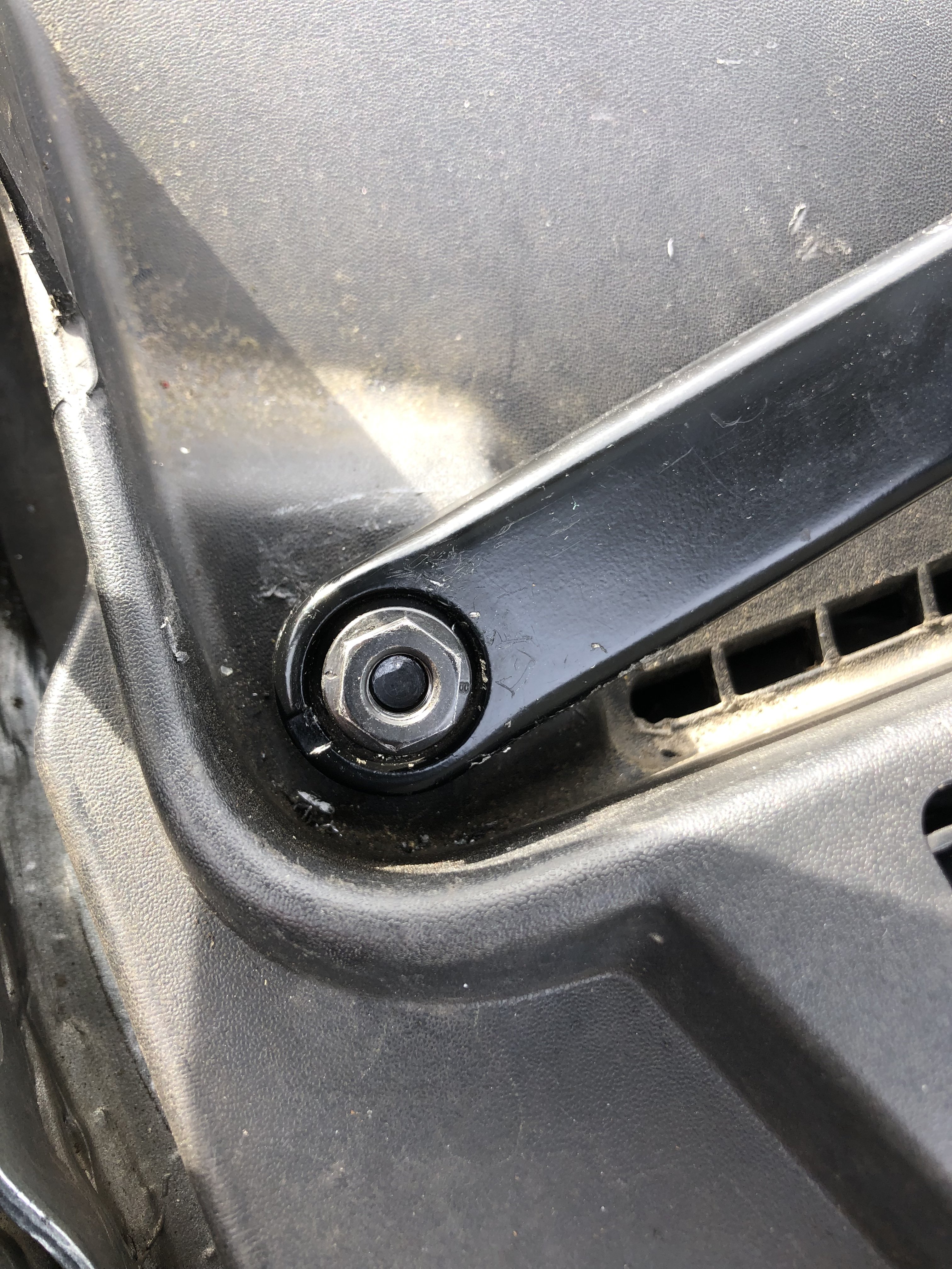

  12. Thanks, but the way the wipers are recessed below the bonnet line on the Octavia this isn’t possible, with the bonnet up or down. I did apply wd40 last weekend, not made any difference, but noted it’s not the best stuff to release a fixing that hasn’t been touched since it left the factory in 2012. I think this will be a wedges and chisel job as suggested here.
  13. Hi all I need to remove my windscreen wiper arm to rotate it a couple of notches on the splines because the blade has been striking the window pillar. Simple job I thought. I bought a pulling tool (see pics) but it’s arms do not fit into the tight space available within the plastic moulding. The wiper arm seems like it’s welded on 😬and won’t budge a millimetre despite use of wd40. I was thinking of gun powder next but would welcome any advice on a more practical solution. Thanks.
