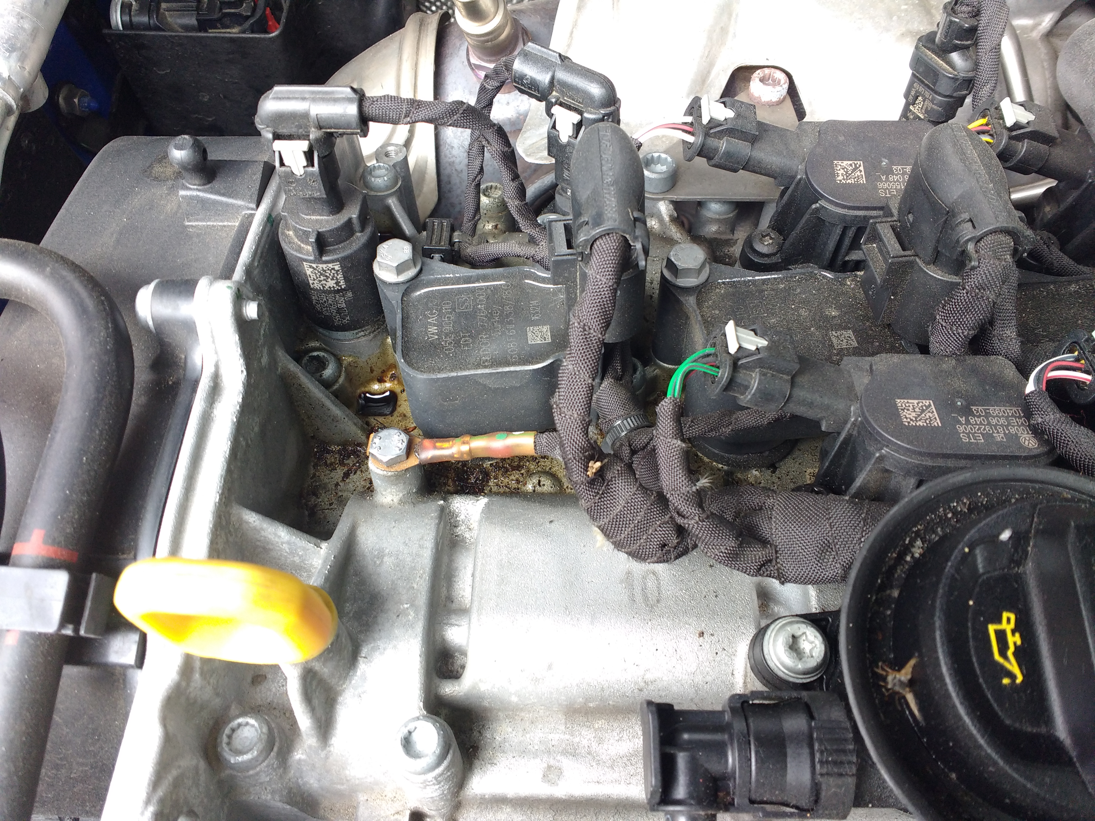

  1. I got a response back from the skoda workshop. The extra cost all have to do with changing spark plugs. "since your car has more than 5x,xxx Km skoda says they have to be changed. the other parts are necessary during the exchange"
  2. That was a rhetorical question I am just trying to fathom how this would mean friendly and fair service; and I can get there, any help? I could ask, in email, why they wish to service my turbo (if that is what is is). or ask at another dealer and see what happens.... the game is on! Here in DE you get standard 2 year warrenty. There maybe some components with 3 year, i have to do some research. *conspiracy theory one; they saw the problem in first service noted it and decided to postpone the work until out of warranty...... The car does use oil. I have asked at some point on the forum, as well as skoda/VW. I was assured it was normal for the 1.5 w/ 0w20.....
  3. But how would they know that without seeing the car??? I just emailed the VW workshop and asked for a quote. I believe I recall seeing this during the first service interval. I have cleaned this oil off at some point so see if it returned. I seem to have forgotten to check:) In any case this is not near the turbo???
  4. Oh, also, I did have a look over and clean the car and did notice some peculiar oil collecting near the plugs? what do you make of it?
  5. In the meantime, I already replaced the pollen and intake filter with febi and mann equivalents. Cheap and easy and should save a few buck wherever I go for oil. Is there anything particularly needful or interesting contained in the "detailed Inspection" I assume that just look for rust and things to sell you, right?
