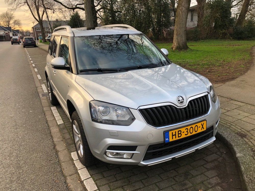

  1. Hi there, After my previous car the Dutch Brown Yeti, we bought a facelift model from 2015. The car was pretty fully equipped but there is always more to fit! (Retrofit!) It is a 1.2 TSI DSG with original nav, DAB, Sunroof, Keyless entry, Xenon. This is the car how we bought it in 2020. Things and Mods I allready done: - Change Mirror covers to glossy black - Wheels from the previous yeti we kept and put it on the new one. - Steering wheel from facelift model with DSG flippers - Roof rails we kept silver but changed the 4 covers to glossy black ones - Front spoiler to Monte Carlo black - Rear spoiler to Monte Carlo black - Side skirts / spoilers to Monte Carlo black - Rear Logo + Skoda Yeti names to black - Front Logo to black - Monte Carlo logos on the side - Wrapped the roof to black - Retrofitted PLA (Park Assist) So 4 extra sensors on the side so it can park itself - Enabled Apple CarPlay - Changed the climatic control to a luxury one (From AliExpress, See photo) Things to do: - Trailer Hitch - Alarm Horn (Already fitted but need to connect the cables and code it. - Active tire pressure monitor (The ones with the sensors in the wheels) more to come.... (Pictures also)
