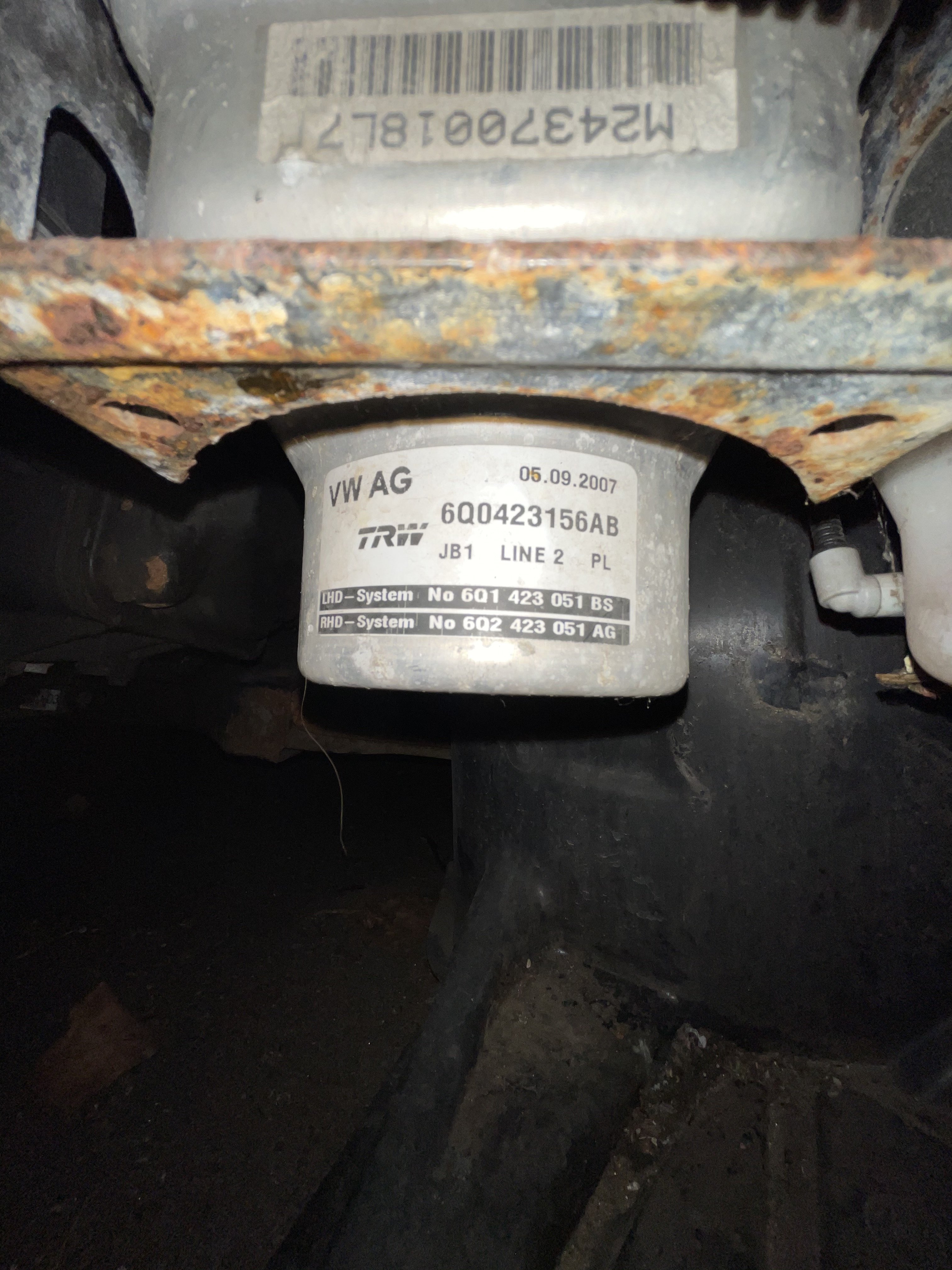

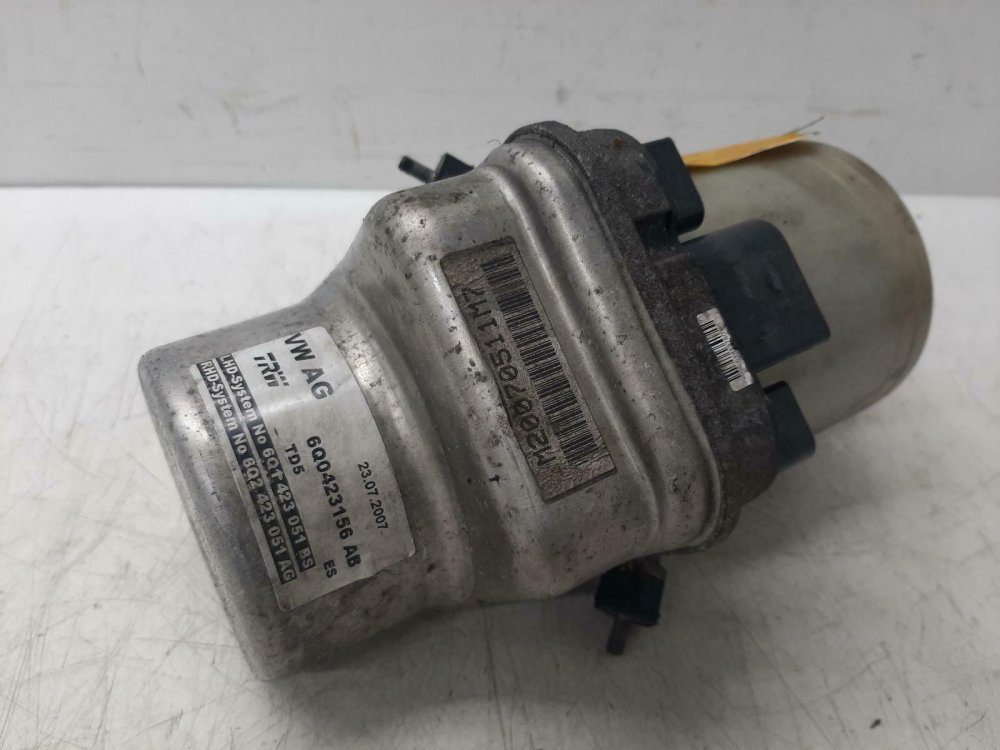

  2. Tried clearing the contacts & then cleared all DTCs and error still persists... So I'll just replace the pump. Does anyone know if every line needs to match? Seems to be indentical to mine but it read TD5 ES instead of JB1 LINE 2 PL... does that line matter as well? I have attached a picture of my pump (IMG_1468.jpg, i.e. the one fitted) and a picture of the pump I'm looking to buy (I'm keen on this one as the seller looks pretty reputable and it comes with a 12month warranty)
