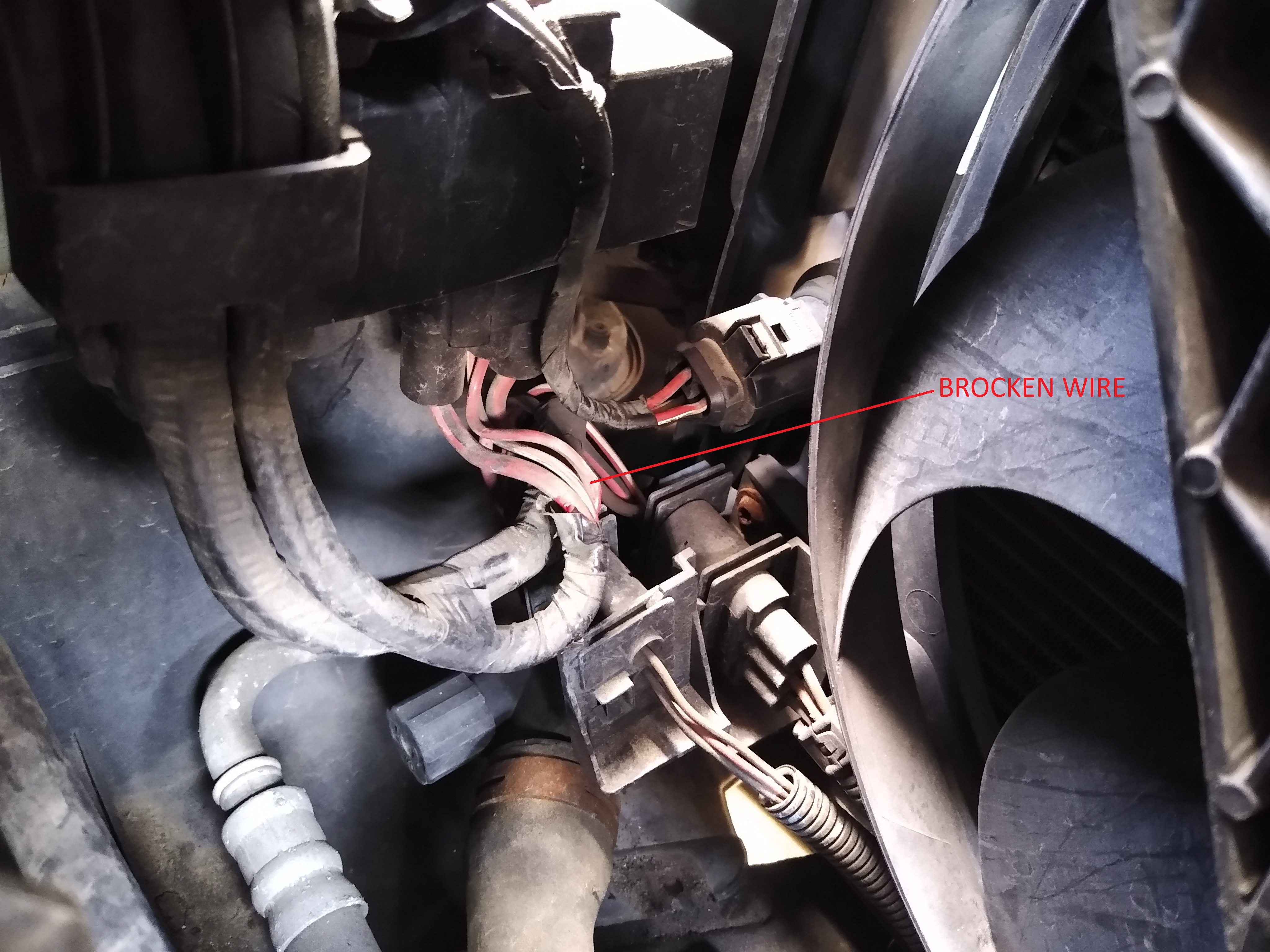

Help identifying broken wire below battery (MK1 1.9tdi Octavia)
HI, I am currently trying to sort out an air con problem where the compressor will not run and has no power to its clutch. I have found this wire that is down below the battery just to the side of the left hand fan (passenger side in the UK) the wire has rubbed through on one of the brackets below. Obviously I will cut out the damage and solder the joint and make weather proof, I was just wondering what the wire does, I think it is to do with the fans am I correct.
