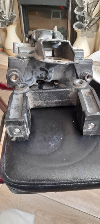

  1. thank you Breezy_Pete you were bang on the part number and the bolts my car is back on the road thanks to you unfortunately i still have 2 issues that iv not solved and haven't a clue what's causing them i thought that the bolts that was snapped was why the car was puling to the left but its still dose even had it tracked last week and they said it was perfect plus there is a mild knock when i go over a little bump i know its not the suspension and had the anti roll bar linkages changed last year thanks again for your help

  3. Hi I was driving home from work and heard a bang luckily I was only going slow and near to my destination I noticed the passenger side of the engine was slanted I managed to take the engine mount off but I'm stuck on 2 things dose anybody know what it's called were the bolts have snapped and what size bults will it be Thanks

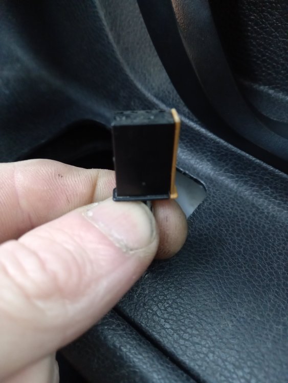

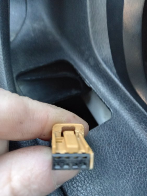

  8. Thank you that looks like the correct one The connector doesn't fit tight as you can see by the pic the plastic is a bit bent plus I can see abit of the copper showing through about 5mm from the block I don't know how you managed to get that code so THANK YOU
  9. Thank you that looks like the correct one The connector doesn't fit tight as you can see by the pic the plastic is a bit bent plus I can see abit of the copper showing through about 5mm from the block I don't know how you managed to get that code so THANK YOU

  11. i have looked at the wires they are all connected but i could see a bit of the copper showing so i put electrical tape and still same i need a new 4 pin block but dont know what to look for it

  13. Hi i am having trouble with my driver side window switch i bought a double switch for my Skoda because it stopped working when i replaced the switch it worked for about 10 minutes then it stopped so i took the fuse out (nothing wrong with it ) and put it back in windows worked for another 10 mins then stopped so took fuse out again and put it back in and they worked again for the same time i am trying to buy a new 4 pin connector block that is square iv only seen the oval block for it to see if thats the problem but i dont know what its called or were to buy 1 from can anyone please help
