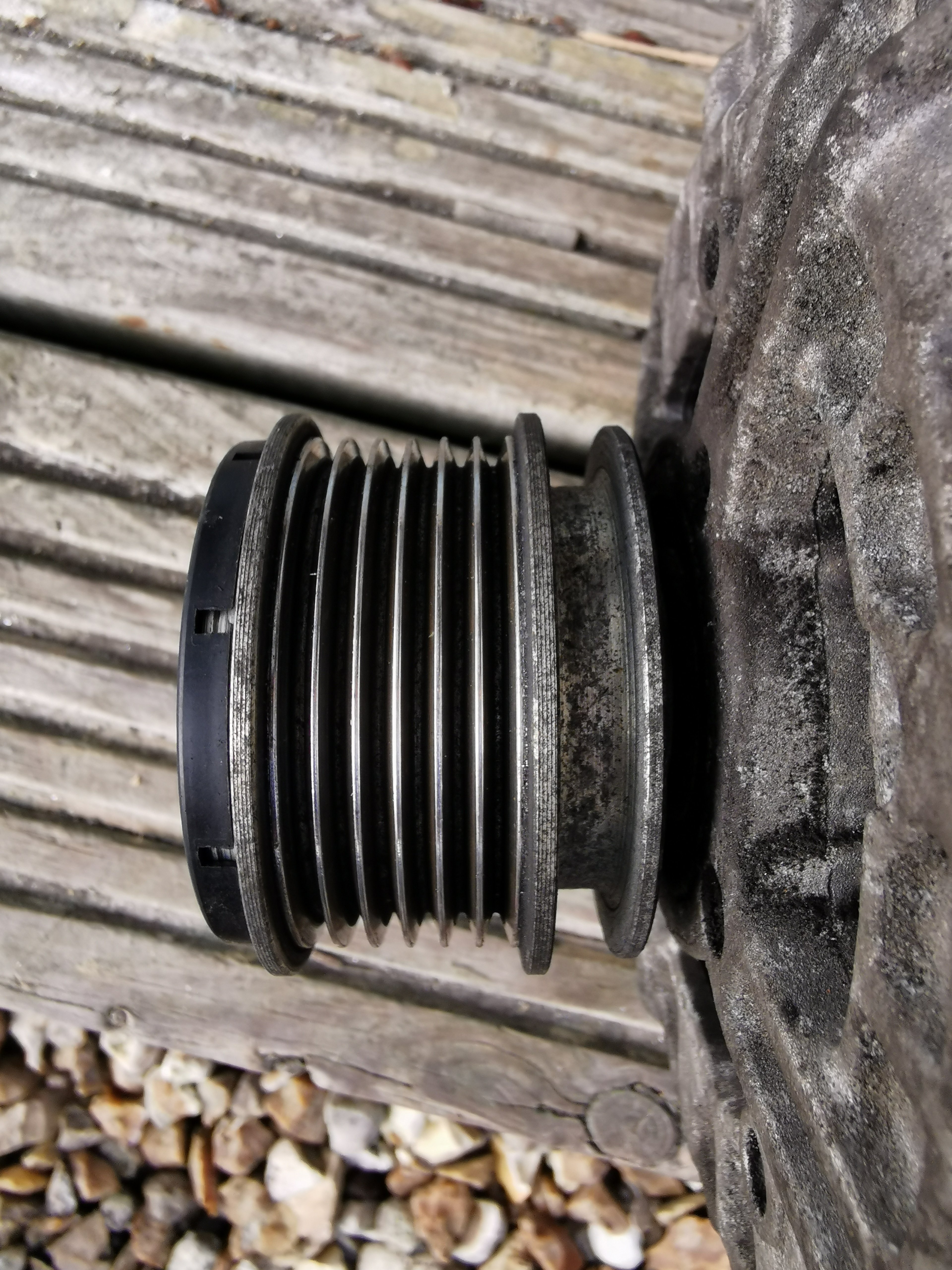

  3. It's a good thing the local garages are busy and can't fit me in as it's stopped me being lazy and I've pulled the alternator off this morning and established its the clutch that's gone. Locking the alternator from turning the pulley is solid in both directions. Back in work now but will order clutch, belt and new tensioner later today. Any suggestions for supplier much appreciated

  5. Hi all, tomorrow (Sunday) I need to drive to Heathrow from Cornwall and typically my forever reliable 09 scout has developed a loud rumble at tickover. Investigation shows something (tensioner) moving around (see video) There's no chance of me getting it fixed today in time for tomorrow so I am wondering if I can safely drive it? VID_20211002_121111.mp4

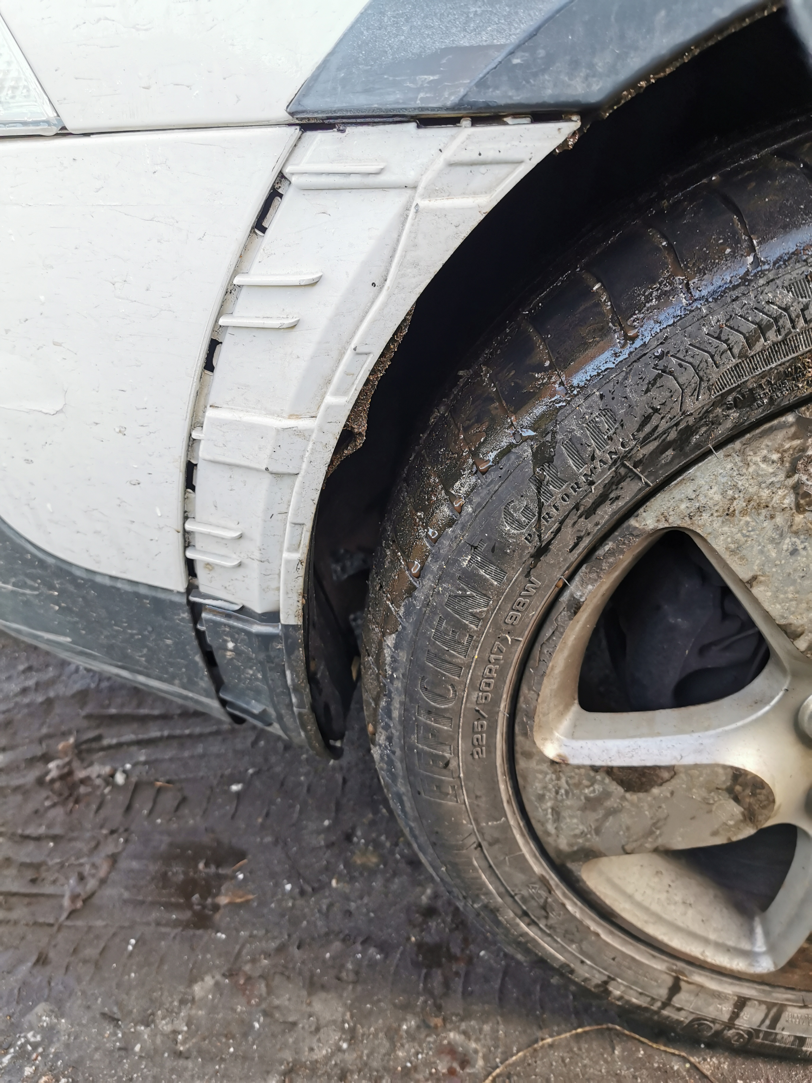

  11. Hi all, I bought my ex regency services 2009 scout back in April 2018 as a temporary stop gap and to see if I could go down from a VW transporter to an estate car. It's been incredible with everything on it working and nearly 20k miles later apart from a few scars from its previous life, which it wears as badges of honour, there's nowt wrong with it. 175k and still going strong. One battle scar I've been toying with ironing out is a piece of plastic missing from the passenger wing. So I'm now trying to work out what it's called and where I can get it from. I've done the occasional forum and Google search and not found it. Any help will be appreciated. Cheers and merry Christmas to you all. Dan
