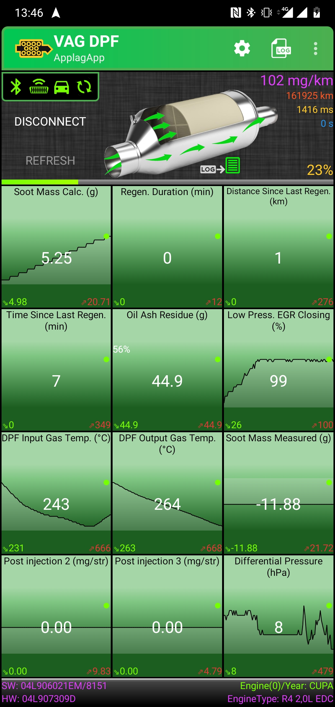

  4. Yes. Is that taken on idle with normal operating temperature and no load ? If yes your injectors are not OK or worse one of the cylinders is not up to the others so ECU is compensating. At 163k km I had a 7-8 hPA after a regen at idle. You can check the sensor fast : with power on/ ignition off sensor should show around -2 to +2 hPA.
  5. Stationary. Did you check injector corrections ? I see that the sensors look ok at a first glance. Las sw version for this engine is 8151.

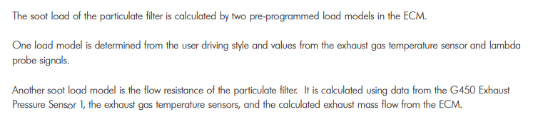

  6. No that is not normal. Measured should drop faster than calculated and actually get to a negative value. Just do a forced service regen from VCDS and see the values after.
  7. Soot mass measured does not increase while idling. That is normal behaviour.
  8. It is a calculation based on pressure sensor/MAF/temp sensors on the load of the DPF. Either one of these sensors is bad or you have a really bad smoking car.(this was my case). Is the car tuned?

  10. See where the measured goes after a regen( you can set VagDpf for group 0) and then see how fast it fills up. Had the same problem so questions are: - how much oil used for 1000km - injector state - lambda sensor changed ? You might have 2 I changed 2 and 3 and it was fixed. For most it is number 1 the cause.
