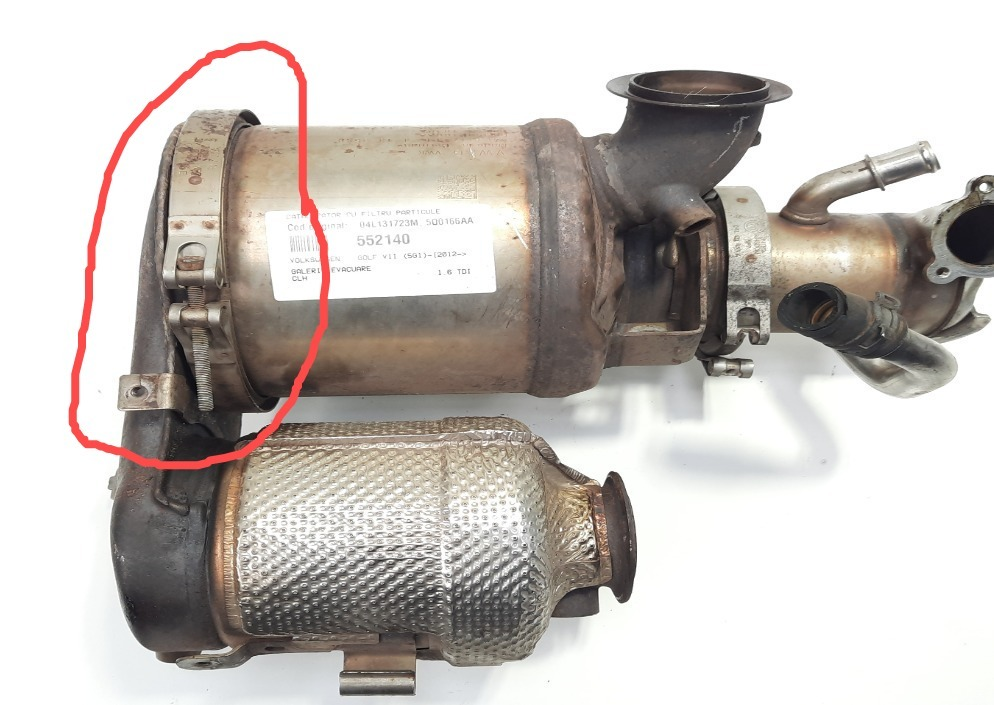

  3. It is not an engine out job. You need to move the steering rack out of the way. If the filter canister can be removed (it is clamped and not welded) you can find a replacement part for around 600euros. Otherwise it's around 2k. This would be a clamped DPF canister.

  5. The high oil consumption is definitely not a myth. Mine got from 1L / 2000km to 1L/600km. Had the piston rings changed this February and it got waaaay better. Still uses some, but it might be due to the fact they're not yet seated. Added like 500ml / 4500km. The consumption and fans running, is due to DPF regen being always on. If you drive more than 90 min without shutting down the engine, the DPF light will come on your dash. The limp mode can also be caused by the clogged DPS. This also used to happen to me, under heavy acceleration. If you are lucky enough to have a 'good' DPF part number, you can only replace the filter part, and not the whole assembly, why is way cheaper (https://www.autodoc24.ro/as/18989355 something like this, it is basically clamped and can be removed. Mine is welded in and it cannot be changed like this).
  6. What are you suspecting that might be the issue? The issue can range from faulty pressure / temperature sensors, to the DPF actually being clogged and needing a clean, or being melted/shattered and needing a total replacement.

  8. Is it possible to replace only the DPF canister part, from the after treatment system? From pictures it looks like it's hold in place by a clamp, and now welded in, thus making replacement possible. Does anyone have any experience with this?
