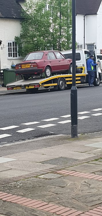

  8. Thanks. The car will be getting a full going over both in terms of cleaning and servicing . Reason I mentioned carb is that it just doesn't idle and moving it from the tow truck to my driveway it would randomly cut out under load, the exact same symptoms when I got my Fiat Panda which turned out to be muck in the carb blocking the idle jets. The grille with the fog lights is apparently an owner's club after market one. Not sure I like it so I will be looking for an original replacement Interesting point on the dash. The very late ones did get the more modern looking instrument binnacle from the Rapid. There is currently a blue G reg one for sale on Facebook which has this. Surprised mine has the older dash for a 1990 model but im actually pleased it does as I think it suits the car better and I like all the Czechoslovakia branding on the gauges

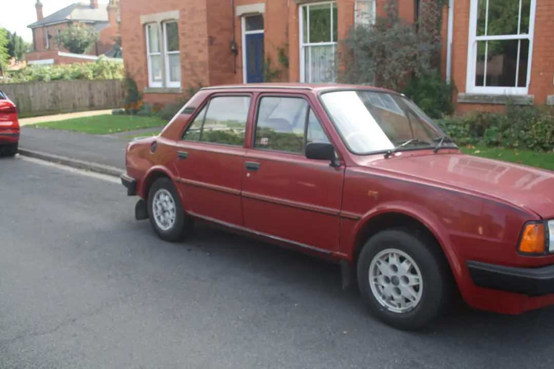

  9. well its finally here! looking a bit sorry for itself paint wise but I think it will clean up well. Minimal rust spotted so far. It runs like crap though so thats job number one. I think it's likely carb related given its not been driven for couple of years so maybe needs a clean and fresh fuel

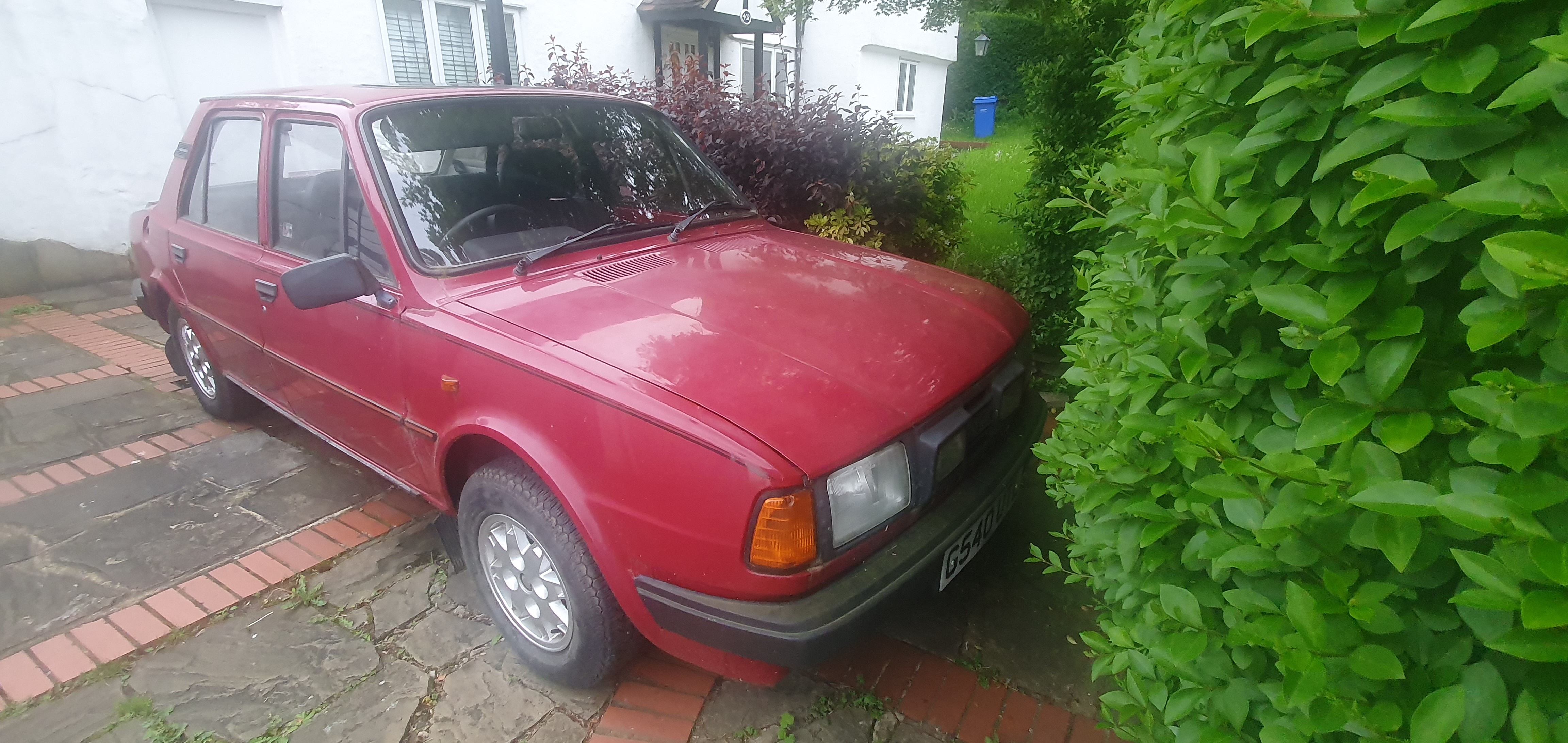

  10. thanks for the reply. I agree on ideally replacing the points but from what I had read previously there didn't seem to be too many options for full electronic ignition and at least the system I have on my Panda improves the life of the points and makes their condition less critical but agree full eleconic ignition is better as for the wheels, they have been professionally restored since the picture was taken. Thats an old picture the current owner had posted a while ago on Facebook. I haven't any of my own yet but will take some once I pick the car up. Not sure what rubber is on at the moment but thank you for your recommendations
