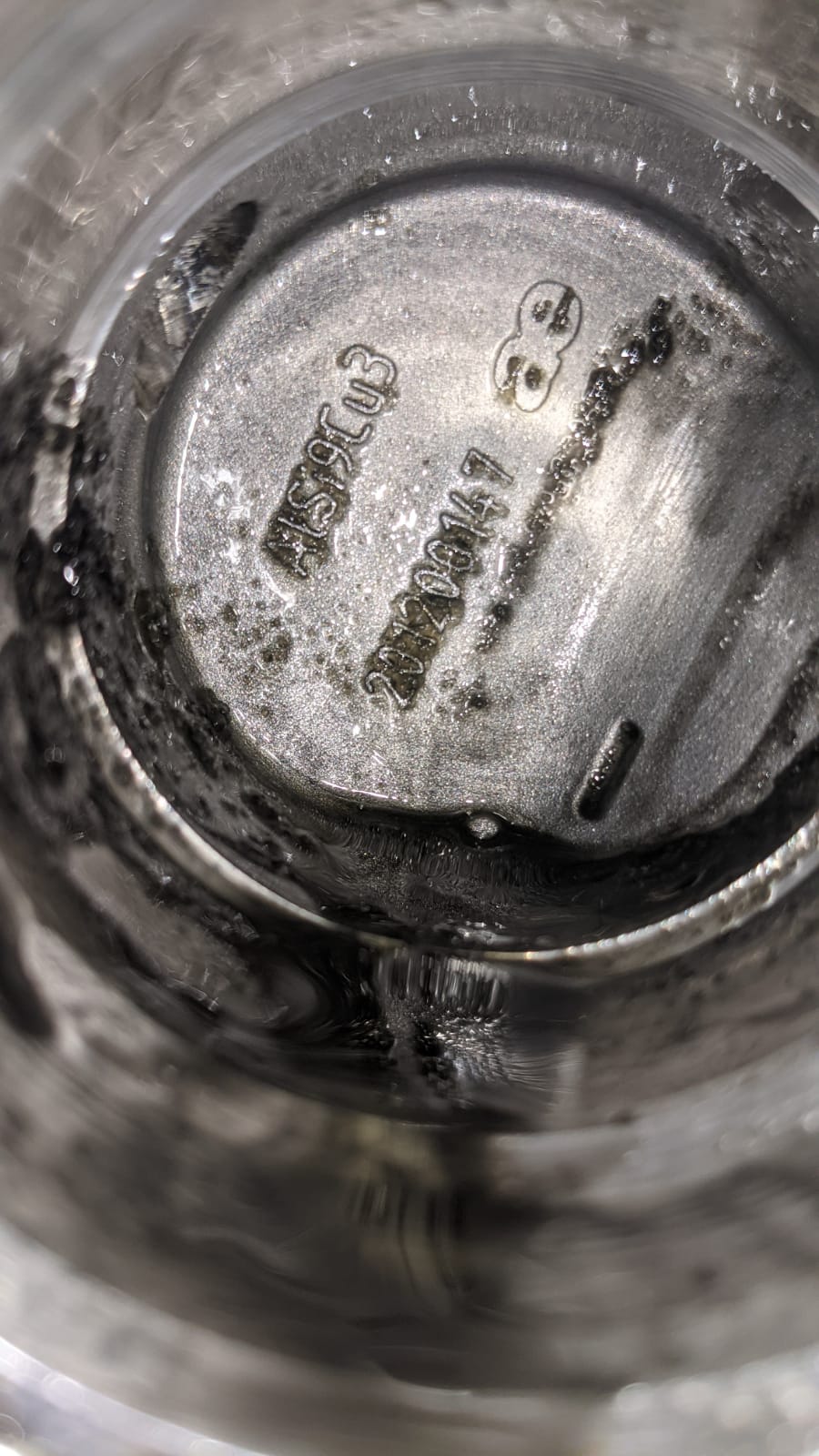

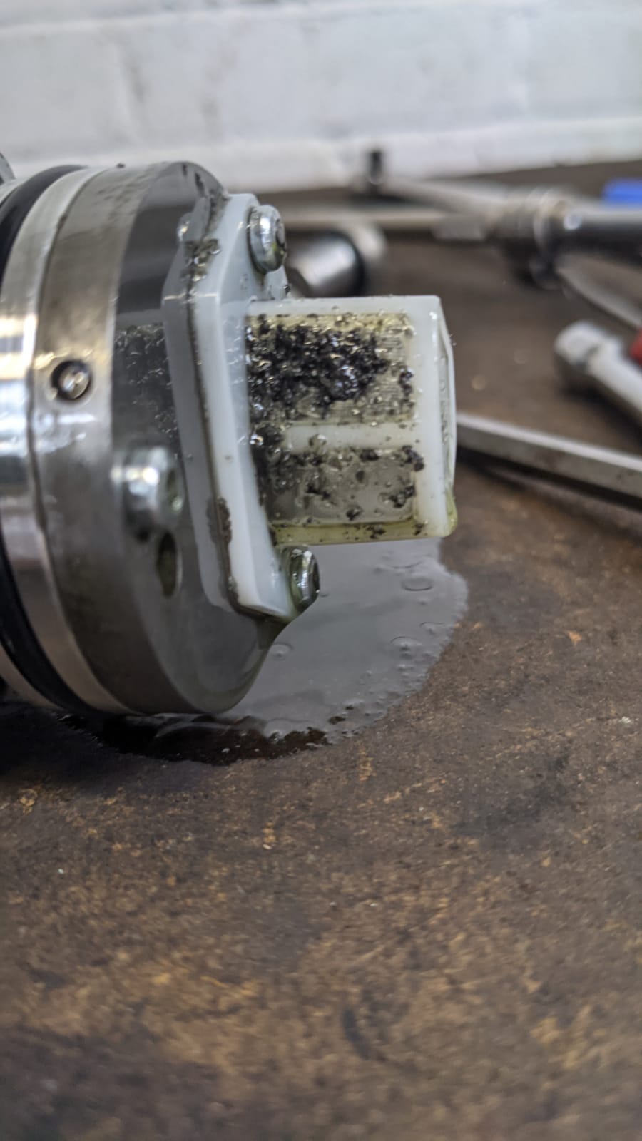

  7. Hiya guys, thought I'd just update you for those interested in getting there Haldex serviced. Although it wasn't too clogged up I imagine if you followed Skoda servicing and just got the oil changed you might end up with problems eventually. 2018 VRS 245 DSG at 24,000 Miles. I don't drive fast nor do I hoon it everywhere I go, but I do like to give it some every now and then. Never launched the car ever and I don't think I ever will. Hope this helps someone decide whether they want just the oil or the filter cleaned out as well
