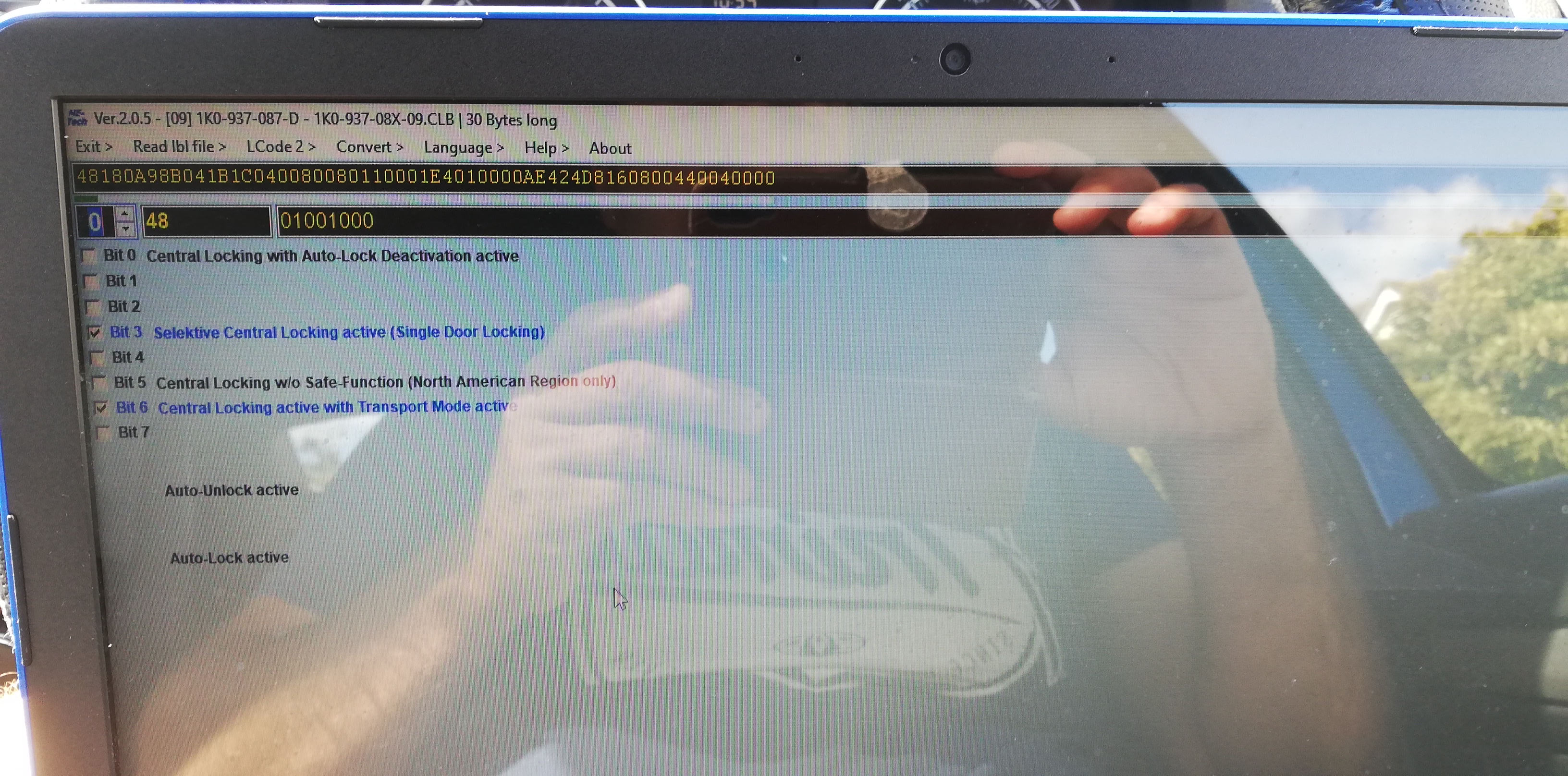

Remote window closing
Hi There very simple in the end yes byte 3 and toggle 5. All sorted windows going up and down. Thanks Maz
Aha that was what I was after on the how to guides posted around they show the bytes as black squares across the scree at three top. The version I have has a up and down toggle shown in your photo. That was what I was after. Ill familiarise myself with the newer layout and adjust as you have suggested. Will let you know how I get on. But yes the red circles explains how you get to the bytes and then tick untick. That's what I was after. Brilliant thankyou
Hi Langers, Thanks for your help. I will have a look at this. Is it true to say that all vrs level octys will have the facility to remotely operate windows.? Or as mine has next to no options no dot matrix for example that the option just isnt there..? How do you get to the bcm section.? Is that the button 09 and then click the black box 03 and the bit is the toggle that you tick..? Is this element risky.? Or fairly safe...? Again thanks for your help in this I've no idea how you have learnt how to this stuff. Thanks Again Maz
Oh OK thanks. I will get to it in the morning
Thanks Langers, I'll try and work it out tomorrow and let you know. Can you do any real damage doing this. Only I expected to drop into 09 and then flick a toggle and get the windows on the remote..? Is there a chance my car doesn't have that facility regardless of vcds..?
Phil would you know if all octavias regardless of dot matrix screen or not should have the remote. Closing option..? Thanks Maz
Thanks Phil I had a brief look in there but only saw 2 lines of info after pressing the long code button. Mine doesn't have the dot. matrix screen. Its maybe that it doesnt have the faciloty as it is a basic vrs model with no options on it. Thanks Maz
Hi All, Sorry if this is just a repeat of a well warn subject. I have a an octavia vrs and I would have thought that the windows would close when press and holding the remote. That said it doesn't have the multidot display and therefore assume no convenience pack. I note when I hold and turn the key in the drivers door the windows go up and down when turning left or right. I have just got vcds but it after 3 attempts cannot connect to no. 46 convenience pack. So just wondered is. It possible or is this car just not equipment with the option to remotely close/open windows..? Your help would be appreciated.
